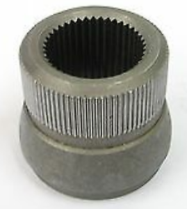

can be used ..all cars had the small spline column , later ones had an adaptor shoved on to make it big , if youve got the wrong combo remove or add the adaptor
Aha thanks. And then for aftermarket wheels there are alsof adapters that go onto the small spline?
both are avail....5 min job to pull the wheel off and have a look
