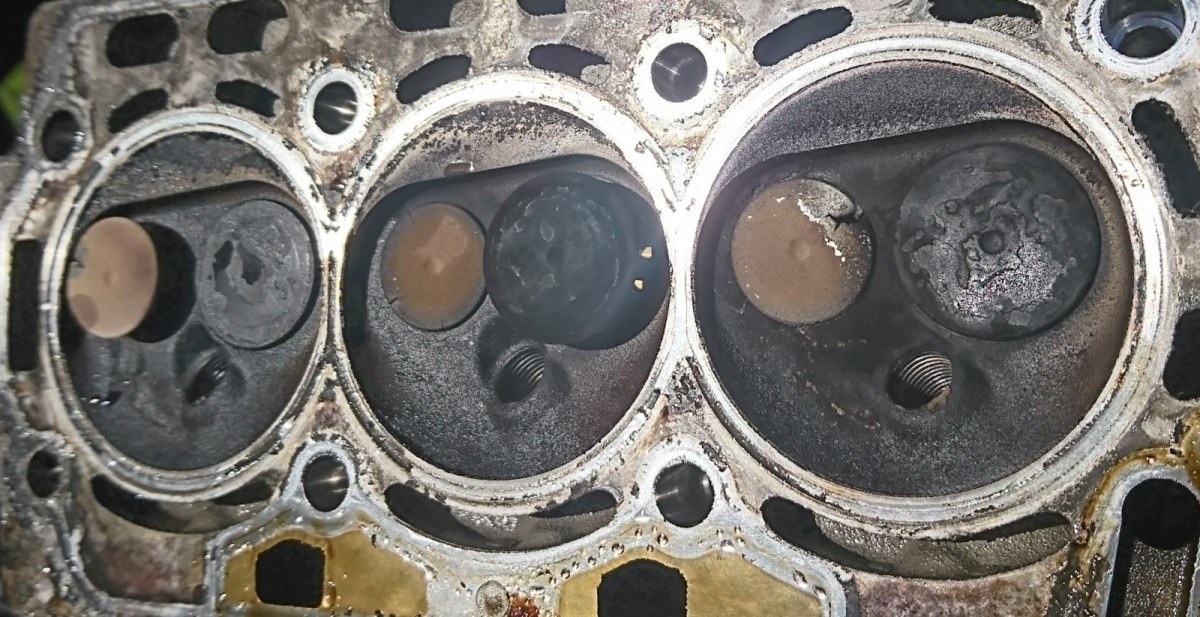

Here we go again! Lost whole lot when tried to make my pics smaller, so to cut to chase removed cylinder head, as you'll see burnt valves, what caused it? Common fault with 1.2 Cylinder MK7 engines? Been told supermarket fuel, servo had gone, result of timing chain stretch? Chain was changed and think was missfiring before... The final diagnosis was leak test.... Didn't seem to find prob when did compression test... Note bolts can seize and thread will either need re tapped or thread insert with special tools needed... Videos on you tube... I had 1.4 polo 2001 plate, never had this problem.. This polo done over 100k, been told frequent oil changes important too as its timing chain.. Every 5k? I'm curious others out there what experience you've had with this MK7... Mechanic still rebuilding, took most of day to break... Any idea how long it should take to break and rebuild? Was quoted £300 for labour from another mechanic... Recon was £340....

Supermarket fuel will not be the problem.  Approximately half of all petrol sold in the UK comes out of pumps at supermarkets, so this problem would be far more common if that were the cause. It'
No way of knowing when the damage happened, or started to happen really. Just make sure it gets regular oil/filter changes from now on.  I personally do the missus's Fabia (12-valve 1.2) twice a year,
I had oil change last year... Not doing that many miles as you know... Filter too and sparks... Thanks for all your advise Pete!
It's not clear to me what you mean by 'servo had gone'? There's a common fault with failure of the vacuum hose to the brake servo, but that's not a fault with the servo itself.
How often was the oil and filter getting changed on this car? Which oil was being used?
Have you had any fault lights on?
Does the radiator fan work? Does the temperature gauge ever go above 90°C? Does it use/lose any coolant?
Make sure your garage checks the degree of wear to the exhaust valve guides. These are often mentioned as being the precursor to this failure,  too much waggle-room and the exhaust valves don't seal properly, leading to overheating due to poor conduction path into the head metalwork. What wears the valve guides excessively is another (or possibly the main) question, of course.

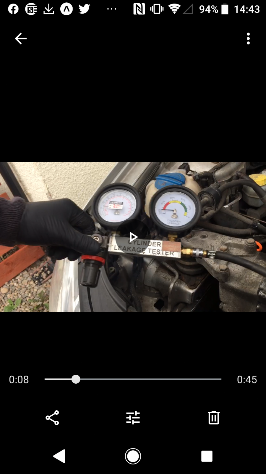

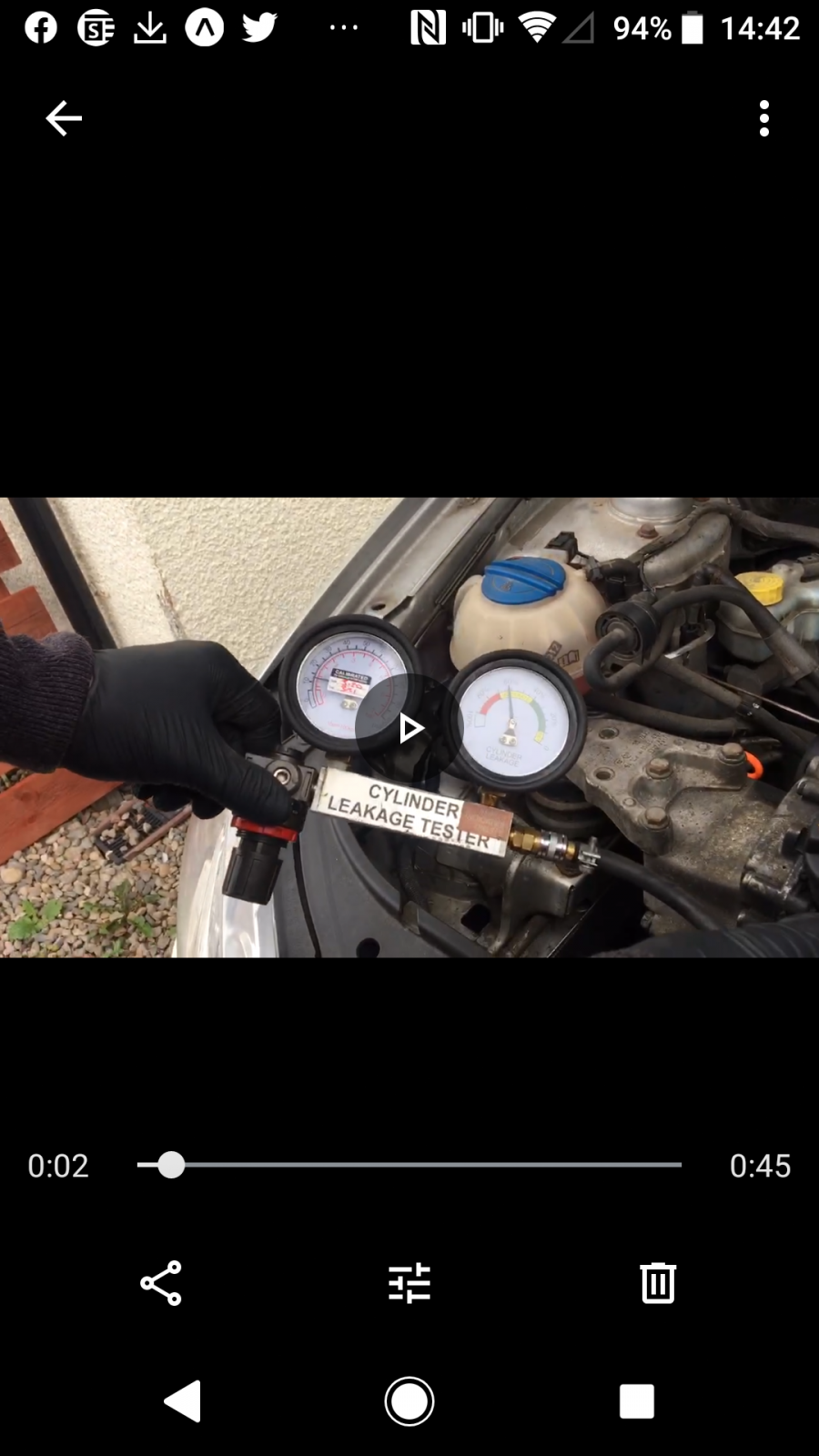

No idea about sparks tubes.... Compression figures too... Got a video of leak test...
Link to post
Share on other sites
j.hilmar.christens
2 hours ago, Pete1 said:
As long as the little cardboard tubes have been in position to protect the plugs from end-impact between factory and your engine, I tend to agree.
What were the compression figures?
Here's leak test... Before and after, need to zoom in... Obviously you can see its only in yellow bit then drops to red... They put a rubber glove ond of exhaust... How would they know exhaust valve was closed?
Link to post
Thought I'd give update, Pete has been great as you'll see with his excellent advise, but need to pick his brain again...
Got the car back... £400 labour bill! This was break down and rebuild... Mechanic also retapped the engine head for the cylinder head bolts... Few issues still, now missfire moved from cylinder 1 to 3...going to check injectors... Cam shaft sensor went on again... We think faulty... Its new sensor... Cam timing was checked and all OK... The cat full of stuff, did not know can drill to clear it out... So that's about it.. The total damage for recon and labour £740!

It is important to remember that the only time that an exhaust valve is cooled, is when it is clamped to its seat in the first three parts of the cycle.
The problem is that, if the actual contact area of the valve and seat is too narrow, very little cooling takes place BUT if the contact area is too wide, then there clamping load from the valve spring is shared out over that wide area, resulting in low contact pressure, in turn resulting in poor seating.
I would suggest that you ask your local machine shop to carry out a 'three angle grind' on those exhaust valve seats, the final angle determining the the contact area.
Other causes of this kind of problem include: Wrong spark plugs; Weak mixture (a richer mixture has a cooling effect); Wrong valve timing.
Frequent oil and filter changes can (amongst other things) improve the action of the hydraulic tappets - but only if the recommended grade of oil is used.
The argument about supermarket petrol will go on for ever, personally, I always use Shell V Power. - I know of people who have tried that and claimed that they couldn't tell any difference - well, they wouldn't would they - First of all, the V Power will be diluted by whatever else is in the tank, secondly V Power has a cleaning effect in the combustion chambers, but for this to happen, you may need to use it for a while.
What I have found with V Power, is that I obtain better fuel consumption, but as always, this depends on how you drive. The engine is definitely smoother running though.
