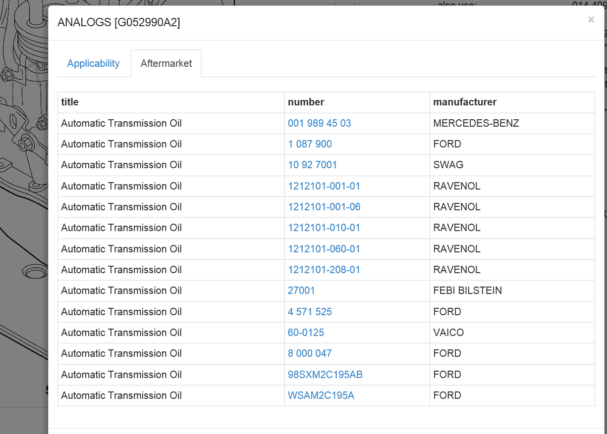

There's a button over in the rightmost column of that page I linked, with aftermarket equivalents. Here's a screenshot of what comes up for G 052990A2:
I was looking at the Febi 27001 planning to buy it on Ebay or Amazon but when I search I only found 1 qt on Amazon and on Ebay when you go in the details the number on the bottles are  the 29934, so was wondering if it was a substitute.
Dunno; you'd have to ask Febi, somehow.
