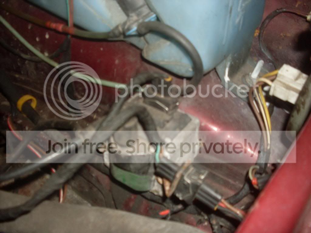

Ok, I've made a start on the wiring in the engine bay, I have the connector near the coil with three wires, Black, Green & Brown, three pin plug. I cant find anything that it plugs into? Any ideas?
From that link I copied in my earlier post it tells you to do this;
"The 3 pin plug with the brown, green and black wires(was near the coil on the Mk.3)
Black wire connects to the black wire that used to connect to the + terminal of the coil on the Mk.1
The green wire connects to the red/black wire that used to connect to the - terminal of the Mk.1 coil
The brown wire connects directly to the battery earth terminal and must not be earthed through the bodywork"
I have done this, but cant see where it is meant to go.....

connect it up as per your post....thats the chappy in the picture on that little bracket
So just use the mk2f light loom so it has something to connect into?
you have the g40 connector for the coil yes?
brown,...put an eyelet on it and connect to the mounting bolt /any earth
black...join to black from orig car , test that its ign live
red /black ...goes to rev counter

Yeah, I’ve done that but to the male connector as per the photo in the link I added. The female connector for the coil hasn’t been modified at all and is plugged into the coil. Should I have chopped and joined the female plug not the male?
chop it where you like ...as long as that coil plug see's earth & ign live it will run

yeah that plug is confusing ...i think its just so you can pull the looms seperatly
Just looking at the coil plug wires now, looks like they’ve been badly cut and joined to something in
the past. The engine was in a Coupe S before, but it had a full G40 loom and clocks fitted. Struggling here!
yeah id guess last owner had the same struggle
how nice do you want it , you can buy all the pins and coloured wire , make a nice repair of it?   funnily been working on the same section on my 3f today
that big lump of browns joined is probably factory lol...they did that !!
So can I just lop off all those brown wires and do the cut and joins like you suggested and be ok? What are those brown wires lol?
im not too fussed on how tidy it is right now, I would like to get it up and running and then worry about making it look nice.
