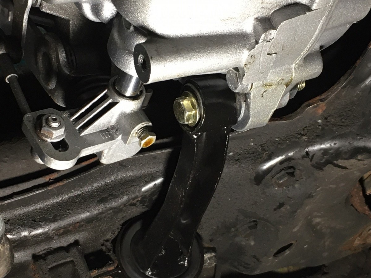

POLO 6N transmission selector seal
I have undone the small bolt that goes through the shaft. (oil on end of bolt on the pic)
I have tried to pull the silver casing back but it keeps hold of the shaft. I don't want to hold the shaft with grips to avoid scratching shaft.
It's as if the casing is only going back as far as it can.
Am I supposed to also undo the nut and bolt to the left of the shaft bolt. Thanks lads.
