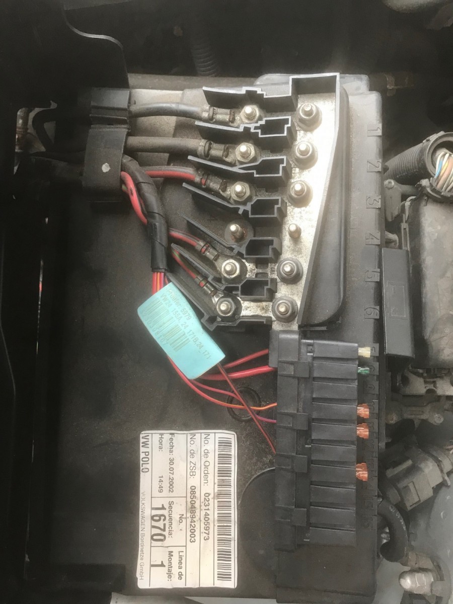

  • The odd-looking fuse in location 6 may be a 'ghetto' repair involving a thin sheet of metal, by the looks of it (or maybe a 175A fuse?).  That doesn't look like it'll do a particularly good job of pro
Does the battery symbol in the instrument cluster light up when you turn the ignition on (before extinguishing again once the engine is started)?

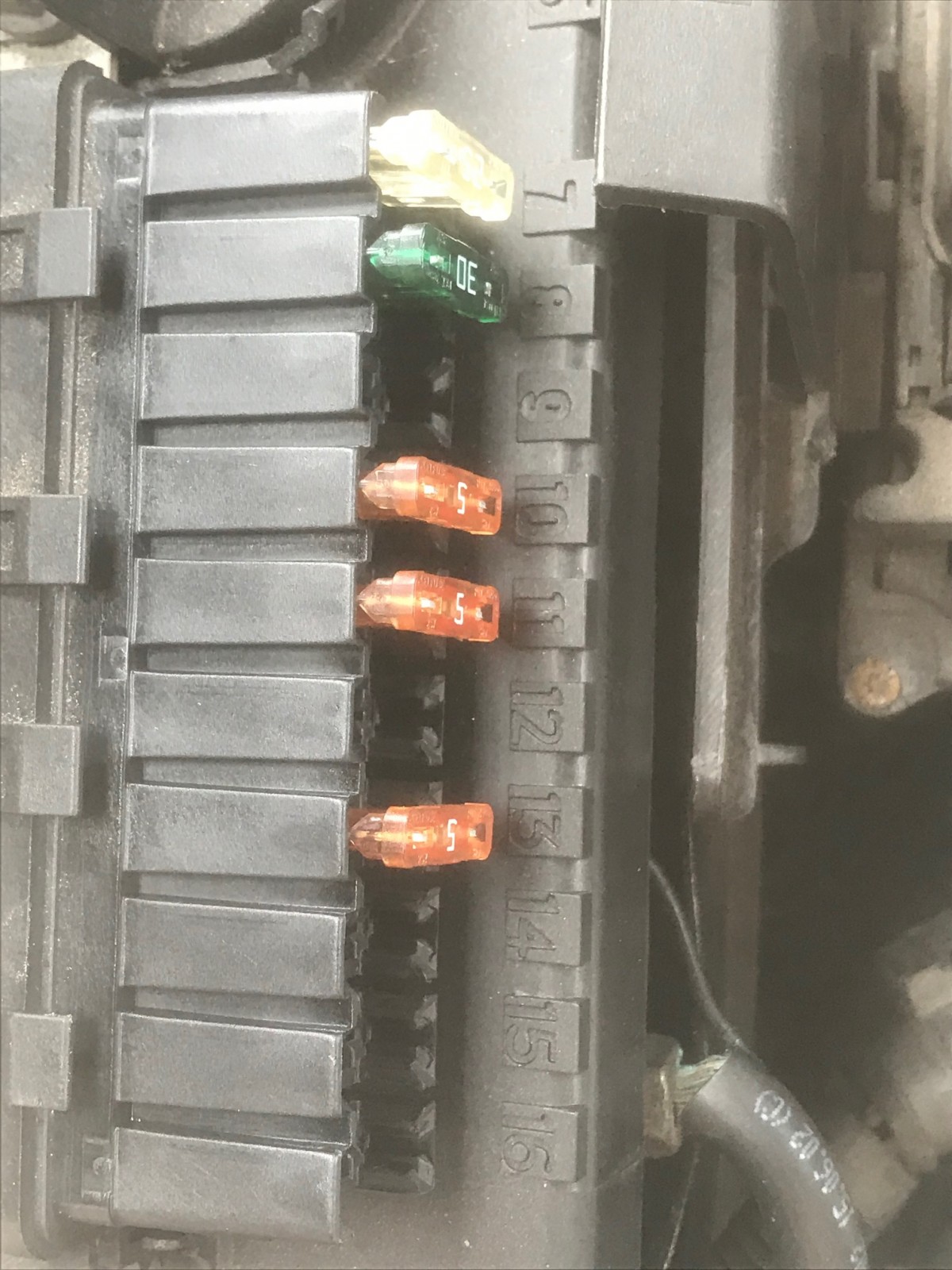

Ok, if you can post a photo of the battery-top fusebox, I could annotate it with the function of each fuse for you.
Thanks very much .
See if this makes sense:

Re fuse 13 , that is just part of the plastic moulding below .The high current fuse on terminal 6 , I will see if there's anything written .

That odd fuse in the position for the ABS pump has some writing on it - you can just see it in the photos above , looks like 150 , so maybe someone changed it ? I will go to Halfords and get a pack of these fuses and put in a 40A one .
