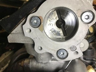

The concern I have is with removal of the dizzy; I have had a custom blank made which seals against the cylinder head however it seems the dizzy was holding the cam in place and stoping it from floating, now the dizzy is gone the cam can move around a bit and I’m worried it might throw the belt. For now we  have just bolted the dizzy back on ... wondered if anyone had done anything similar and what if anything you did to keep the cam firmly in place???

Thanks for the comments; You can see it here with the dizzy removed and the factory end plate in place, with out the distributor the cam has rubbed the backside of the end plate do it must be moving a bit...
Ouch.
Ask Feld? It is their camshaft from the FM316 scribing (or their regrind of stock / someone else's).

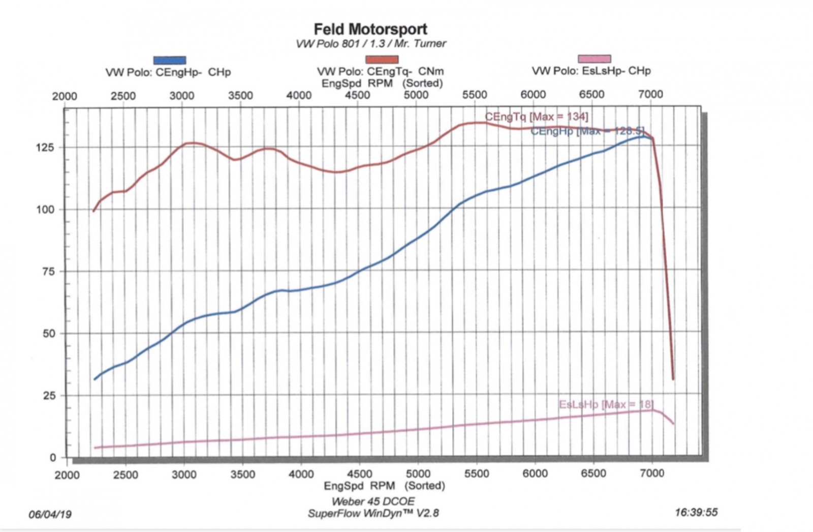

Yeah I might try him again see if I can explain the issue... the dude is a genius but hard to communicate with as I don’t speak German and his English (although better than my German) isn’t great . He dyno’d it with a DTA fast I/O set up but using a distributor setup
yeh the cam is 316deg, the full spec is below, it’s a bit naughty:

I think your suggestion of refitting the dizzy and blanking the cap is probably the way I'll have to go, problem is it sticks out quite a bit and spoils the look a bit, i'll check out the seat unit.

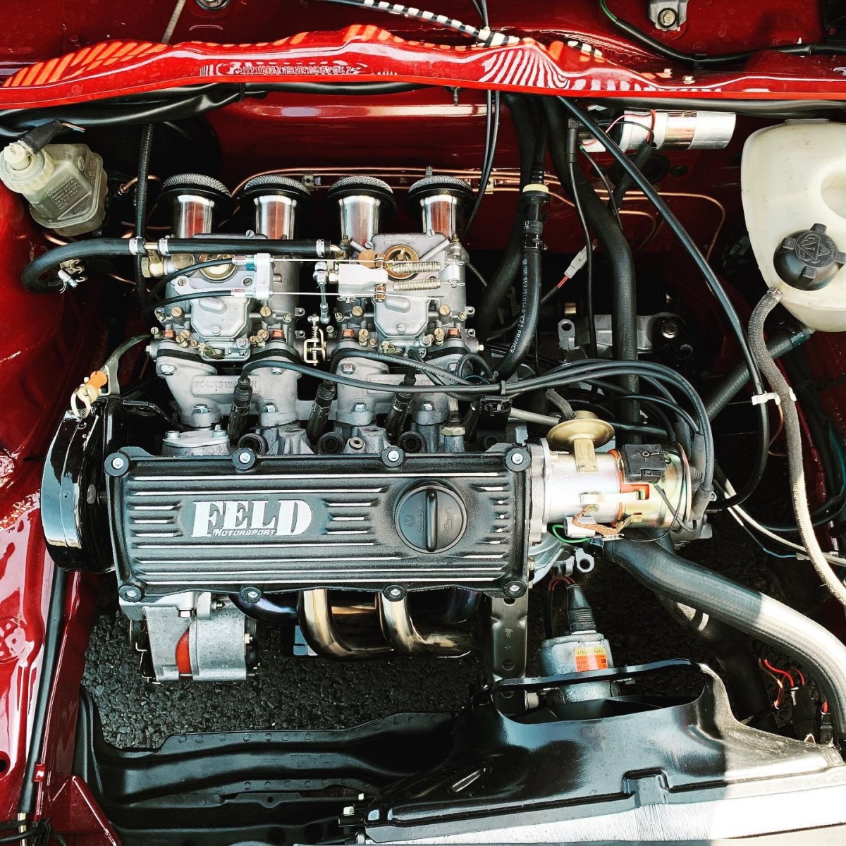

What is that black thing on the distributor cap metal interference shield with a wire coming out?
I think from memory there was two devices attached to the dizzy, one was a voltage regulator and the other is a damper to prevent interference with the radio! The black widget is the regulator I believe
