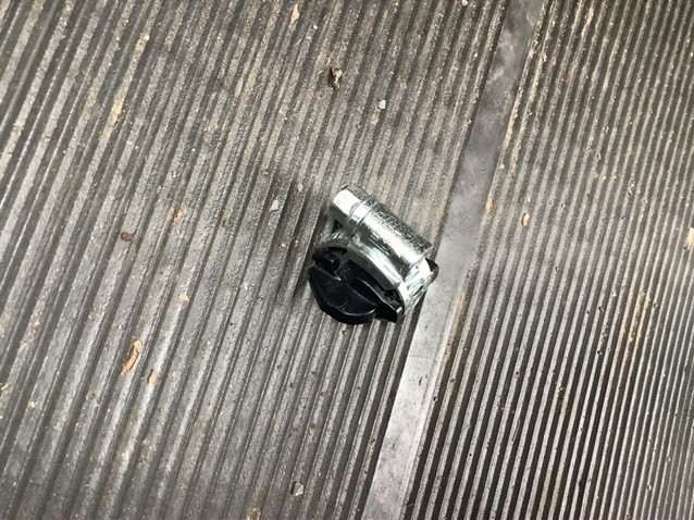

Right, sort of fixed it...good enough for my purposes anyway. Having taken the fascia off there were obvious signs of previous bodgery - missing screws, cable ties etc. and the cable itself (green as it happens) was found to be loose. The plastic at the back of the controls must have broken previously - someone had attempted a repair with a jubilee clip.
I've re-routed the cable so that it can be adjusted manually from inside the cabin.
