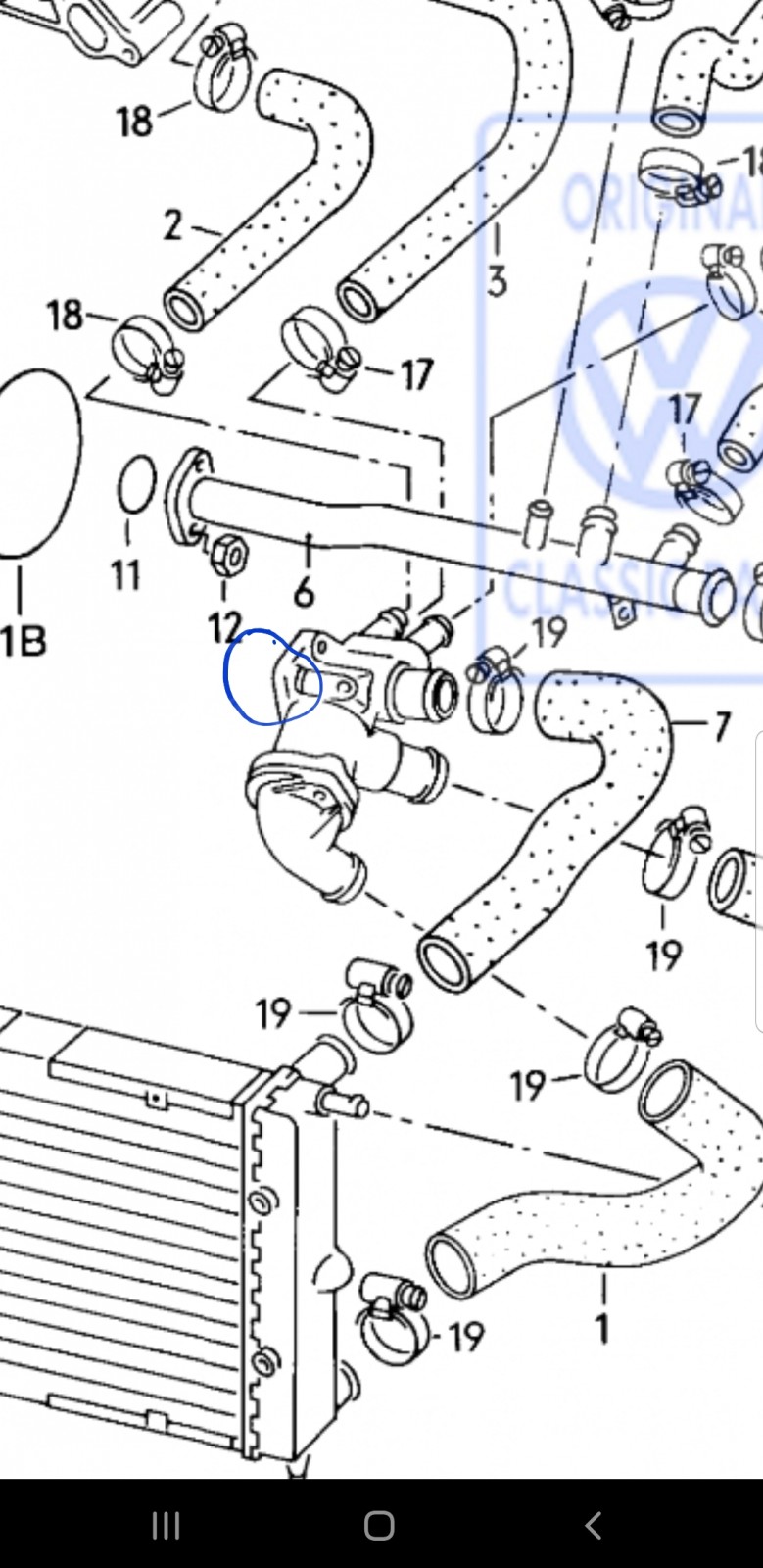

Screenshot_20200707-182355_Gallery.thumb.jpg.18219baebc88cc28a705e2157f4de91f.jpgI've attached an image of the system, the blue circle is where its leaking from.

which year ?
engine code or size ?
Plastic or metal housing to block?
If plastic you might find the housing has a split from over tightening.
My metal housing has a flat gasket to block I reckon.
The thermostat valve itself is in the bent elbow shaped cover below your blue circle that one of the 4 jubilee clips number 19 attaches to from radiator bottom outlet and has its own o-ring. (also different sizes).

very very common for that plastic housing to have a crack in it , if i was taking it apart i would fit a new one regardless
can get one for 10-15 with the seals
Thanks for responding guys, its a 1043cc with a plastic housing. I'll getting something order and hopefully fit it over the weekend, I've seen one in stock at a local shop.
