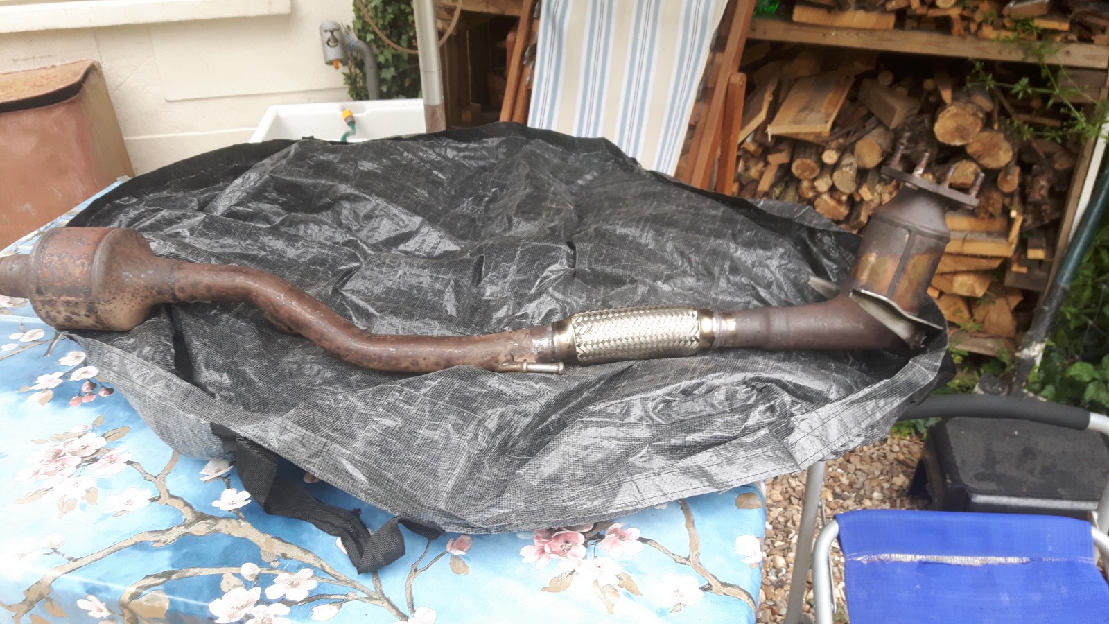

That's a shame, 'cos the original cats were probably OK, and a welded new flexi would probably have been cheaper than any aftermarket replacement pipe.
I had this done on my 9N3 a few weeks back, tenner or so for the flexi, and thirty-odd to the welding company.  Making sure the alignment was spot on was very tricky though, with all the bends and kinks it's critical.
