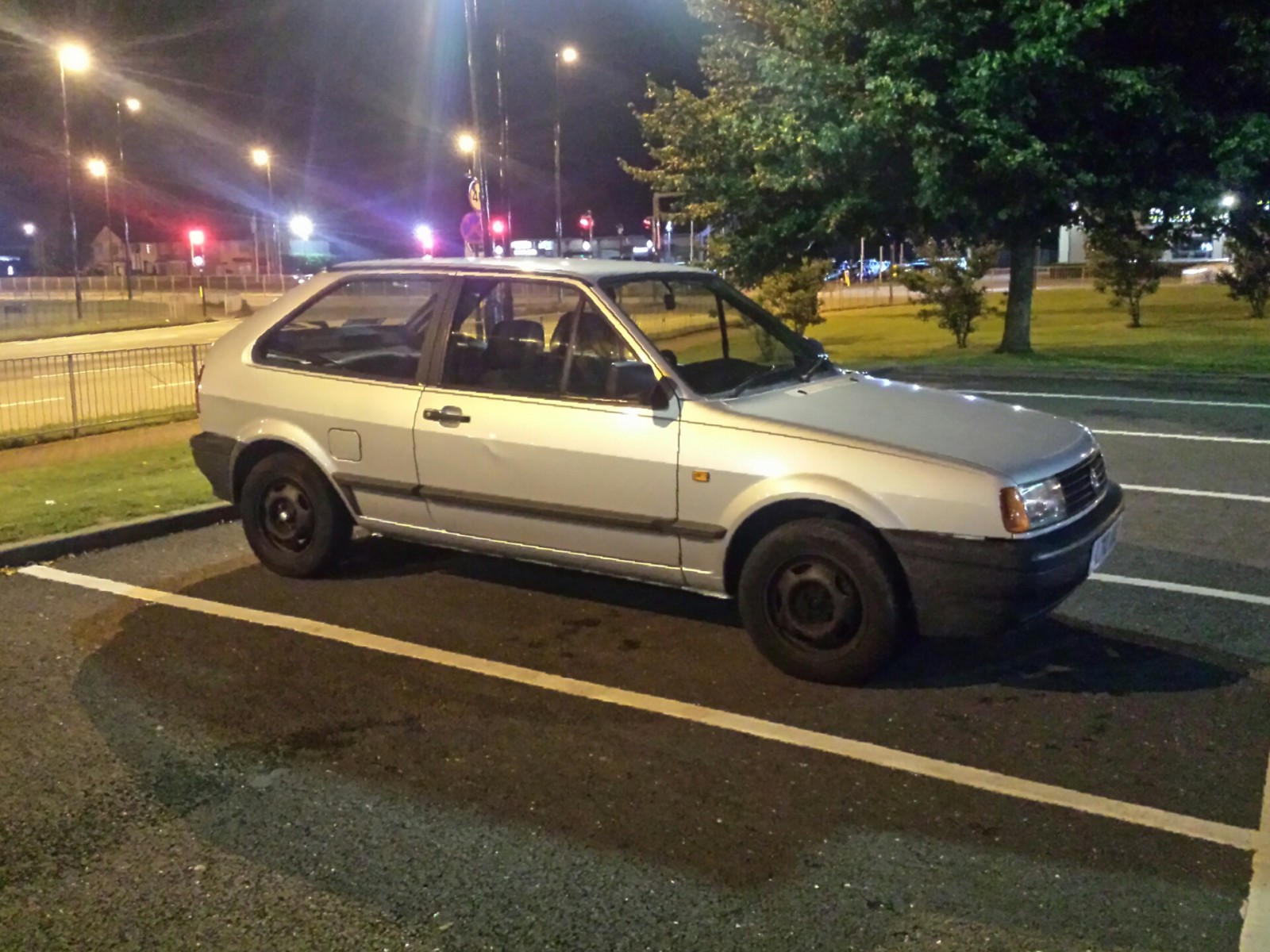

Hi guys,
I got my lovely 93 Coupe a year ago, it ran great until May, it's my daily driver and have done over 4k in it but now it's being a bit of a diva and I can't figure out what's wrong.
The main issue is that it won't always fire (it's turning over), it's intermittent, it'll be fine for days then play up, then if I leave it for 30mins it might start (or not).
I replaced the dizzy cap, rotor arm, plugs, ht leads, none of which sorted it so it's had a new coil, which seemed to fix it, but after three days I was leaving work and at the first point the revs dropped (was stopped at a junction) the engine died. I got it started again, but I'm pretty certain the lights flickered (was on a late shift and knackered), and it over revved briefly. About a minute later I had a loss of power but managed to keep it running and the rest of the way home it was okay.
My mate checked it and when it doesn't want to start I'm not getting a spark.
Does anyone know what it might be and how to fix it?
Cheers,
Heather.
