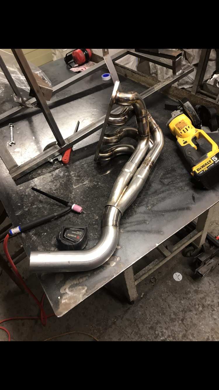

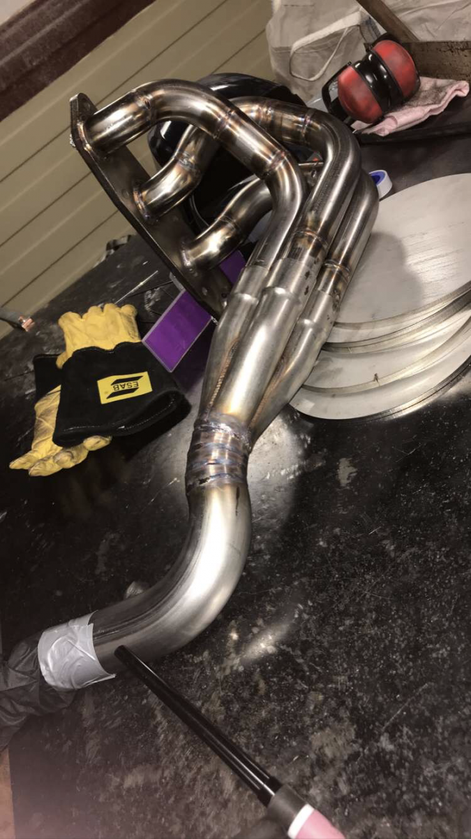

Hi, this is my first post on the forum and thought I’d share some pictures of the 4-1 manifold Ive built for my 2F breadvan
38mm primary’s into a 4-1 merge collector with a 2” exit it’s all made of 304 stainless steel and back purged TIG welded.
