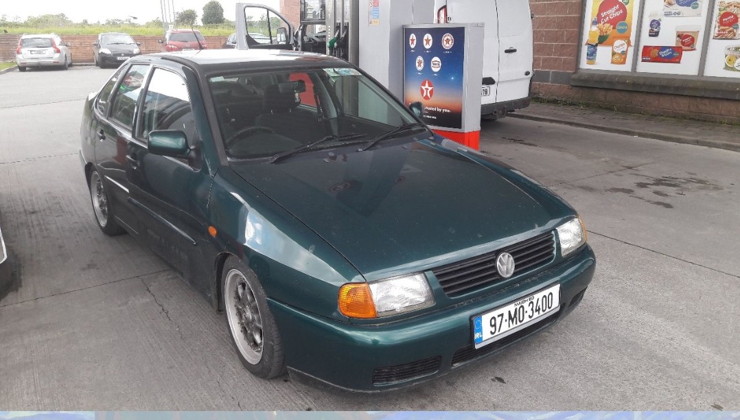

Hi .
My 1997 mk 4 1.4 saloon failed the not Mot on exhaust imusions . Mechanic says there's an internal oil leak . There no heavy smoke the car is running perfect .
So can anyone advise me what to do . ie. get an engine rebuild and try fix the issue or get a replacement engine . I love the car and would hate to part with it .
Thanks Gerry..
