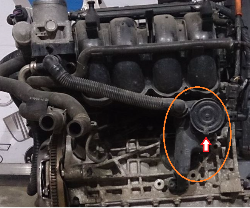

Could be worth your while finding and putting a finger over the PCV pressure equalising port (while engine is idling, fully warmed up), as a way of detecting leakage there.  If it is leaking, blocking that with a finger will have dramatic results, if not it won't.  Careful of aux belt.
Should be something like this, where the arrow points, I think:

Apart from access, which is a little awkward, it really is a very quick and easy test to do. But as I said, make sure you keep hand/arm away from the auxiliary belt as you reach round to find the port.  Practice finding it by feel with the engine off, work out how/where you can reach to get to it without risk, then have a go with engine running.
It's a bit of a long shot that this would affect just one cylinder, but it is probably the case that cylinder 3 runs hottest on a four-cylinder due to location of coolant pump and the fact that the end cylinders have more head surface area so can radiate/conduct heat to the air better than the middle two, in addition to liquid cooling.
