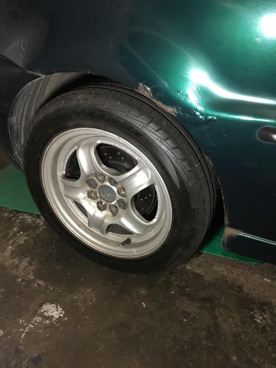

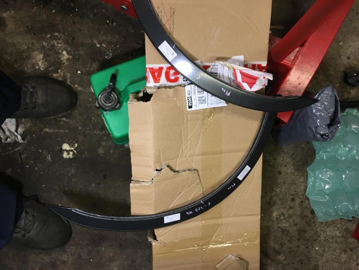

I've bought some after market plastic arch trim as on these polo's theres a lot of rust on the rear arch.
If I remove the rust and get it to steel from the outside, do I have to remove the rust from the inside?
Would this mean there is no option but to cut out the rust and re-weld another arch in?
Where would I get these arches from, although i'd rather find a easier option. Thanks

You'll really need to take that back to bare metal to see how bad it is. If the inner arch is still solid and you're going to use those trims you've bought, you could botch the outer with rust converter a bit of filler and then paint it to seal the 'repair. If hidden behind the trim it'll last for a couple of years if you do it well.
However...  We all know that to fix it properly you're looking at welding in new metal.

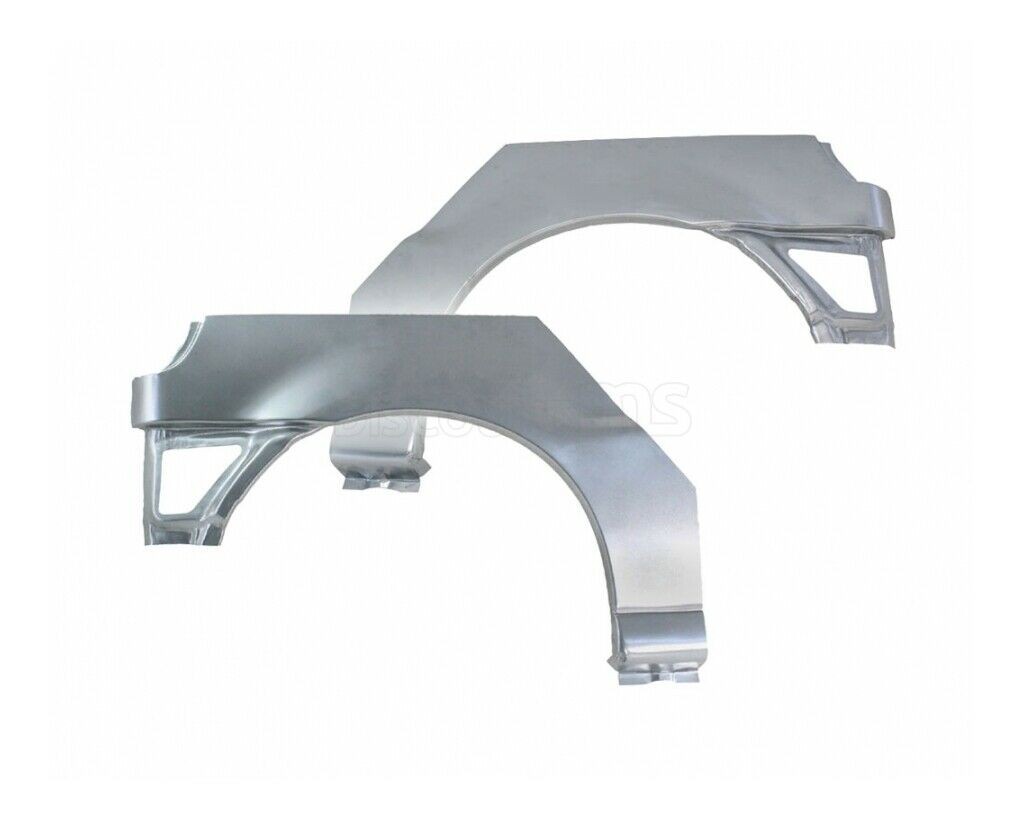

i have purchased the rear arch repair panels from germany. got both sides for approx £75 which isn't to bad. 🙂
Really looking forward to having it restored 🙂 the MOT lads said it looks pretty good from under the car.
Also purchased;
Right so , use the new arch as template , draw line. Use an angle grinder and cut on underside of line . Put new plate in place and make sure it all lines up then weld it all the way along the seem. Leave 0.2mm gap??? Smoothen off weld . Simple as that ??

Other possibility is an edge joggler, for an overlapped joint; basically presses a step in each sheet for strong flat joint, so the transition is smooth-ish. You can fix in place with self tapping screws and get the alignment right and spot weld or seam weld (or both) and then grind.
You don’t have to use the full repair panel if it’s not needed - you can cut it down to whatever size is convenient, or covers the rust damage you have.
The main thing is to make sure you get all the rust cut out of the original and leave a good, solid, clean edge to weld to. I’ve never used one of the Kel-arc guns, but seem to remember them getting a decent write-up back in the day!
Heat is your enemy here. It’s important to tack the repair panel on rather than jumping in and laying down a long line of weld. As it cools the panel will warp in that case.
By jumping about laying tacks you can keep the heat down and get the repair held securely in place. You then go back and fill in between the tack welds - a bit on one end then a bit the other end etc.
A joddled edge join can also help here. Well described above as putting a step in the panel - it’s to allow an overlap between the two. This means you could screw or rivet the old and new panels, holding them securely together, but would also help dissipate the heat at the join.
