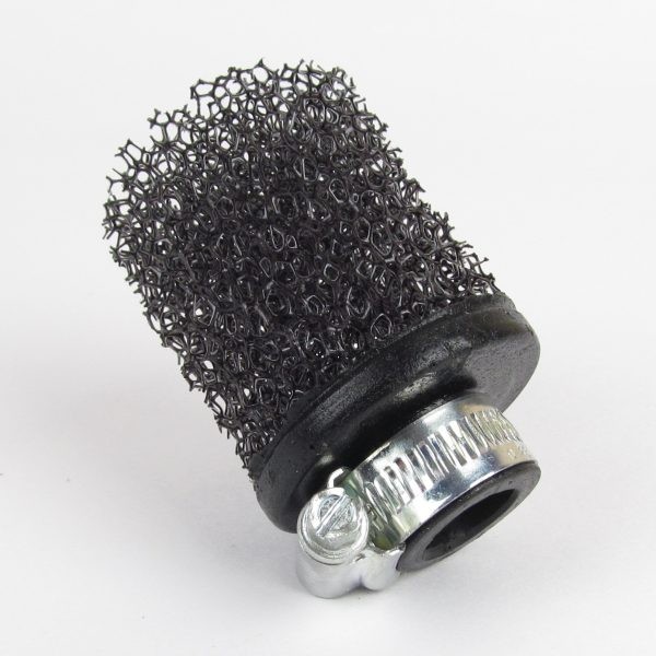

dont use catch can.  oil should not be coming out. Use a ram air filter like this one.
it allows better breathing out from crankcase. you will notice some smoke while engine is warming up, thats the condesation. soons as engine warmed up and running for a while you will notice the smoking is gone.

A catch can of some sort will stop it going on the road; that filter will not. Routing it back into the intake properly will save any need for making or buying anything.
i was more concerned about his engine more so than the road which is wrong i admit. sorry
