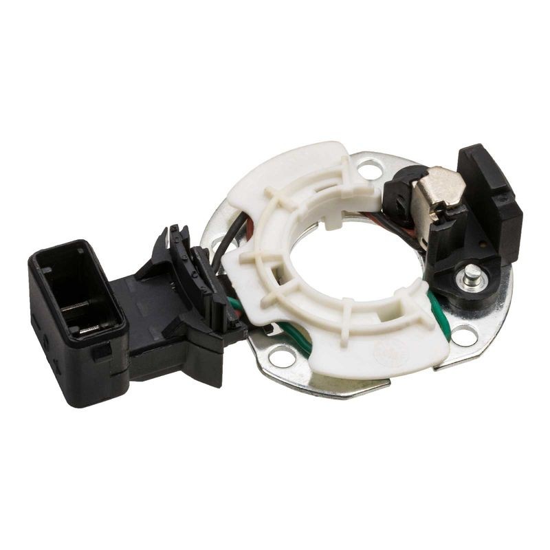

Amazing thank you so much! The hall send is the part bellow correct?
yes thats a hall sender ..have a look on autodoc.com , they list a few and the part numbers , can then try the part  numbers in ebay etc

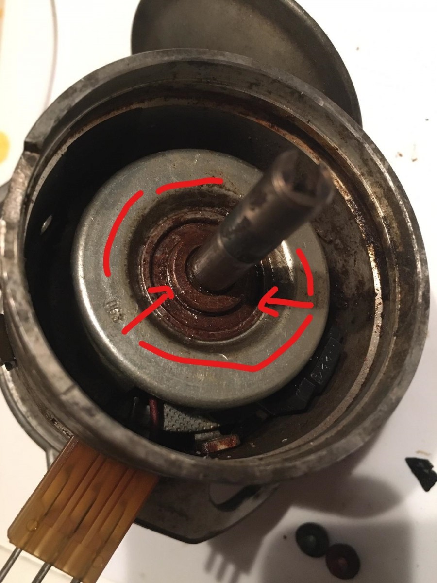

I'm trying to take the ignition coil apart but I cannot seem to remove the round "rotor" which I've marked up in red on the photo. I can lift it upward slightly using a screw driver by prying upwards where the two arrows are but it won't go any further. I need to remove it to change the hall sender... any ideas?

there may be a securing roll pin through the other end of the shaft in the distributor which has to be knocked out with a punch.
and replaced with a new pin.
I have an older distributor with hall sender and no vacuum unit so I'm not 100% certain
https://www.howacarworks.com/ignition-system/overhauling-a-bosch-distributor

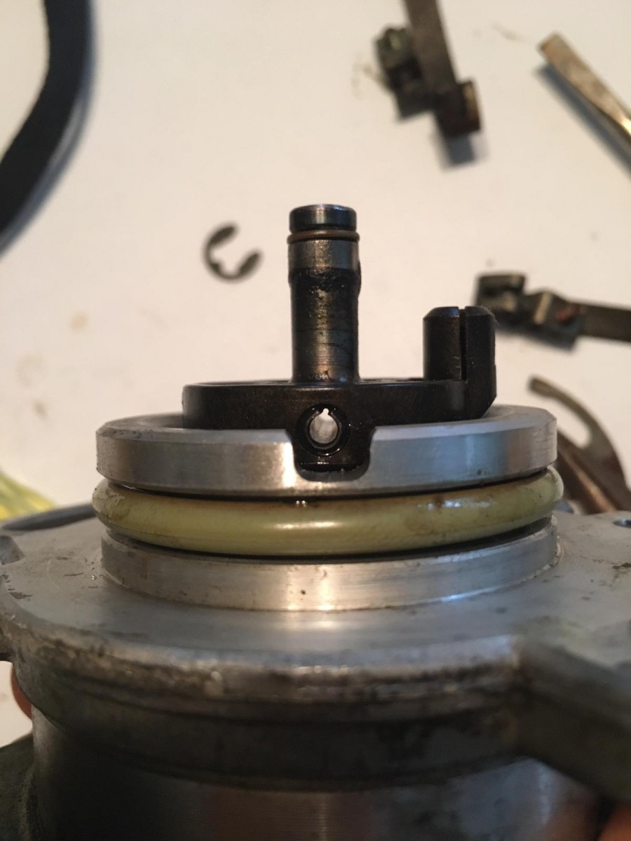

Yes there is a pin at the other end. I was hoping I wouldn't need to remove it. The odd thing is that the "rotor" moves up a little but not all the way up...

That's the roll pin.
I watched an old mechanic change one at Lucas Electrical UK
Drive it out with a punch or rod of same diameter. Push a chisel in the lengthwise when removed and you may be able to reuse it.

I managed to get the pin out using the bottom of a drill bit with the correct diameter as a punch. Once apart though there's another circlip under the "rotor" which is really hard to access so you really need the right circlip pliers. Ordered some on Amazon although kind of annoying to buy some just to remove one circlip (so I'll probably just send them back after use 😜)

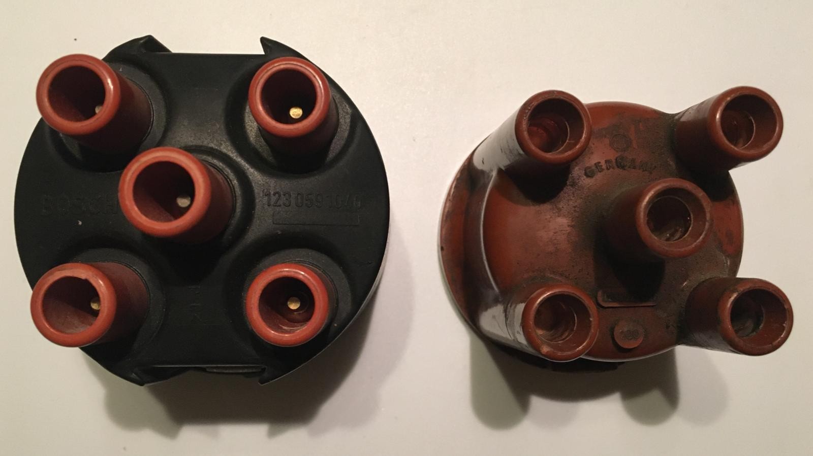

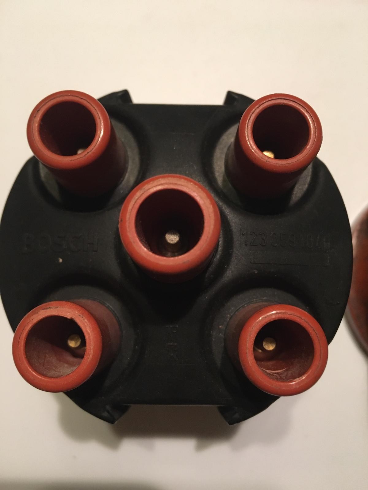

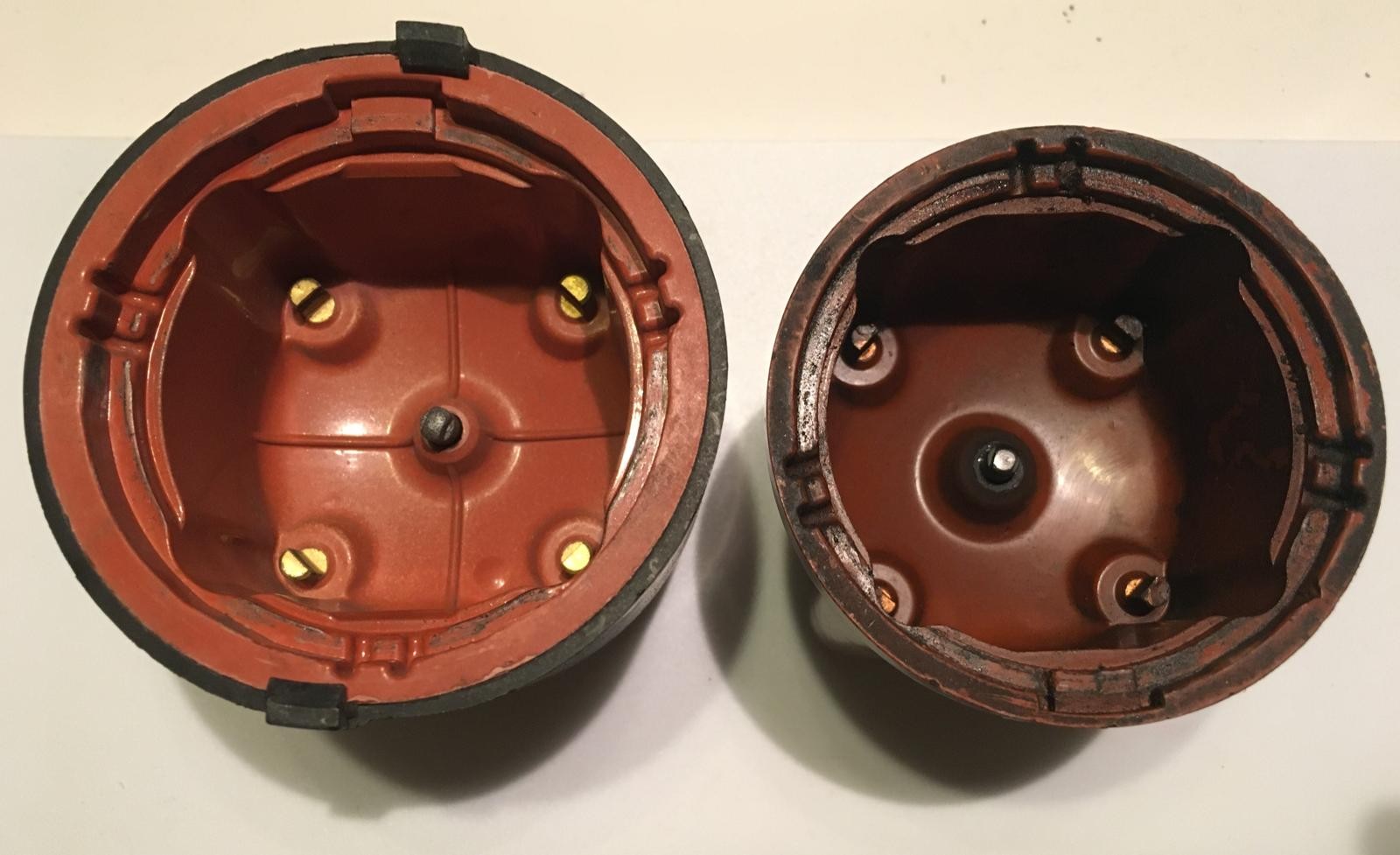

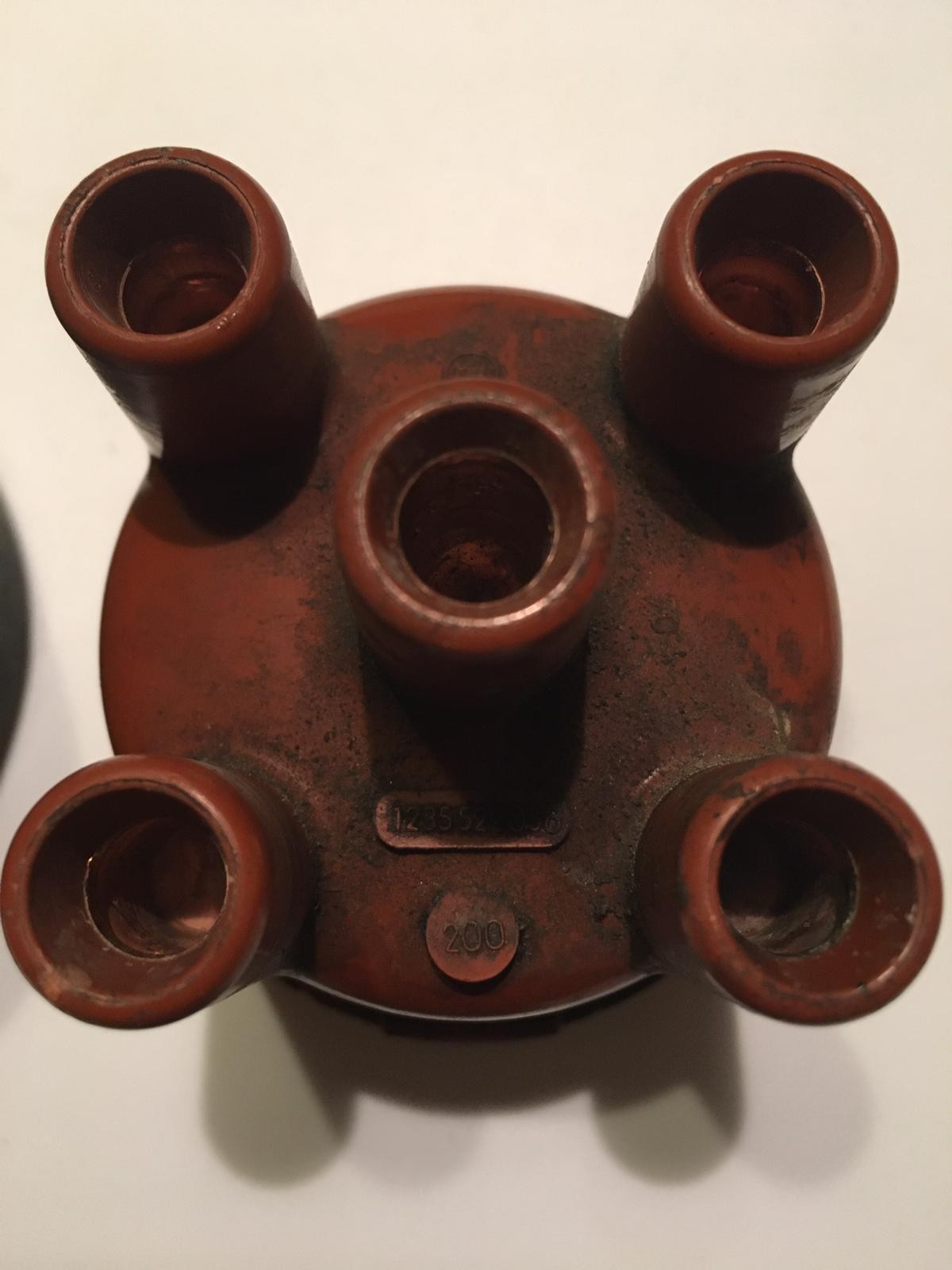

Also below the distributor cap (left - black) which was supplied with the used distributor I got on ebay is different to the original distributor cap (right - red). We had to use the original cap as the plug wires don't fit the "new" black distributor cap. On the inside the appear to be the same but we're wondering if this could be the issue? Also we were using the new rotor with the old cap so that might be the cause? I will try the old cap with the old rotor tomorrow as I had left the old rotor at home but any pointers would help. Finally we could order new plug wires for the new black cap.

thats early vs later cap ...any mechanic should spot this
