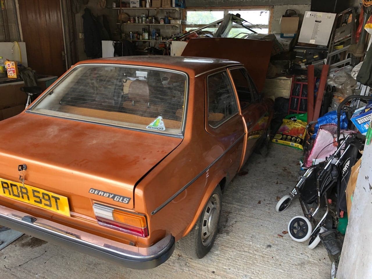

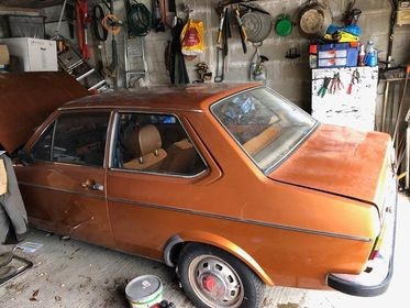

Hello Peeps,
I have been hiding around this forum for some years now!  Not very active i am afraid 😞   I have had a number of Mk2 Polos, a red Coupe S, a white Classic and a 18K miles Breadvan the latter of which is still owned by a family friend and only used in fine weather!!
However, a friend recently offered me first viewing on his grans old car.  A one owner from new 1978 Derby GLS!  It was too good an offer to turn down as these are hard to come by!  However, I am now in unknown territory so may need some help along the way during the recommissioning!  I am looking to keep as standard and as original as possible but just tidy up around the edges.  Some welding to the off side cill and a flaky rear wing edge hopefully are the worst of the body issues.  But I do have some questions and no doubt more will crop up along the way!  Any help advice is welcomed!!
Initial queries are:
- Where do i find an exhaust system or does this have to be made specially if repairs cannot be done locally.
- I want to put a cam belt and water pump on and have found this - is this correct and the best place to buy this from?  https://www.ebay.co.uk/itm/1X-GATES-TIMING-BELT-KIT-VW-DERBY-0-9-1-0-1-1-1-3-77-84/373130270404?fits=Car+Make%3AVW|Model%3ADerby|Cars+Type%3A1.3|Plat_Gen%3A86|Cars+Year%3A1978|BodyStyle%3ASaloon|Variant%3A86+[1977-1981]+Saloon|Engine%3A1272ccm+60HP+44KW+(Petrol)&hash=item56e04c16c4:g:DeoAAOSw-OpfIQ-y
The car needs what I think will be a few hard parts
- Near side rear wing plastic spat / trim - the one on the car is cracked and I suspect this has caused the crispy wing edge
- End caps to the side trims - around 2 are missing from the trims
- Clips for the trims on the side of the car - one is missing
- Chrome trims on the wing front edges around the lights.  I know these are hard to come by.  I was contemplating 3D printing some solid plastic ones and sticking on with glue if a pattern could be found.  I know plastic can be chromed so this may be an option if I am struggling.
All in all I can't wait to pick him up and get started 🙂  Hope you like the pictures!

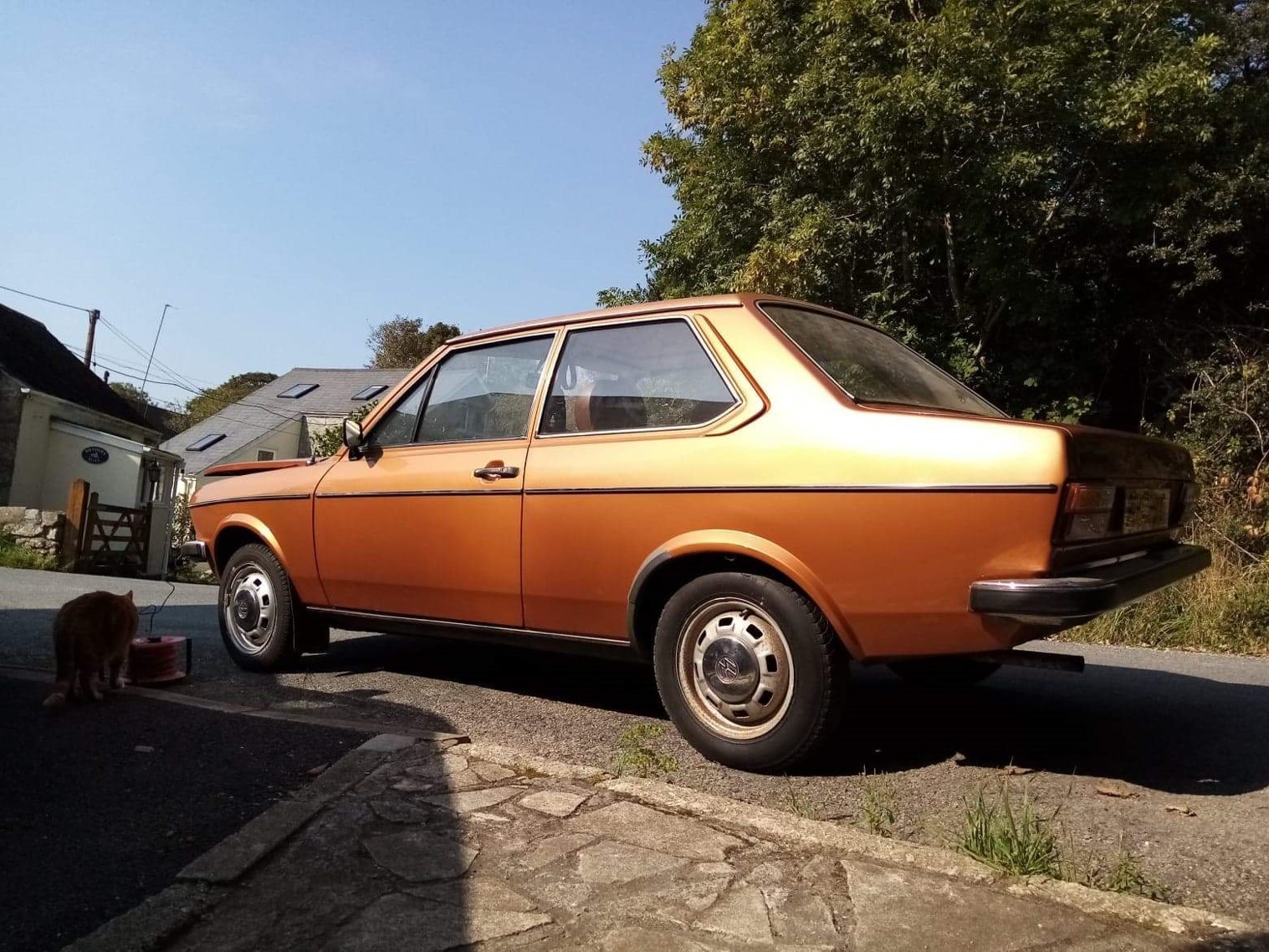

Here are some pictures a couple of weeks back!

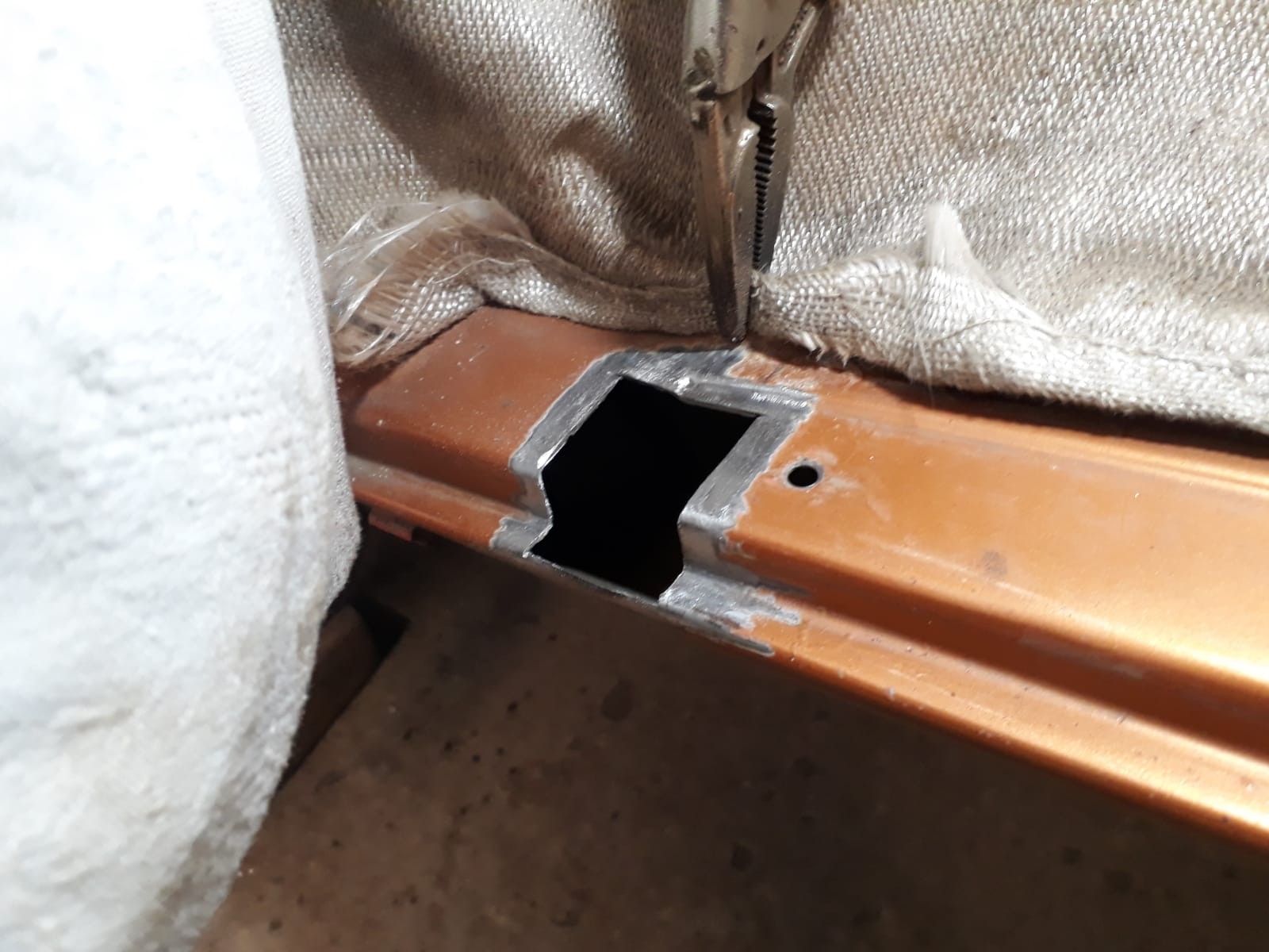

Not a surprise really as the car has sat for 20+ years.  The tank is I think full of rust.  First test is to get the back seats out - I haven't fathomed this yet!!  I will check the fuel gauge is operational, and if so look for a new sender unit.  I then intend to remove the sender and drop a couple of strong magnets in the tank.  Change the fuel filter (I have a bag full!) and leave for a week for the magnets to get to work!!  I will then drive locally around the village and keep an eye on the filter, changing regularly.  Hopefully the issue is a piece of rust blocking the outlet from the tank and the magnets will solve this!  I'll keep you posted!  The care has been regularly undersealed and hopefully is only surface rust internally, so if the tank has to come out, it should go again.  I'll take a proper check of the filler neck at the weekend and see how this has fared!
Blow compressed air down the fuel lines (feed and return) to send any rusty sludge towards those magnets.
You might need to clean carb of ethanol induced crusting in the float bowl.
I'm now using Startron but Fuelfit would do the same job to stop water absorption.
https://www.thedrive.com/reviews/28046/best-fuel-stabilizers
When I first got the golf on the road after being in a barn for 15 years I had the same problem. Every now and then it would splutter and die. pulling the feed pipe to the fuel pump and blowing down it would sort it for a week or so until I changed all the fuel lines!
Well I have now installed the magnets in the tank and so far so good.  A period of sustained testing is required now!!!  The sender was ceased solid, but I managed to free it up.  The float however had a hole in it!  It was stamped VW but made by Smiths!!  I thought it would be a VDO one.  I hope this replacement part will fit, it has no float but a silver canister (i guess with a float inside?)  Part number I have found on a replacement is 861 919 049 and is VDO one.
I will definitely give Startron a try.  I have been worried about ethanol in petrol damaging carbs, fuel lines and general condensation issues.

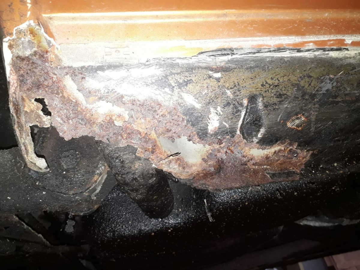

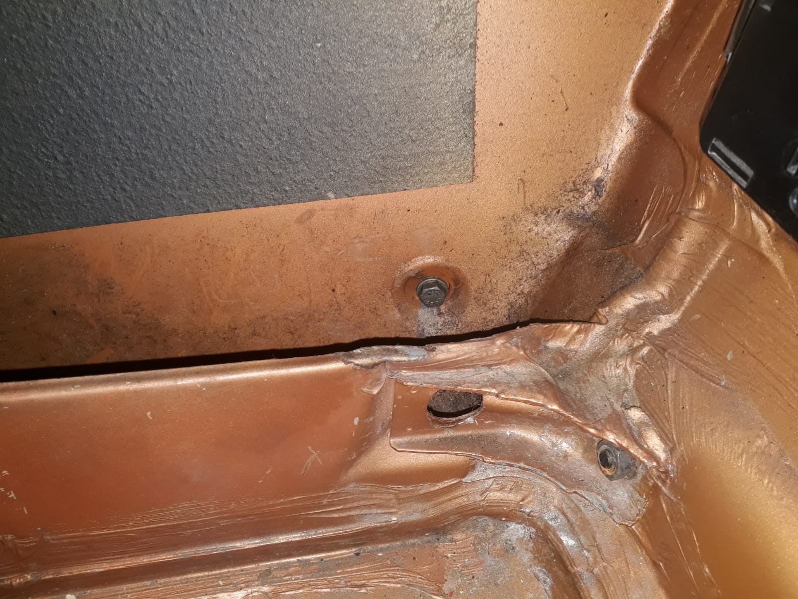

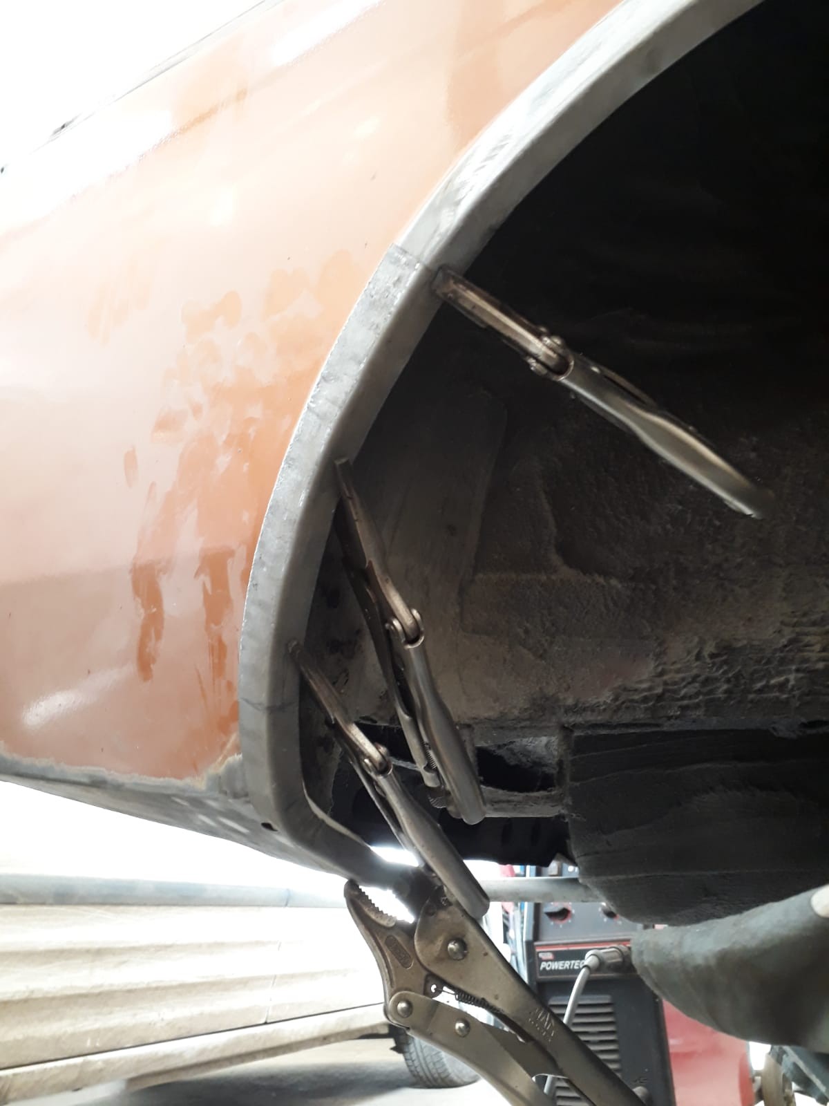

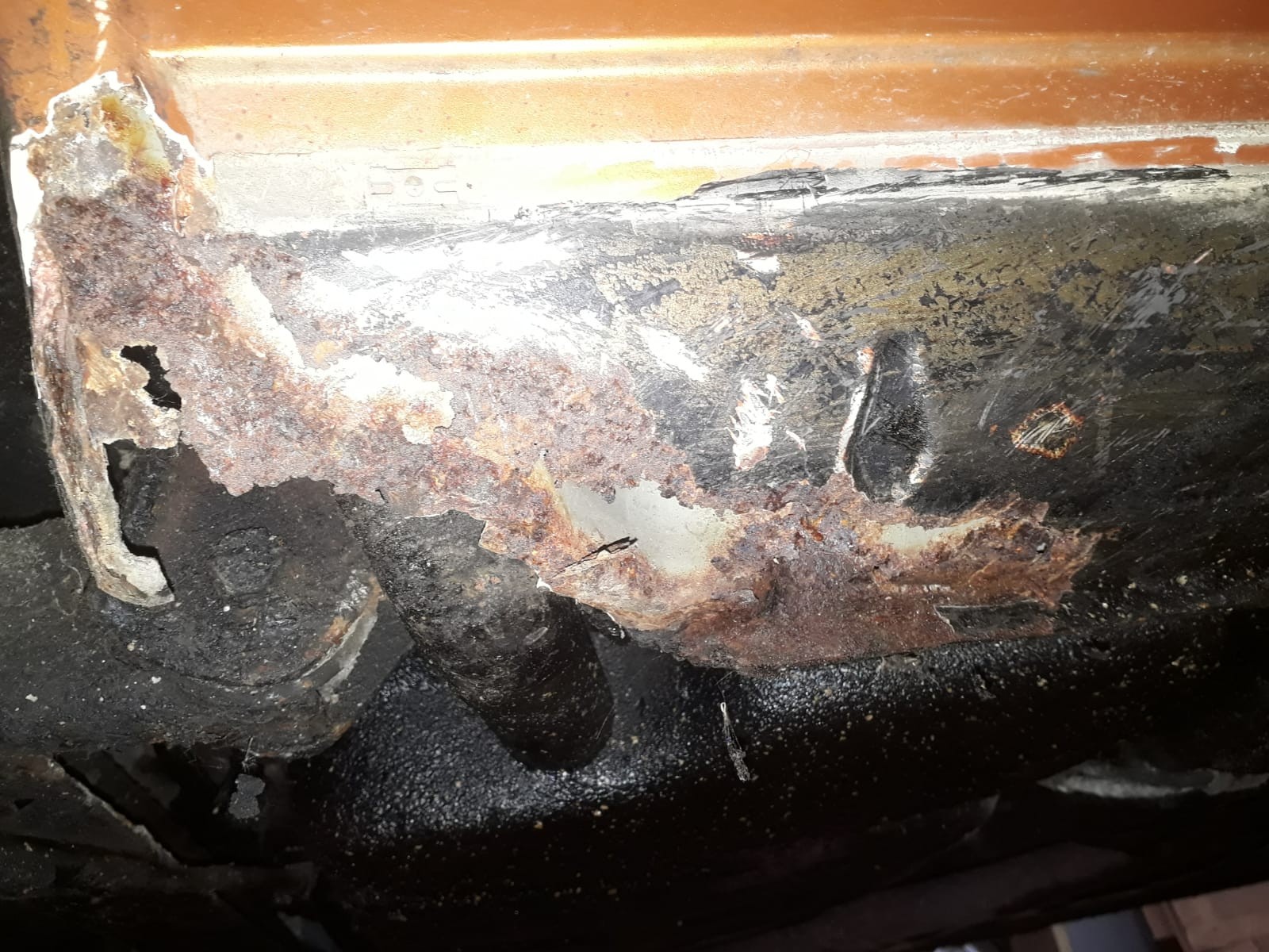

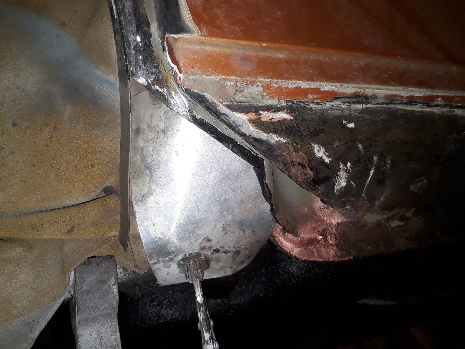

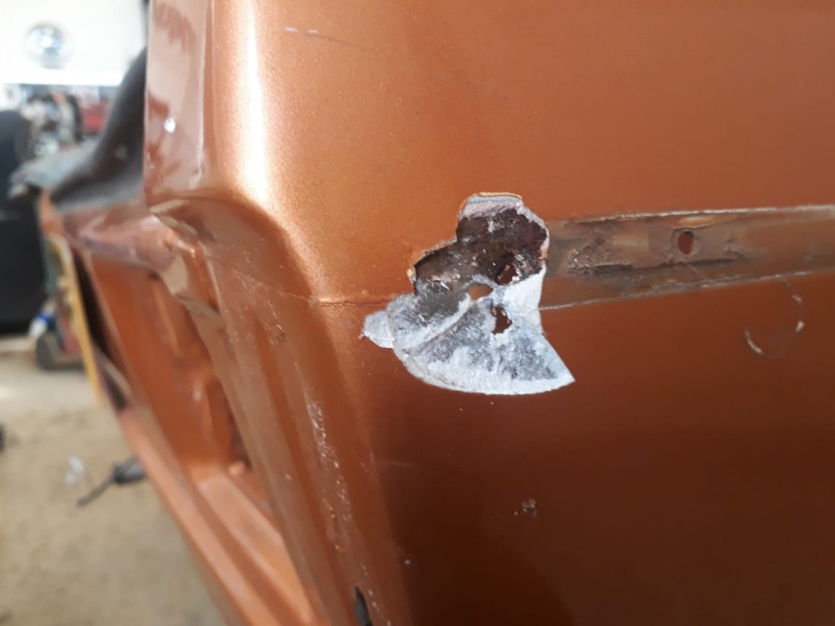

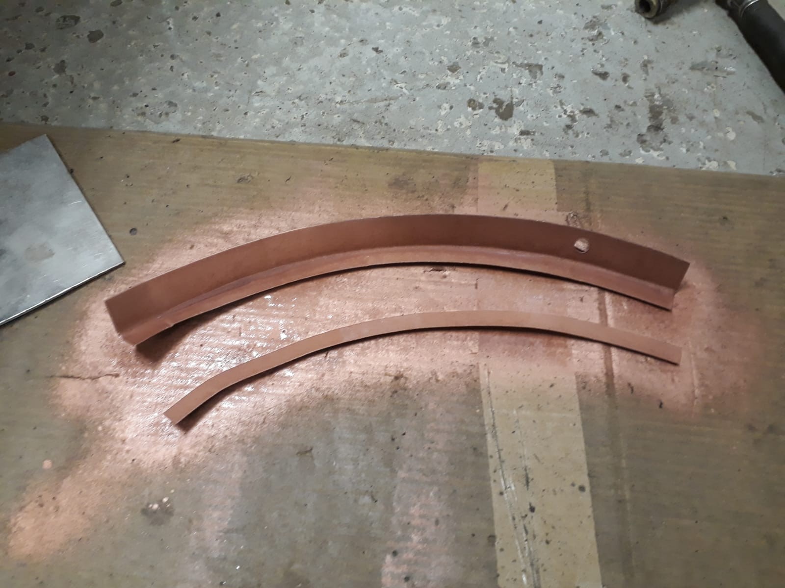

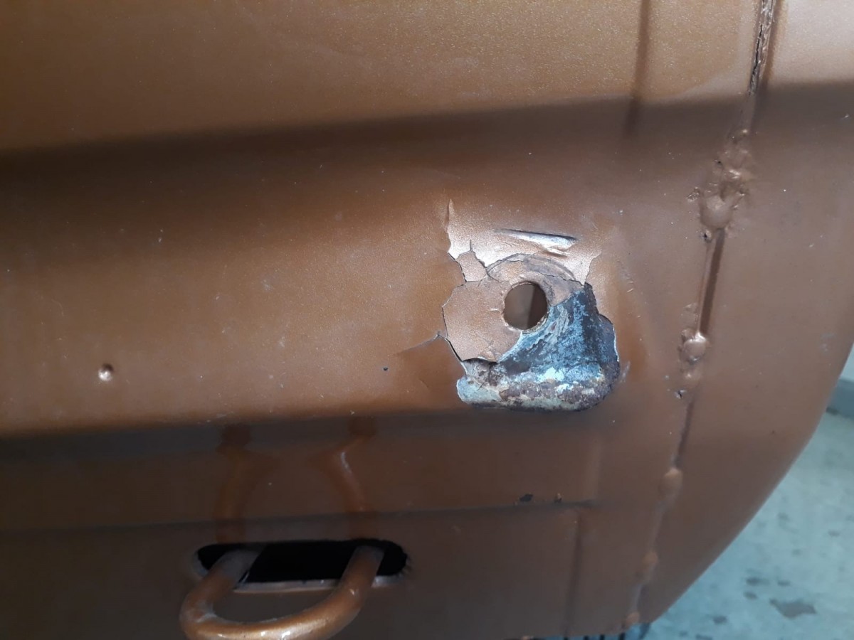

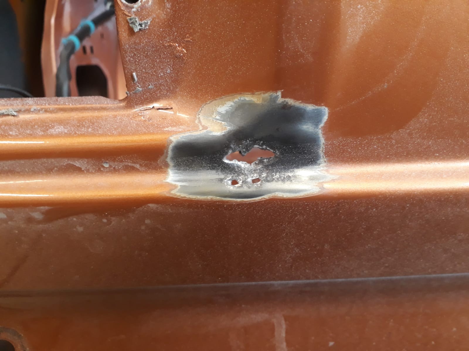

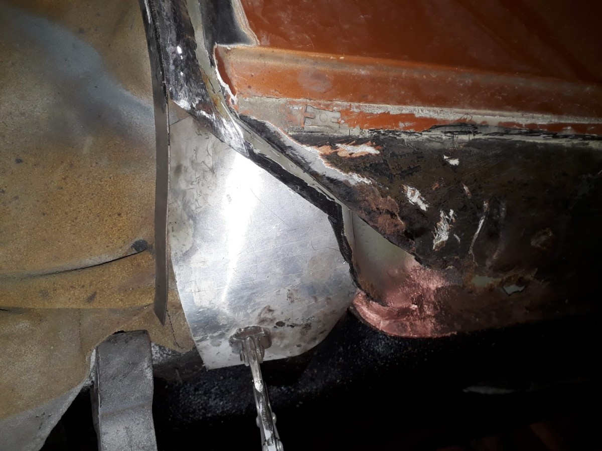

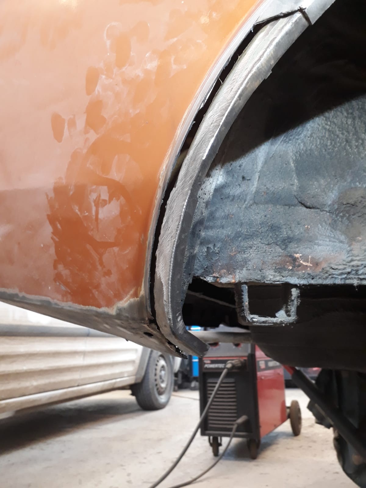

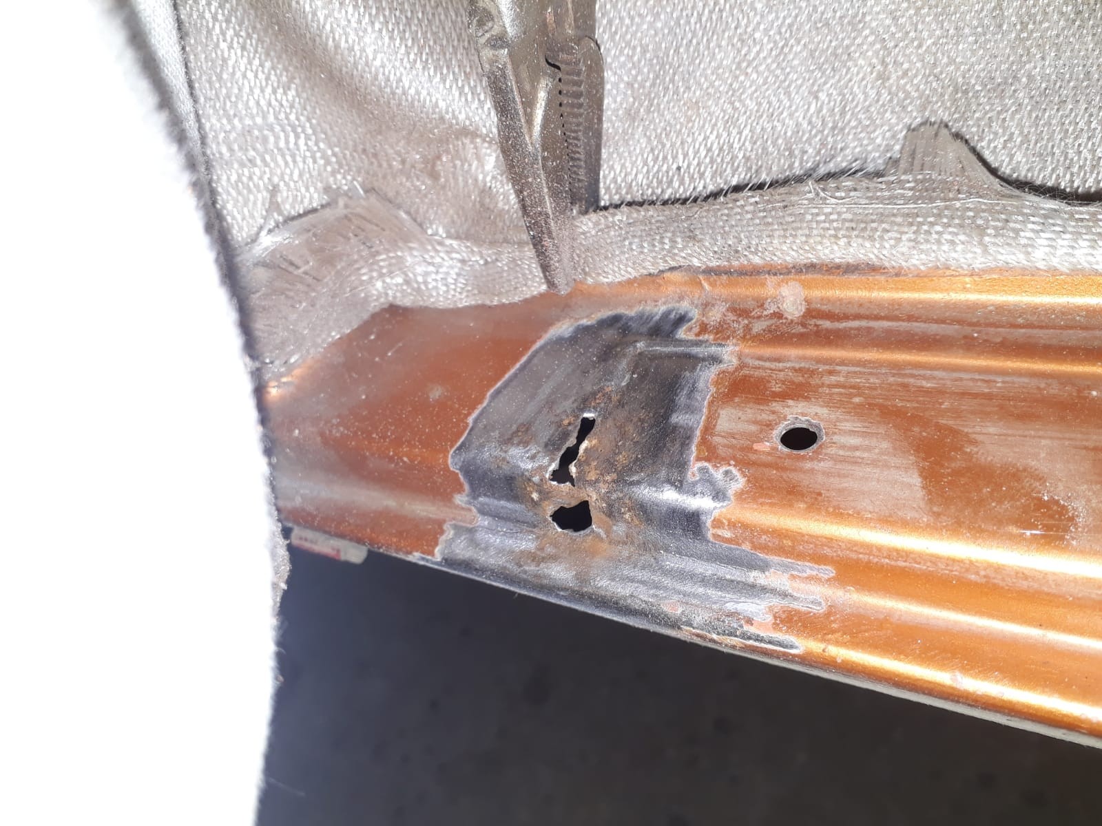

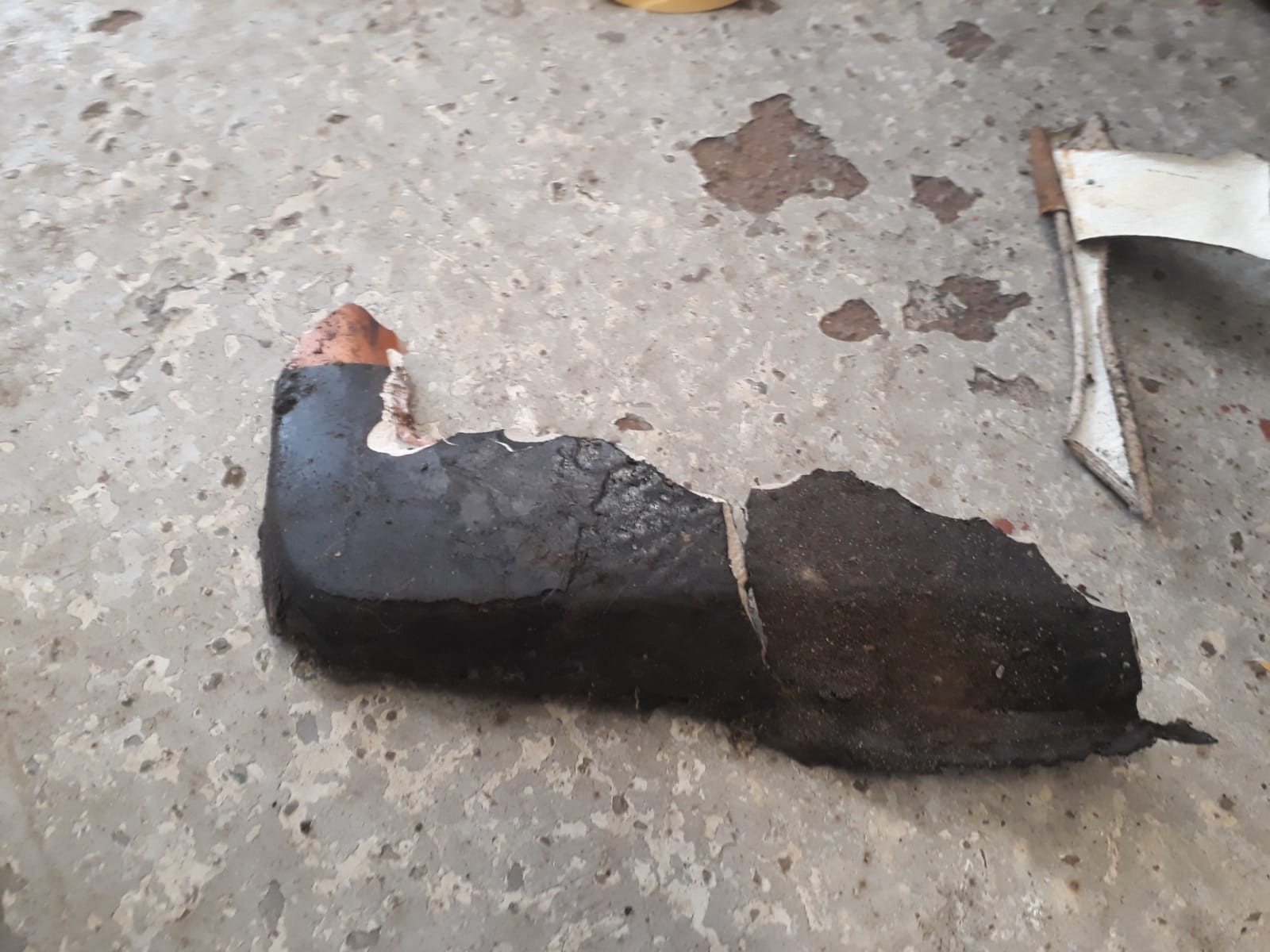

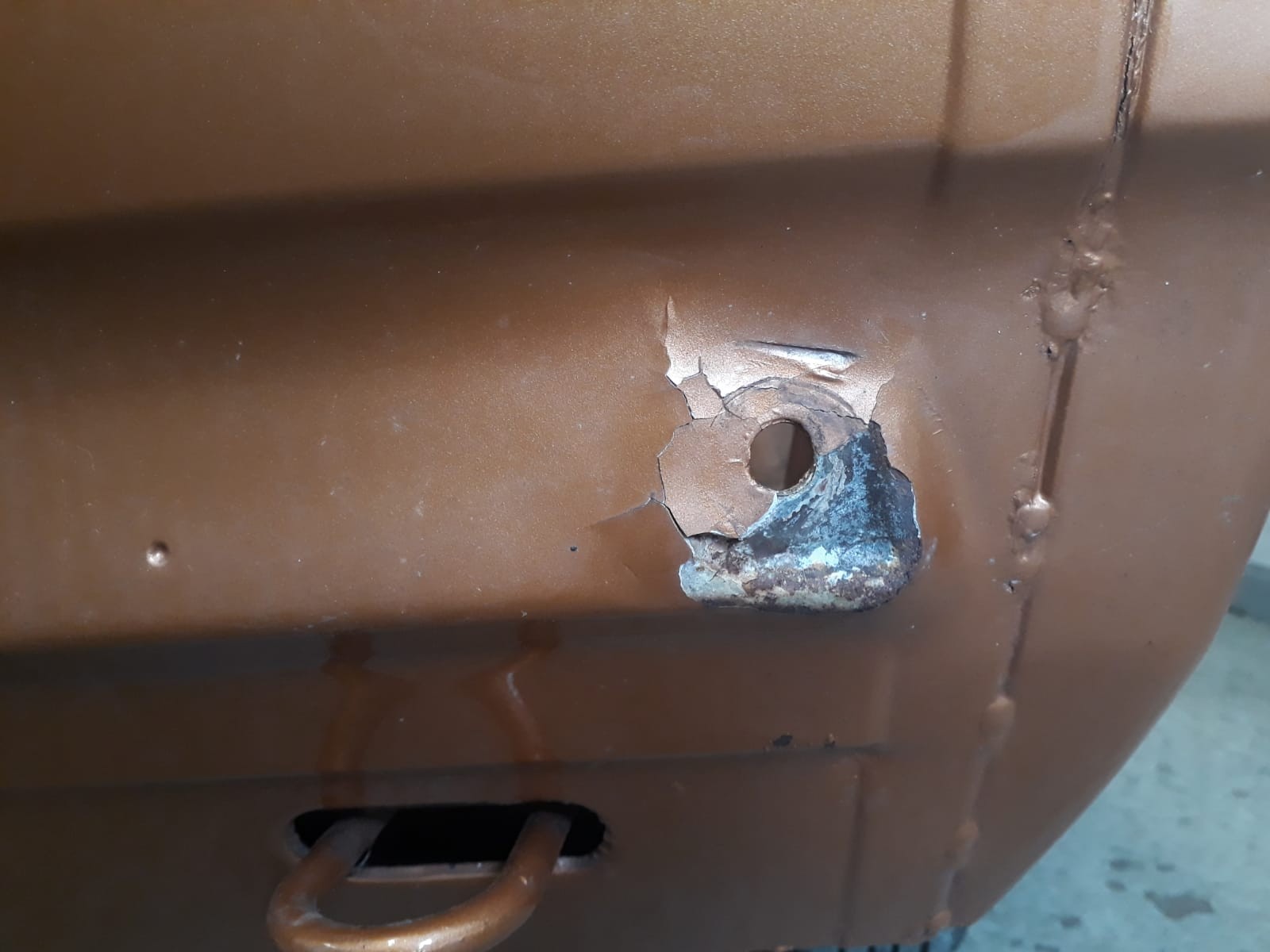

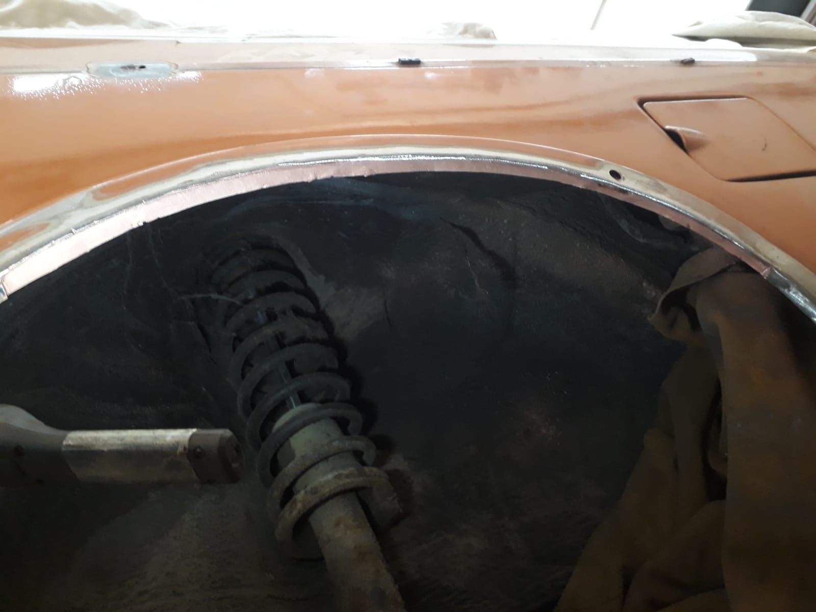

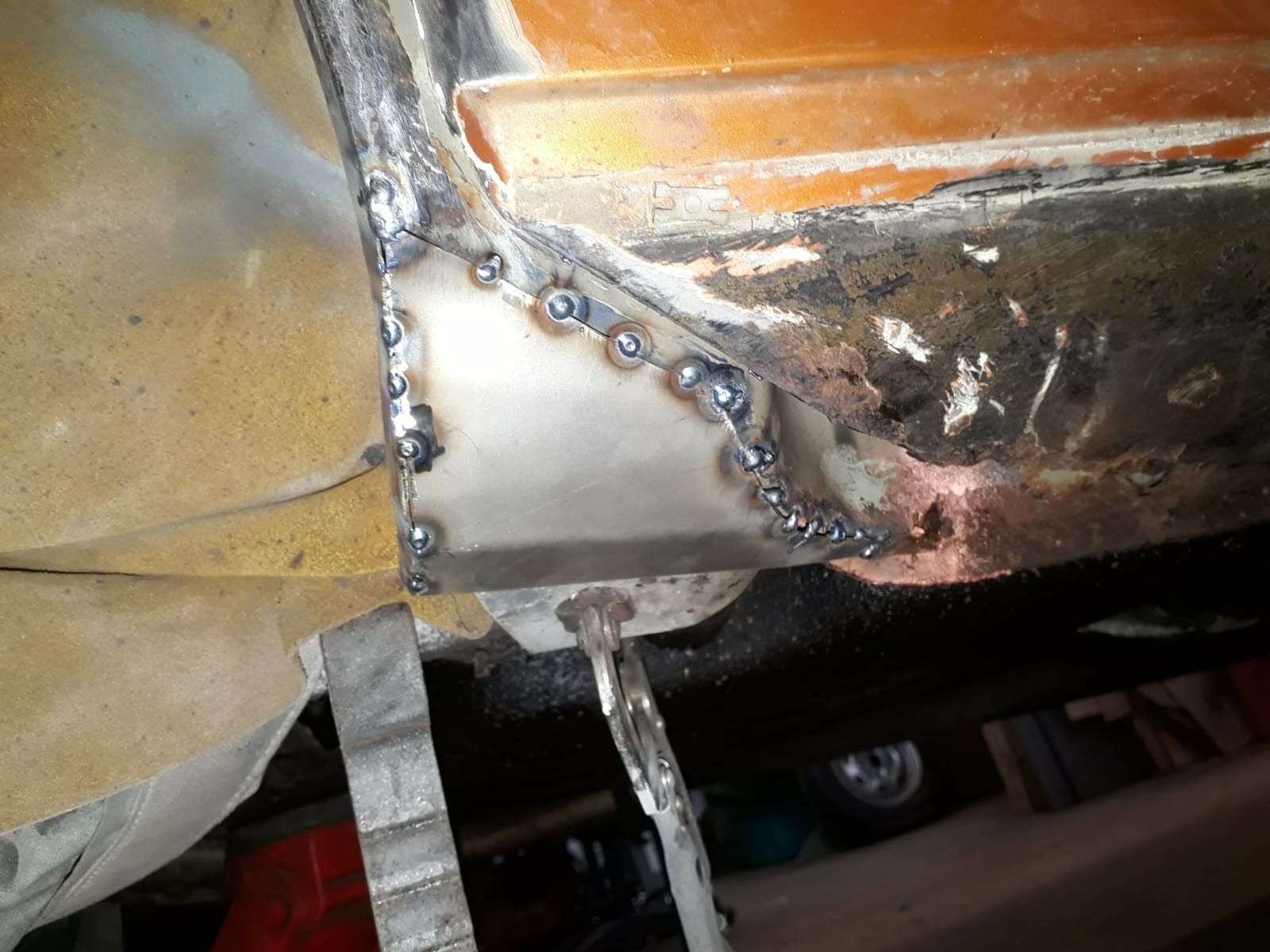

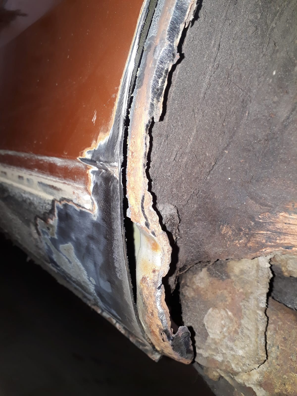

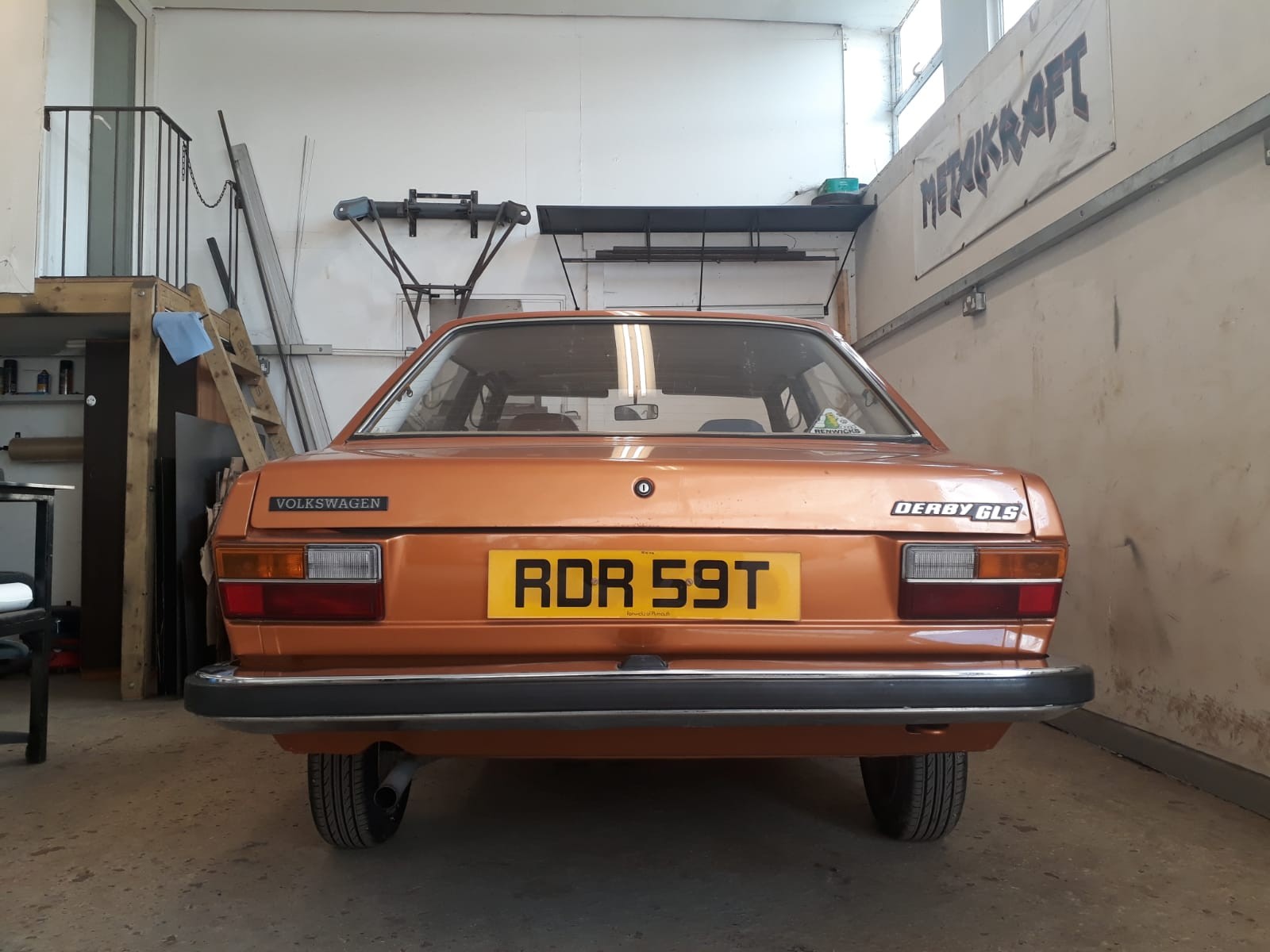

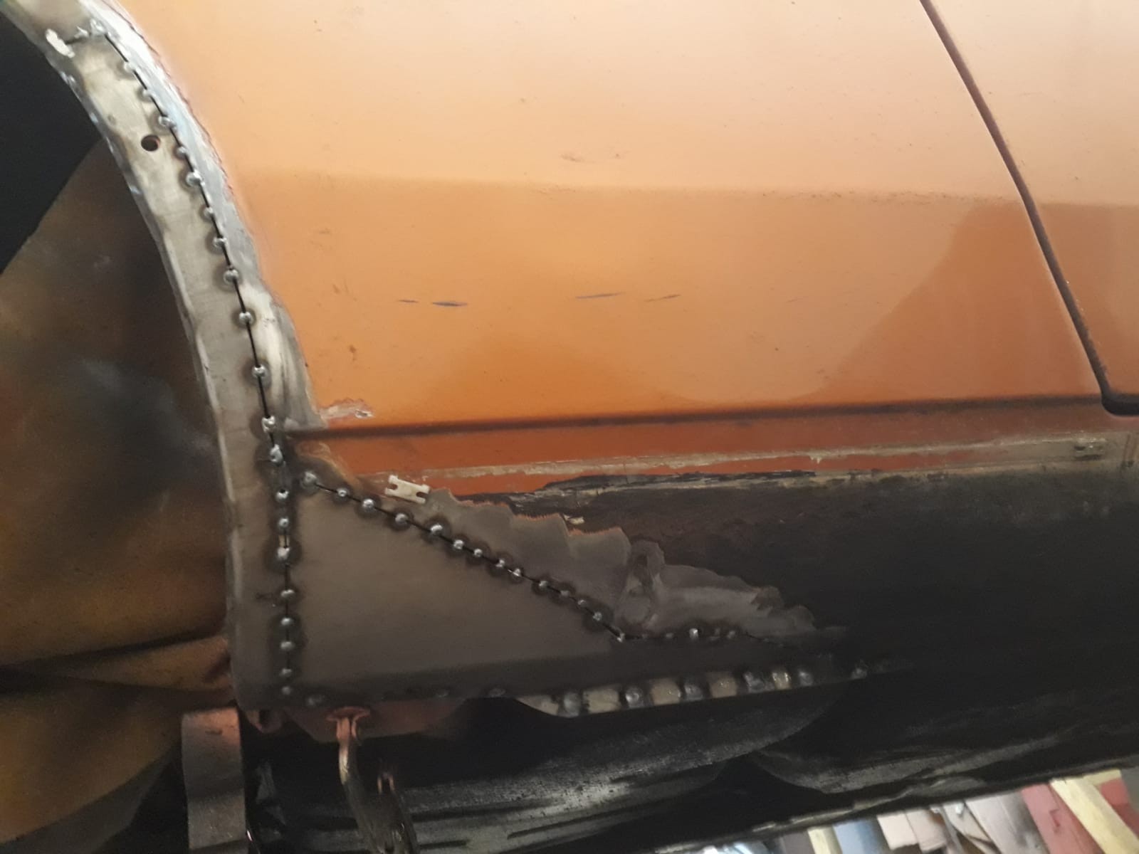

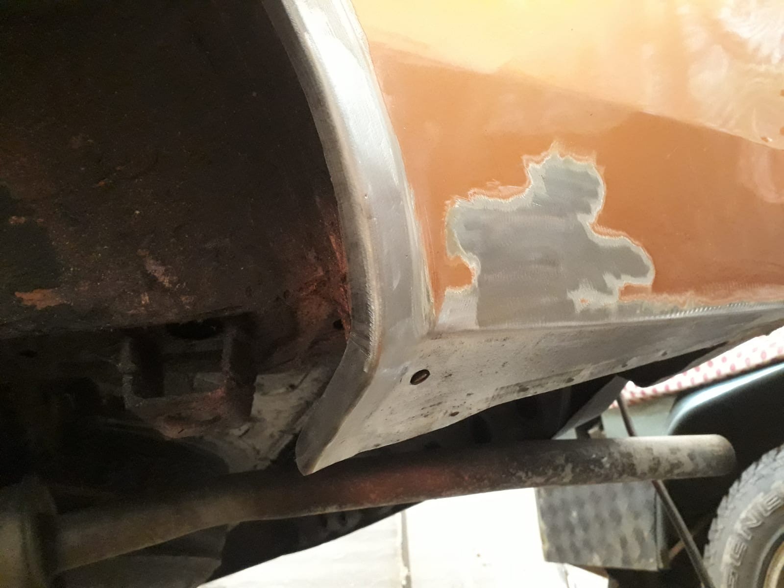

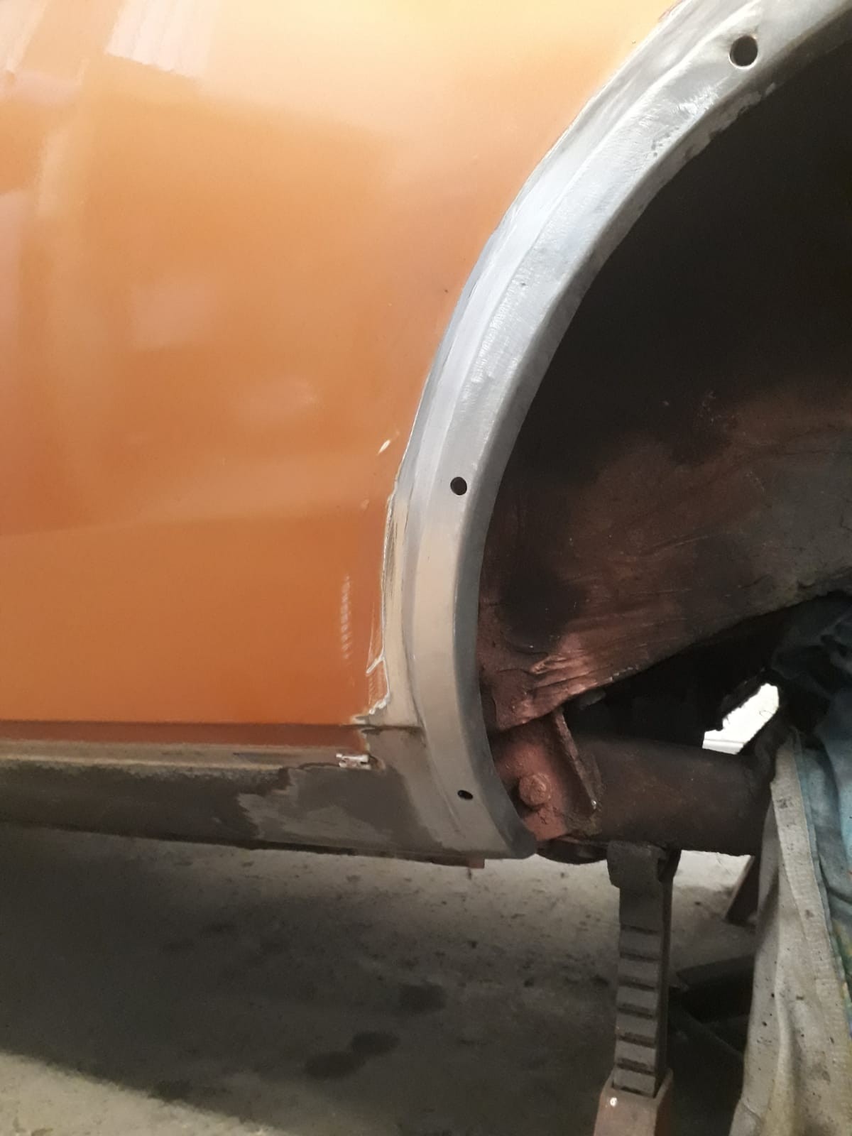

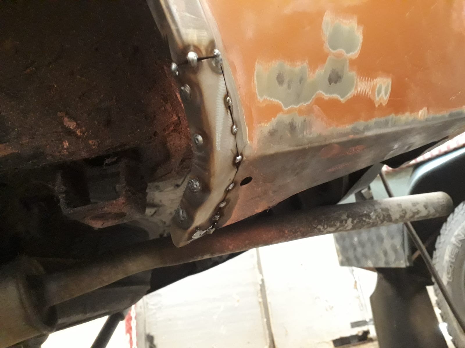

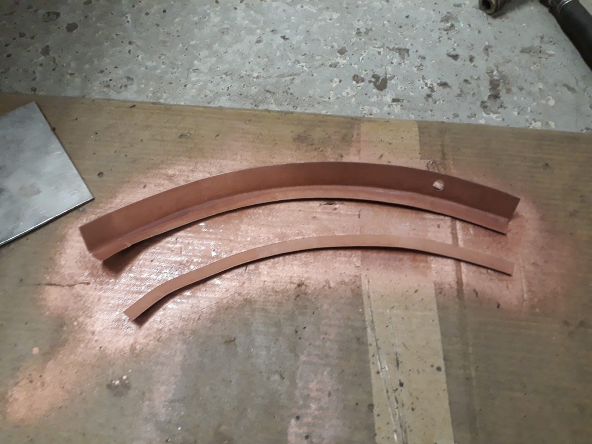

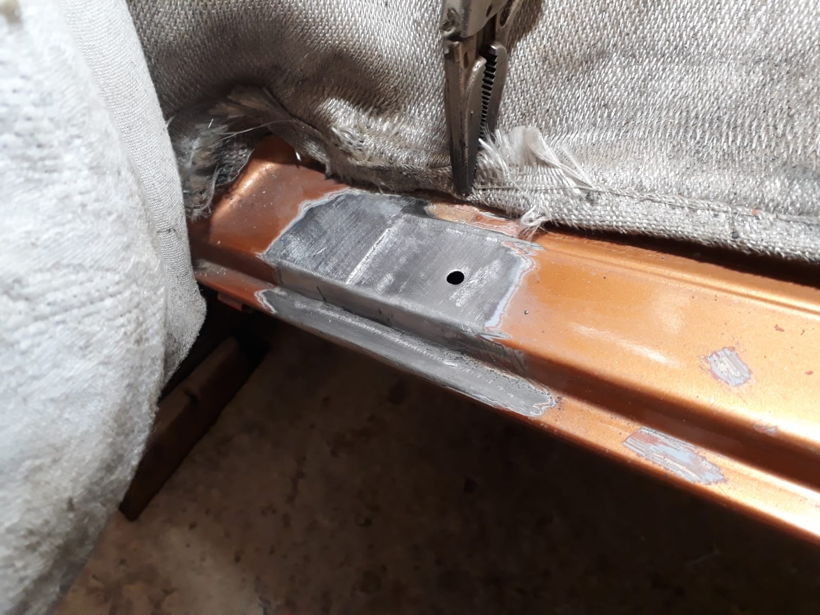

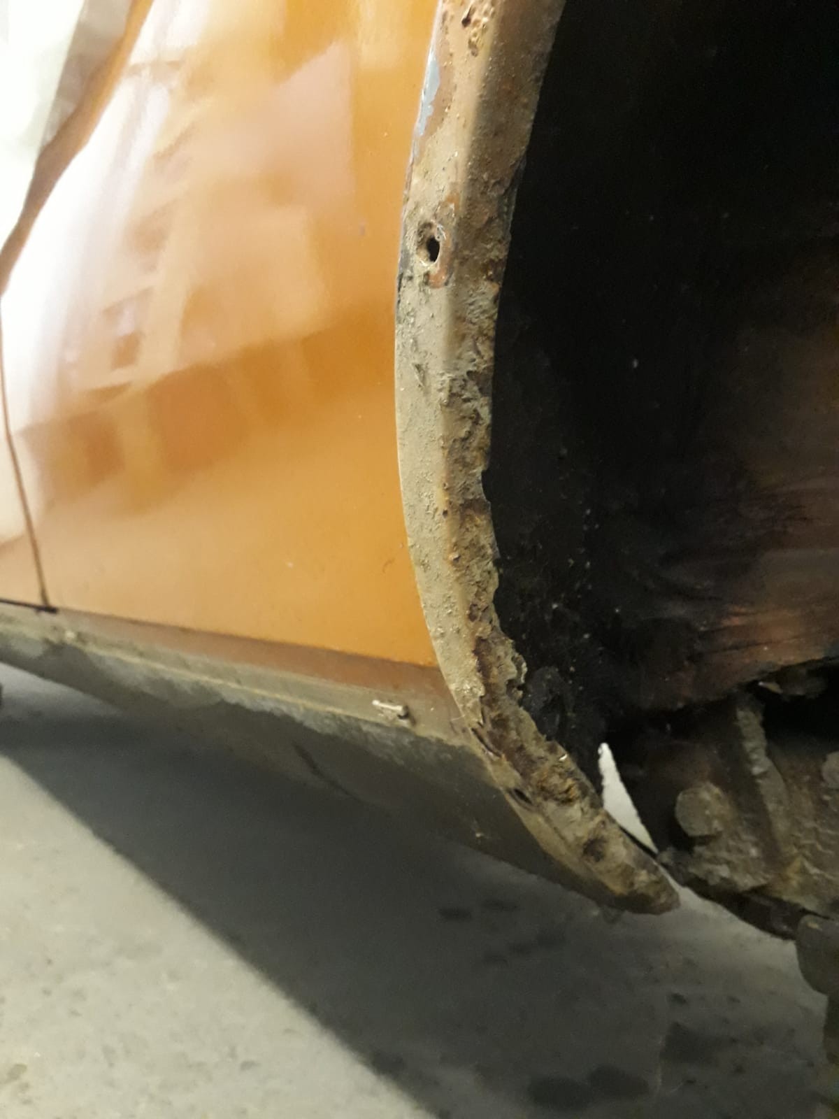

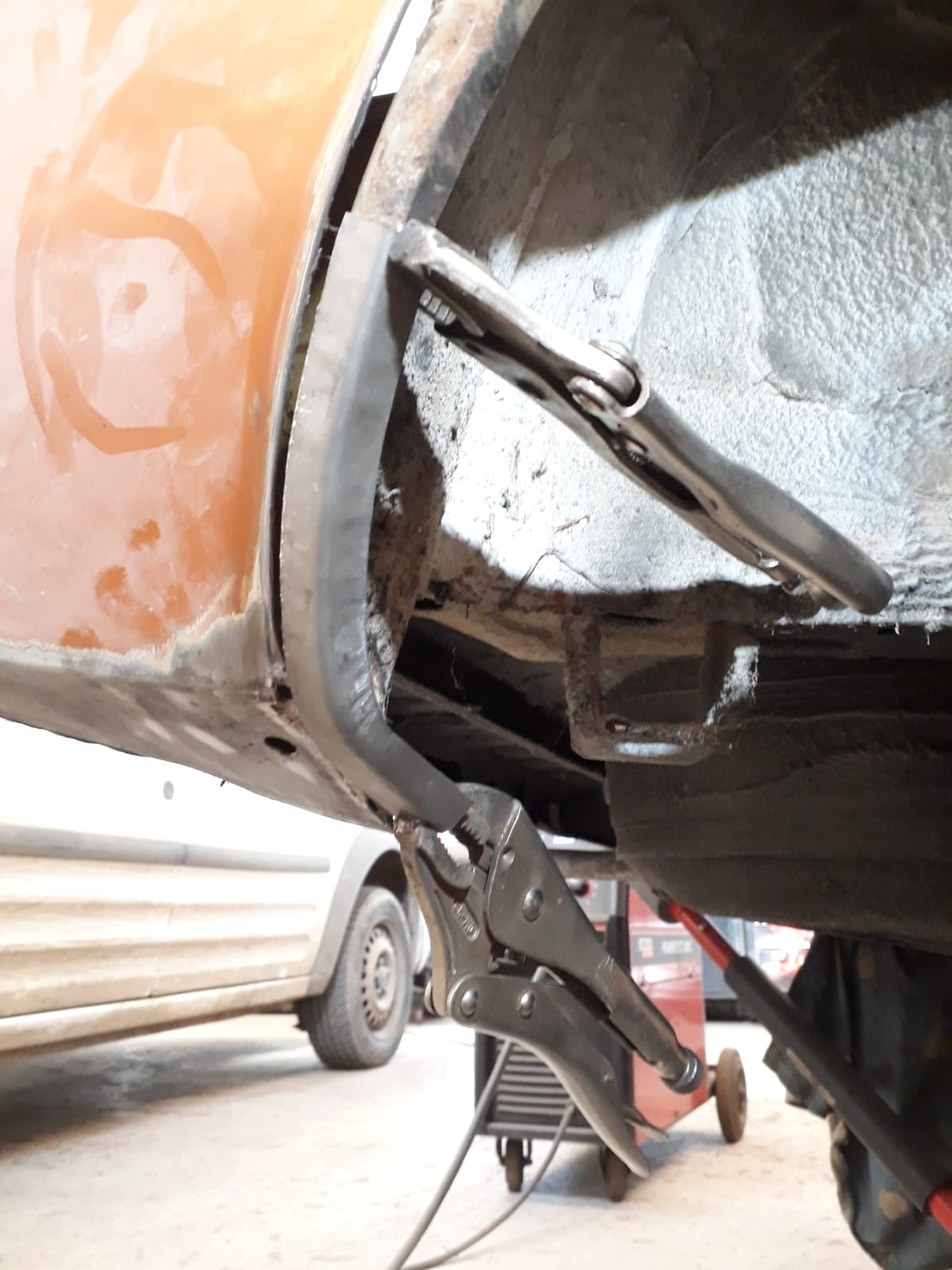

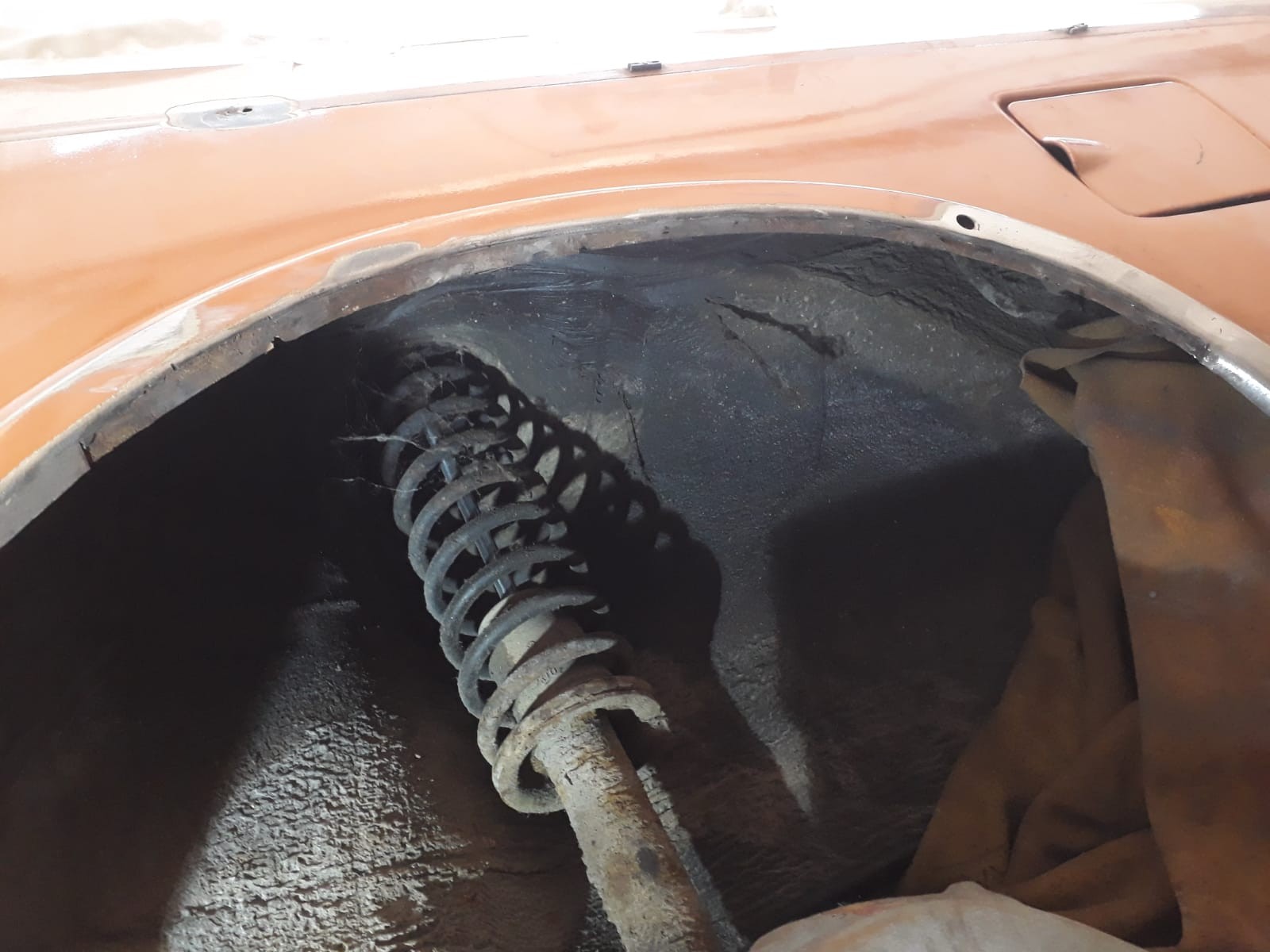

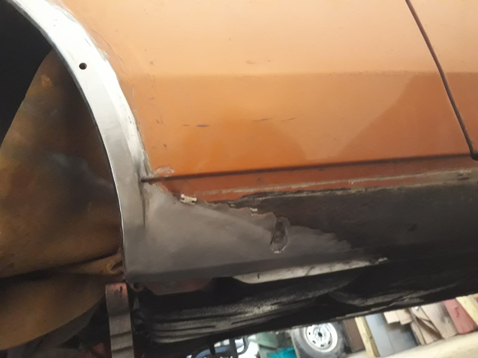

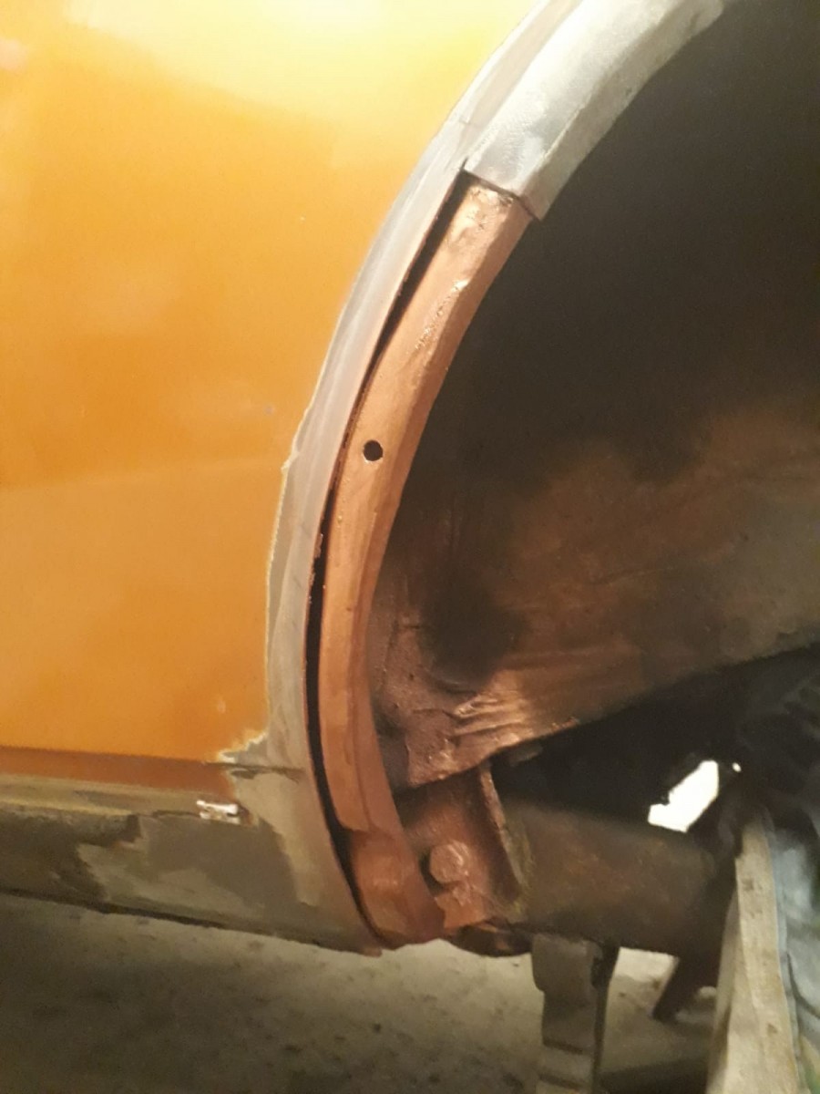

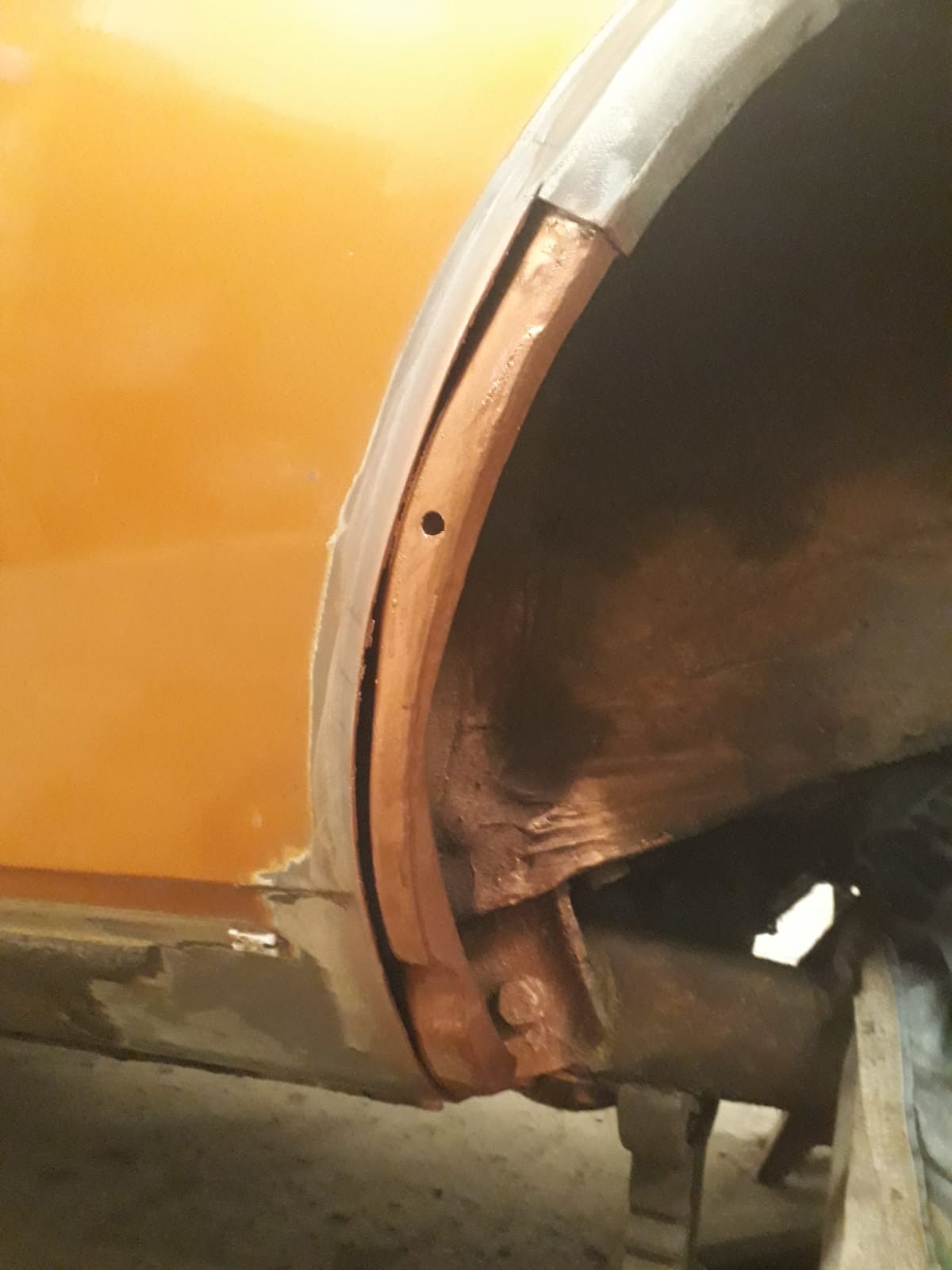

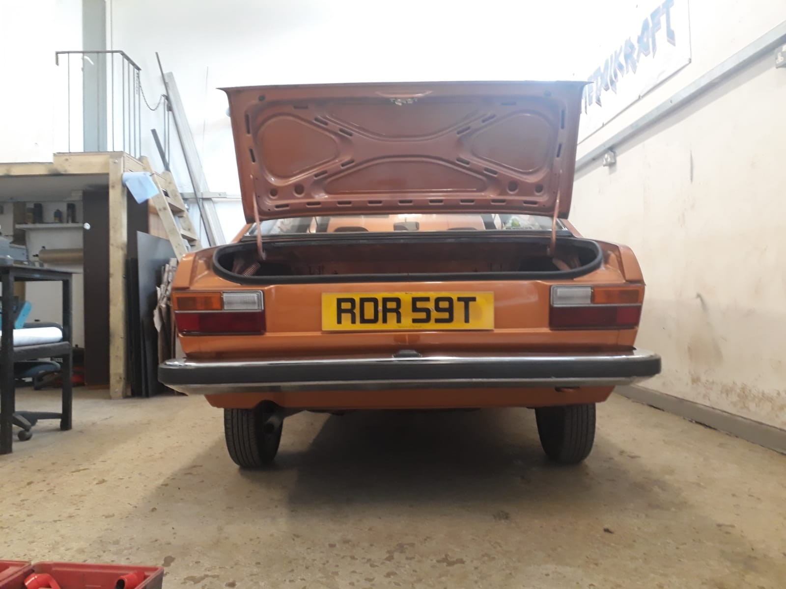

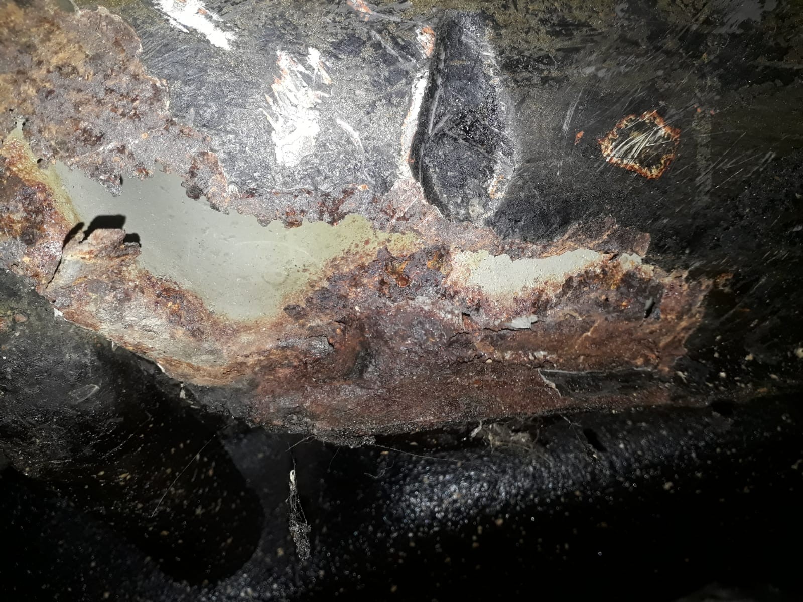

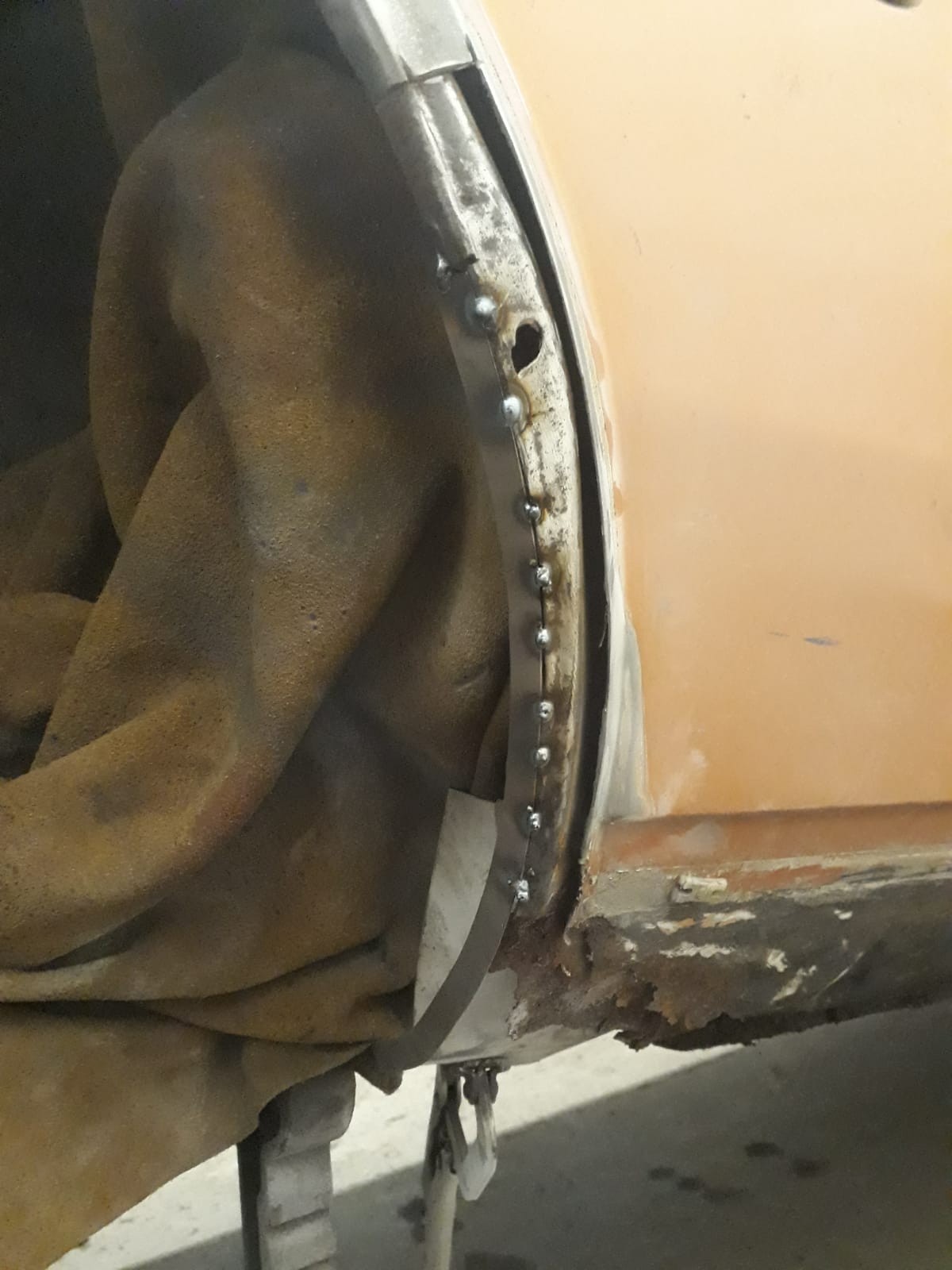

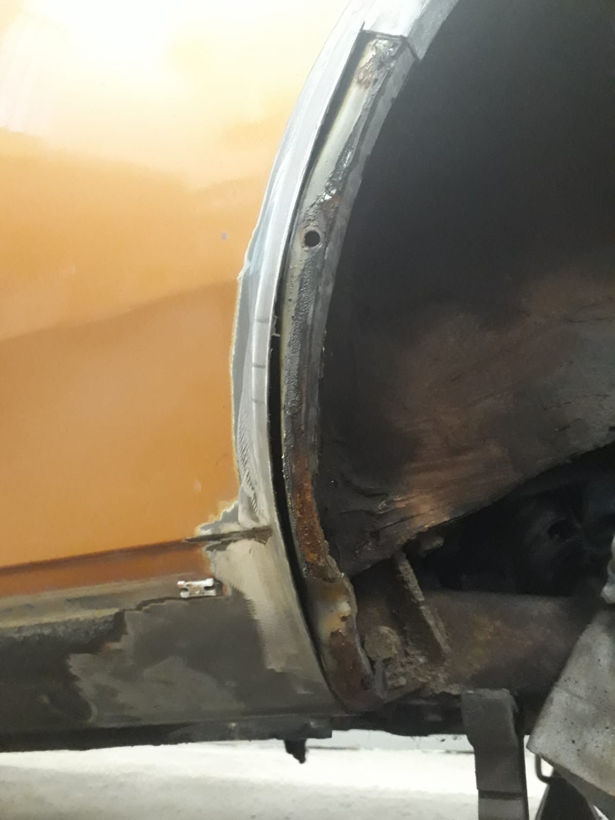

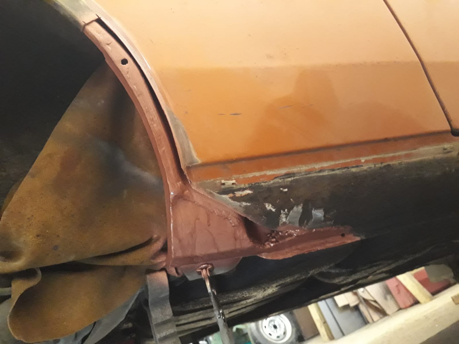

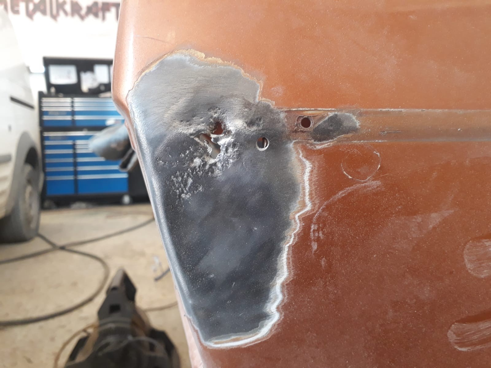

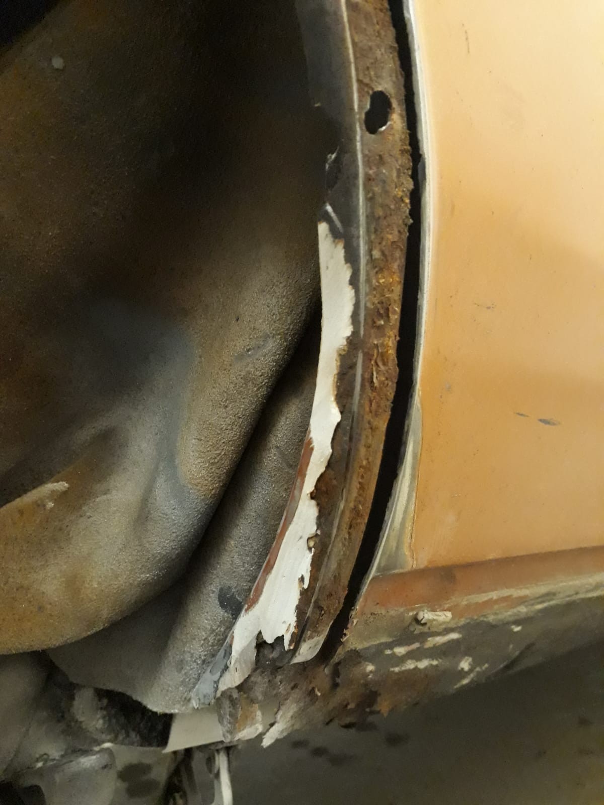

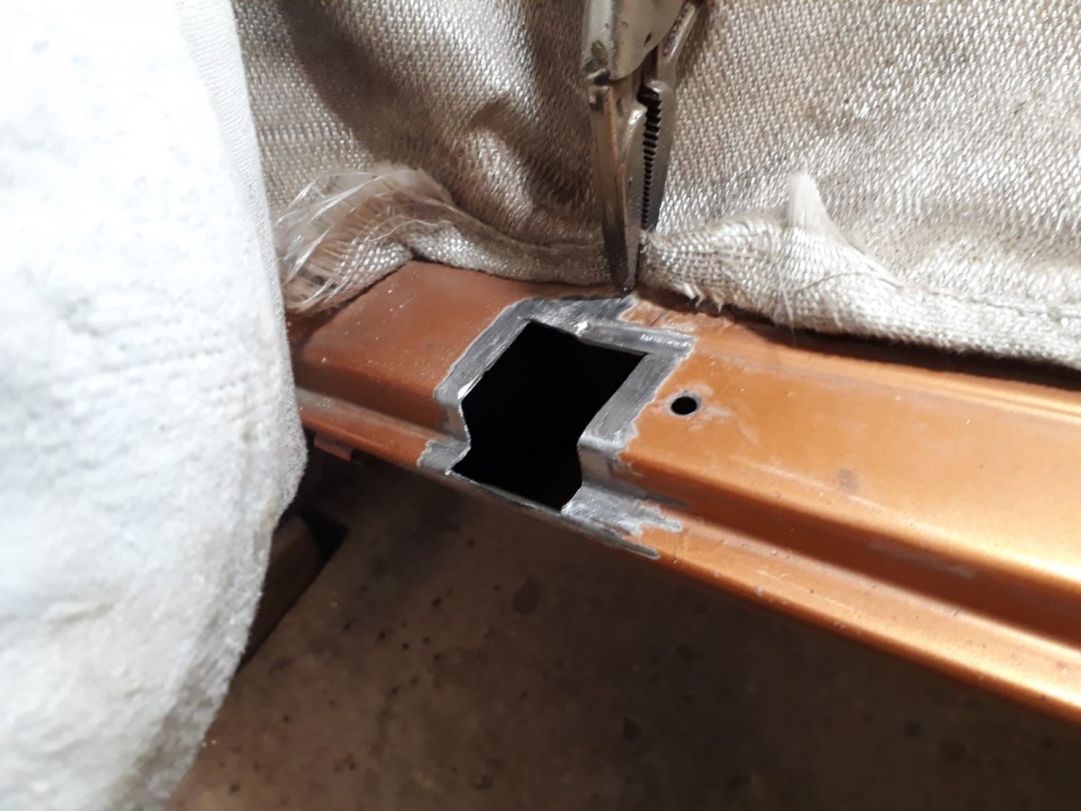

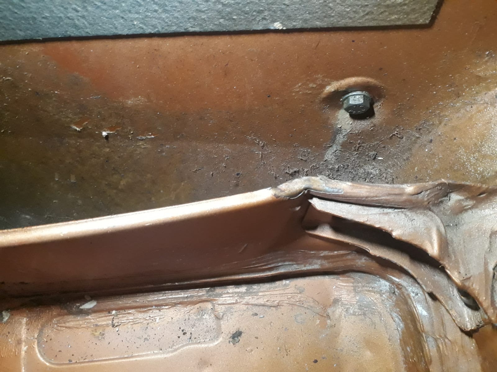

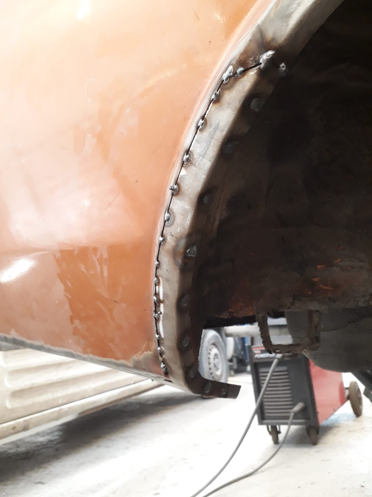

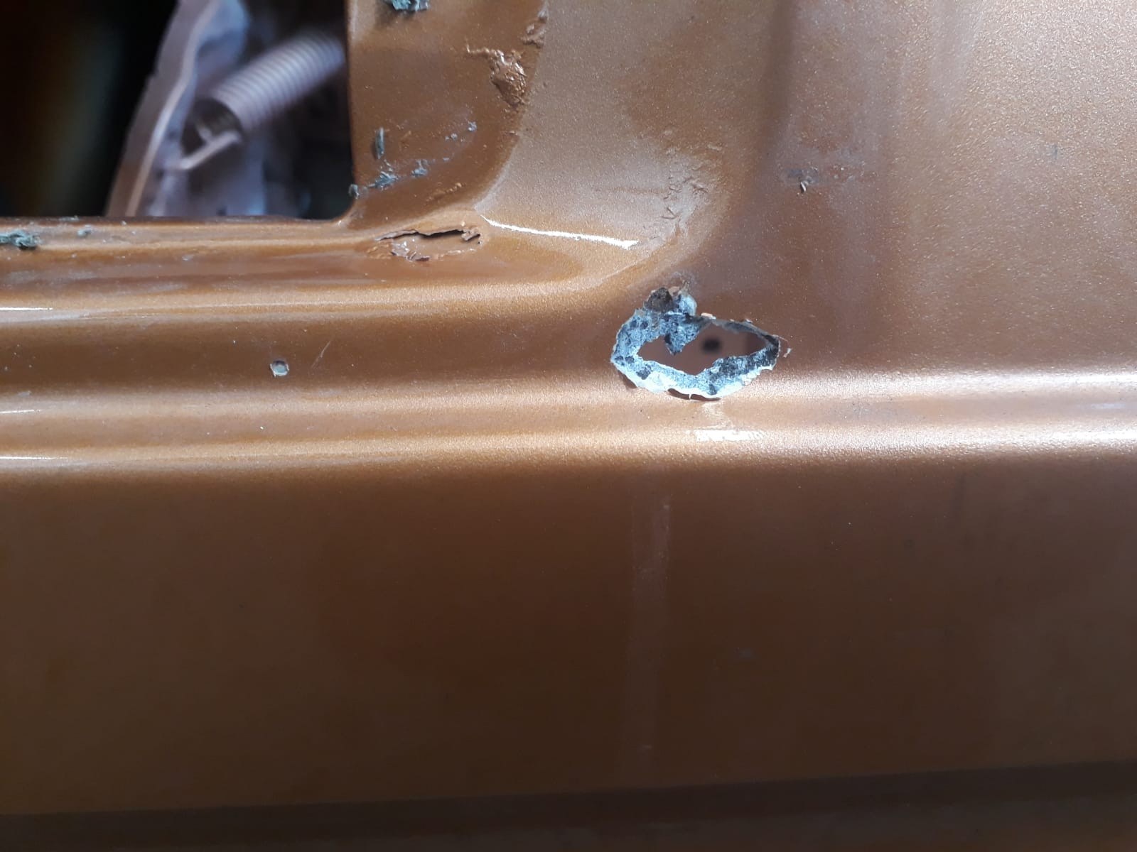

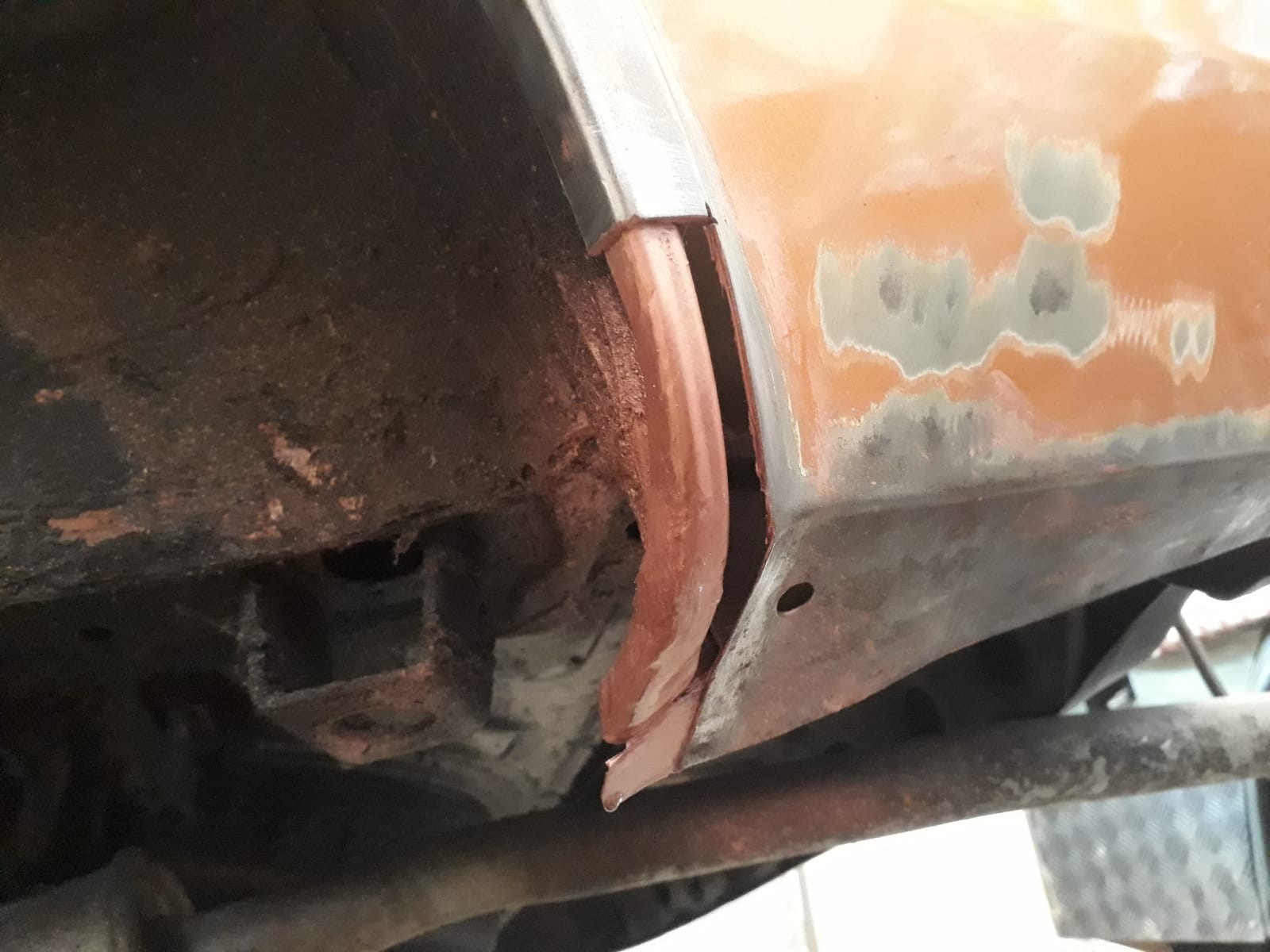

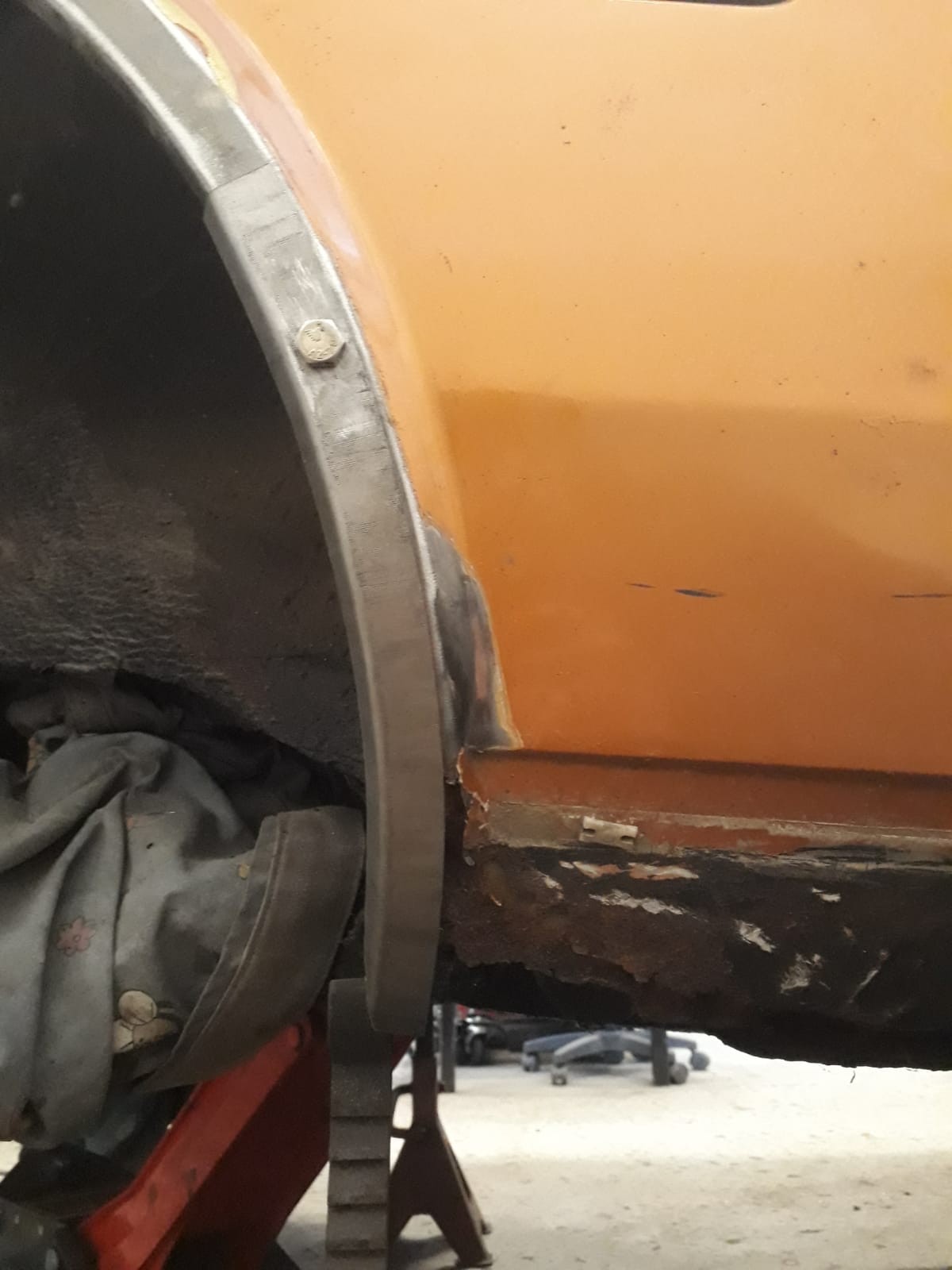

So, Desmond, as he has become known as is now with Sam at Metlkraft who is dealing with the areas of rust and rot.  3 days in and the rear arches and rear cills have been addressed, along with a historic parking ding which made the rear bumper unlevel.  Really pleased with the progress, even if a few bodged repairs have been discovered.  Better than being un-discovered to cause problems down the line!
Cill repairs:
Arches:
To Be Continued!!!
Really pleased to see works commence.  Thanks Sam, hopefully there will not be too many unforeseen surprises!
It’ll all be worth it in the end.
It’s a cracking little car that’s for sure, you and Desmond have been lucky to find each other.
Many out there would have just sent it for scrap.A cracking little car that will have plenty of character!
That rust looks standard like Polo stuff and not that bad, so there shouldn’t be too much of a problem with the rest of the bodywork.

More progress this week 🙂
