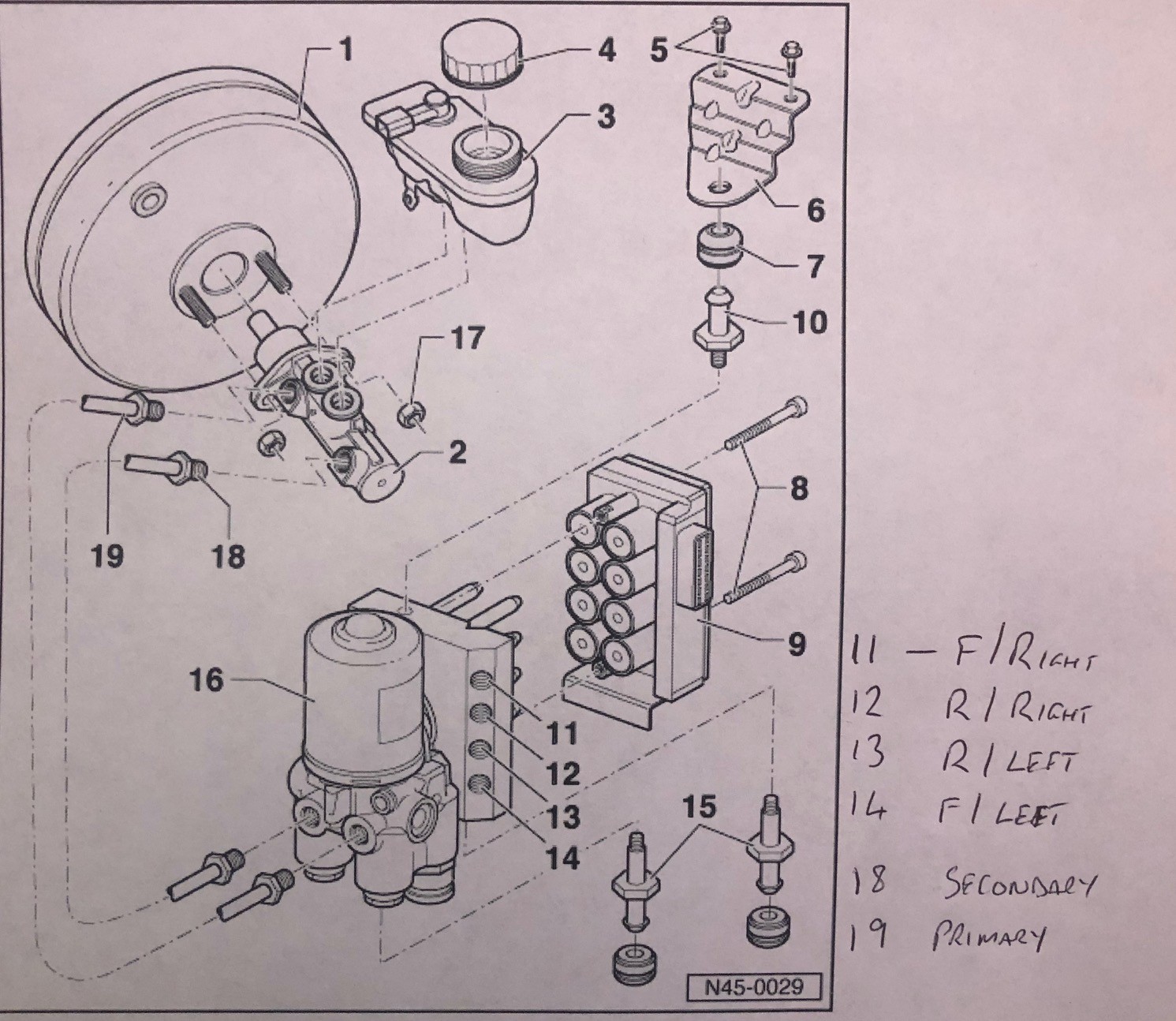

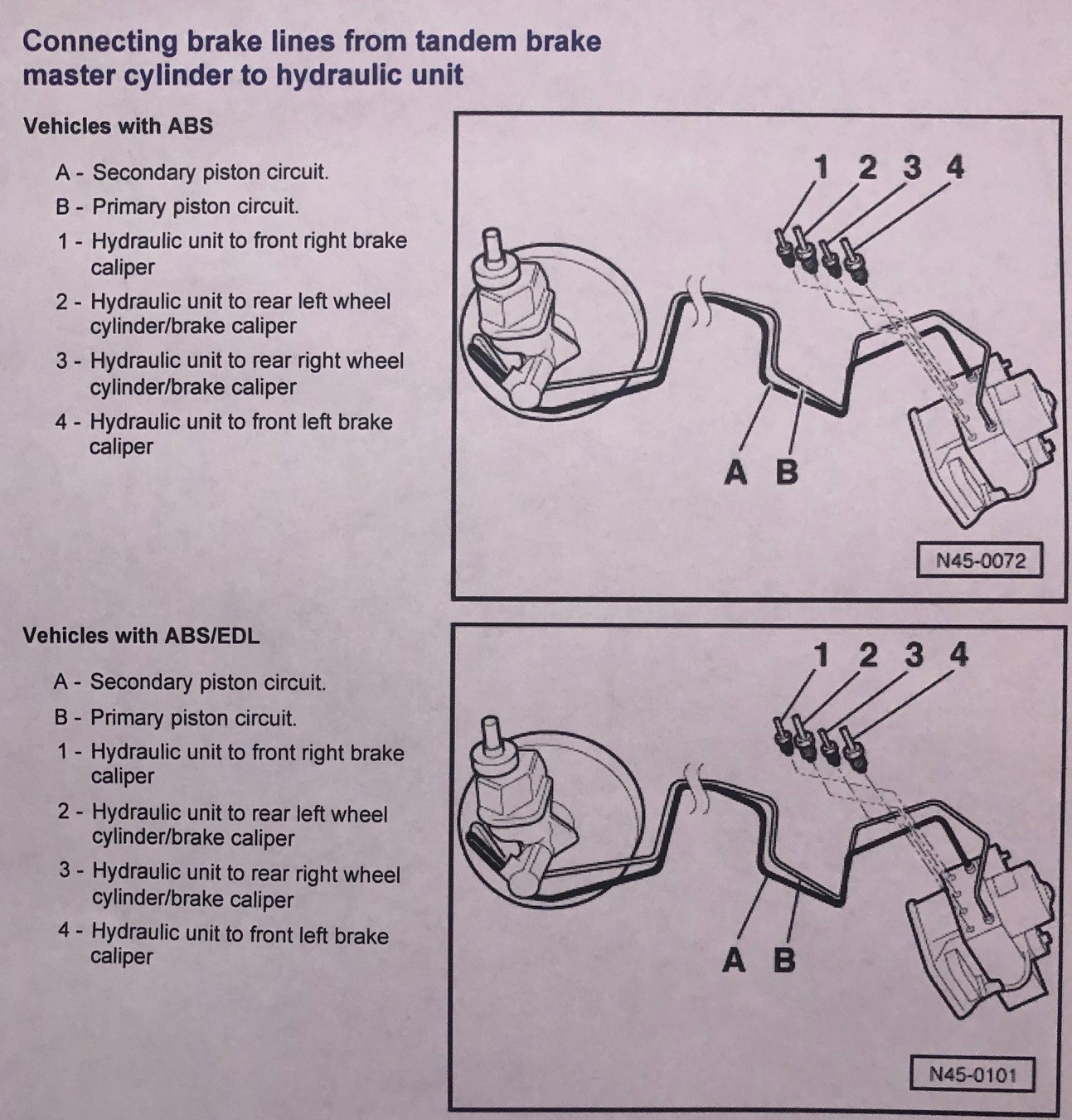

Currently working on a 6N 16v project and I've replaced everything with 6N2 GTi parts. Car was non abs and the plan is to add it. Have the module, front brake lines, master to module lines.
Bit I can't remember is what port is what on the module. If anyone could show me what line goes where or has a diagram it would be much appreciated

  • First Welcome to the forum.   There are two versions of the ABS unit the pictures should help
