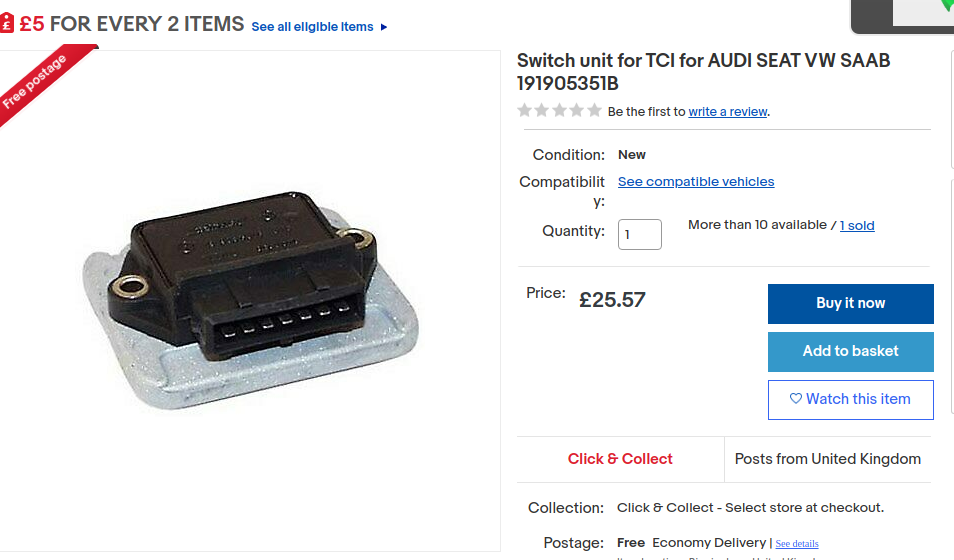

If I'm going to stab a guess, and it is a guess - 2f's have a square ignition coil with a transistor / TCI unit stuck to the bottom of it. These do break down over time. I don't know a definitive way of testing them other than swapping a good one in.
This is an example of the part, but I haven't checked if it's the right one for your car
https://www.ebay.co.uk/itm/Switch-unit-for-TCI-for-AUDI-SEAT-VW-SAAB-191905351B/362914035088?epid=21012615791&hash=item547f5cb590:g:hh8AAOSw7eleRajK
Thank you all for your tips.  I went over to the lock up and didn't feel brave enough to get the car all the way out to check the fuel filter, but I did unplug the temp sender (blue one, that goes to the ECU) and the problem remained the same.  I know that this isn't a smoking gun, but it doesn't declare the sender totally innocent either.  So I ordered a replacement sender and we will see what happens.  The control unit mentioned by Yeti differed in price by £200 between items, which seemed a bit strange - in any case, they didn't have any in stock.  I'll be replacing the sender next weekend, so watch this space!
I've just checked compatibility with the ebay item exactly mentioned by Yeti and it should be fine, so that's what I'll be going for if the sender changeover doesn't do the trick. Thanks!
