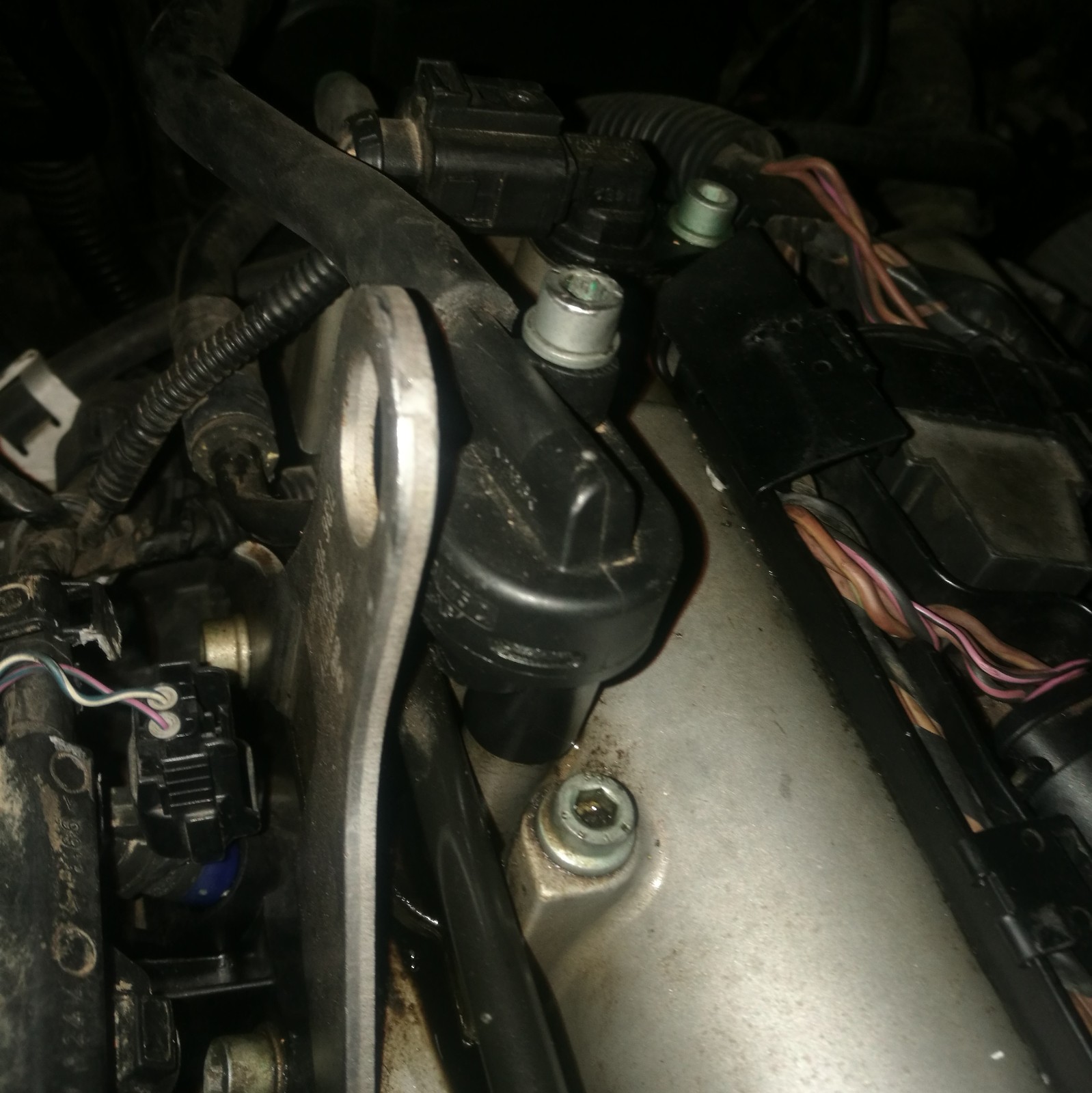

Hey guys, not much of a greese monkey and my English is bad so bear with me.
I recently bought a 2nd hand 1.4 16v 2003 BBY, been running ok with a few issues but and have been able to fix them, cleaned it up and still working on it.
the recent problem m now having is a leak from the valve located at the top of the engine as shown from the attachments, when I cold start it, runs for about 2-5m before it starts getting hiccups. At first I would get black and blue smoke but now just hiccups without smoke(this is after I hadn't started it for a week).
Problems started after we cleared check the engine light, so don't if somehow related. That day when I removed the air filter cover the bolt holding that valve was almost fully unscrewed. Seemed as though the pressure from the oil had removed it.
White smoke was coming from sparkplug hole diretly inline with the valve, smoke was also from the throttle body, everything was a complete mess.
I need help with the possible cause for this, is it risky using the car ? and how can I fix it. I want to work on this car myself if it's possible. I want to understand this car and build it up myself. Please help.IMG_20201022_141554.thumb.jpg.05b97bb020b40c99e82fd3a39e738873.jpg

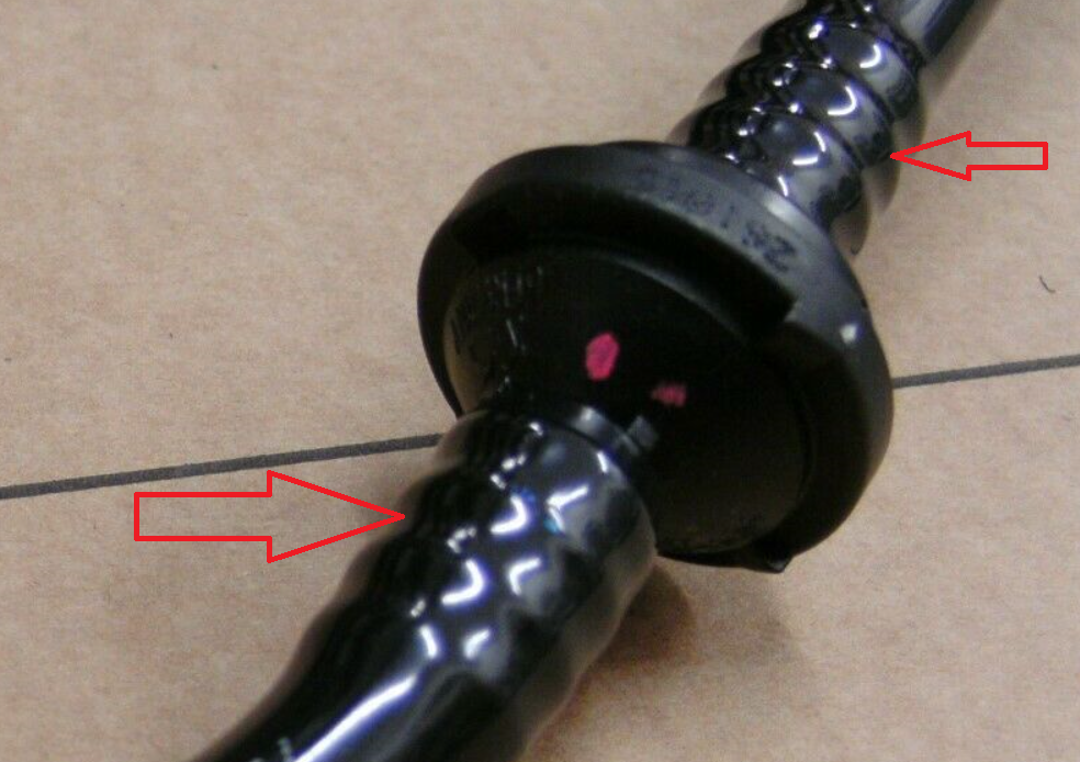

  • Problems with the servo vacuum hose tend to be at the junctions of the hard plastic pipe, especially either side of the non-return valve:

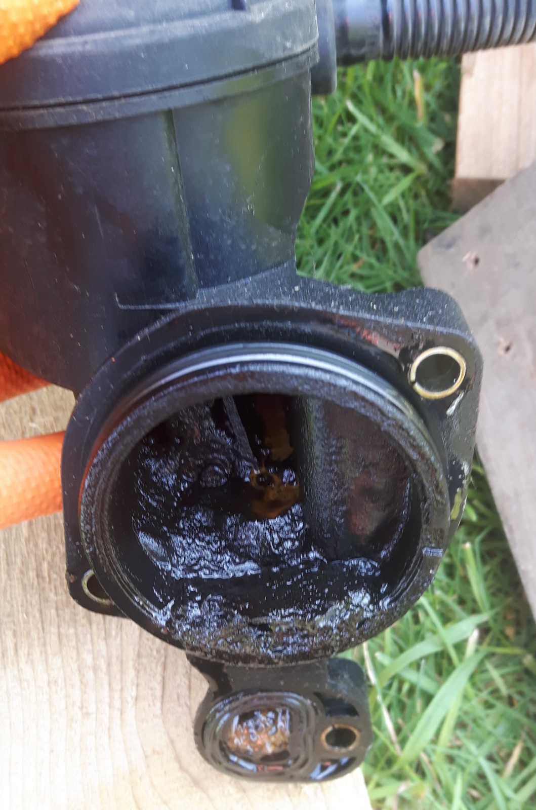

Pressure in the crankcase is generally a sign that the breather module on the back of the engine block is not doing its job for some reason. It's the part in the orange ring in this photo:
That is held on by three or four M6 screws, Allen key H5 fitting.  Probably this is blocked up with degraded oil as a result of previous maintenance neglect (lack of oil changes).  They can get very blocked up; replacement is probably the only real solution as they have complex internal passages that will be almost impossible to fully clean out

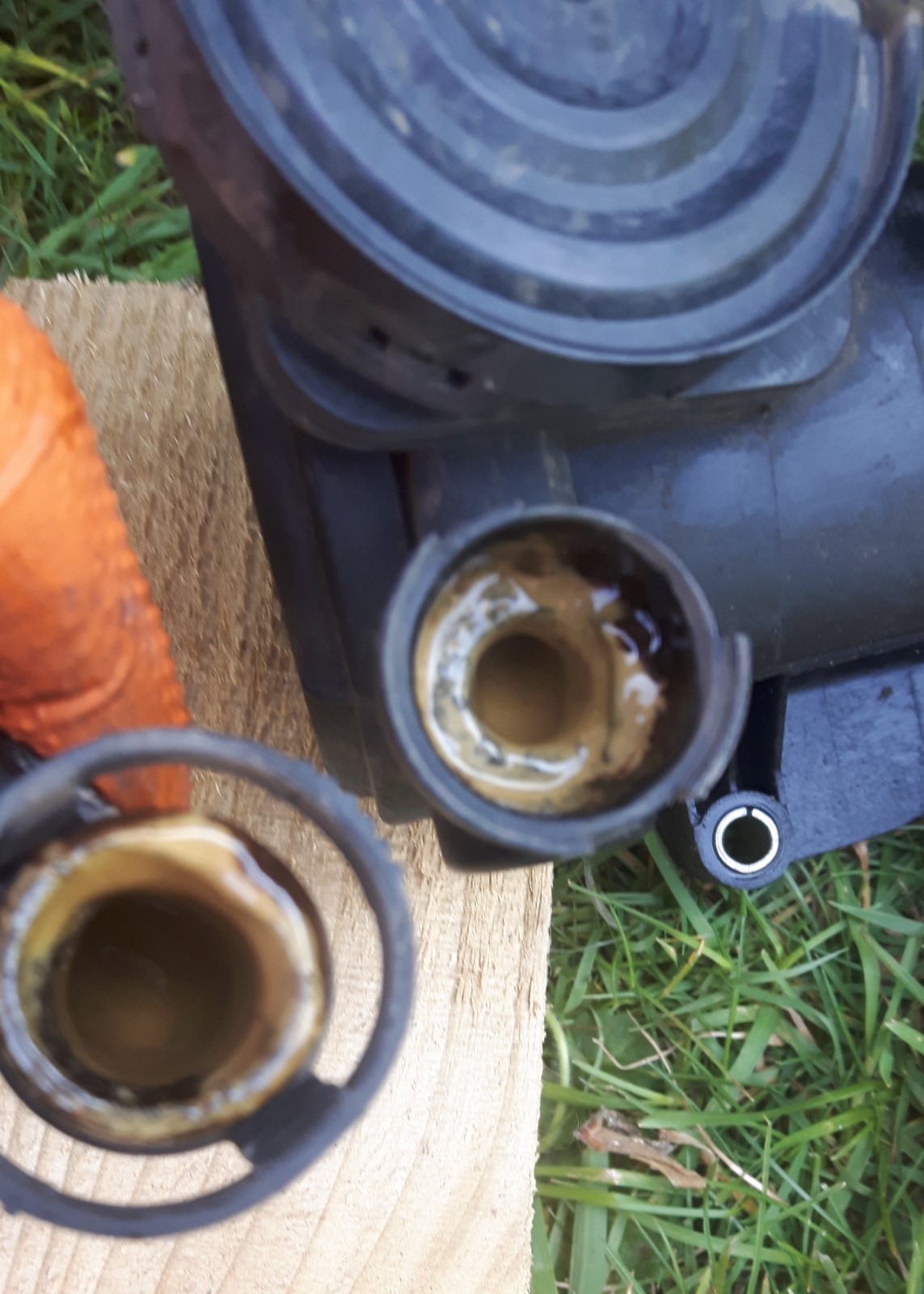

2 hours ago, Pete1 said:
You have probably discovered by now that the problem with looking at the condition of this is the access to get to it; not easy. ☹️
Managed to get to the breather(unfortunately my phone battery was low so couldn't get any pics). As you said it was blocked, cleaned it up since it was too late to get another one. Ran fine for about 3km then started smoking, loss of power and hiccups, no engine light but I diagnosed n came up with p0171, now it's burning more air😂😂, removed the battery to reset it. I will see it in the morning. Any suggestions?, I replaced the injectors just a month ago.

p0171 might also be plastic brake servo pipe split, and that would also match the awful running once warmed up.

Thanks for the reply mate, where can I locate the servo pipe?
