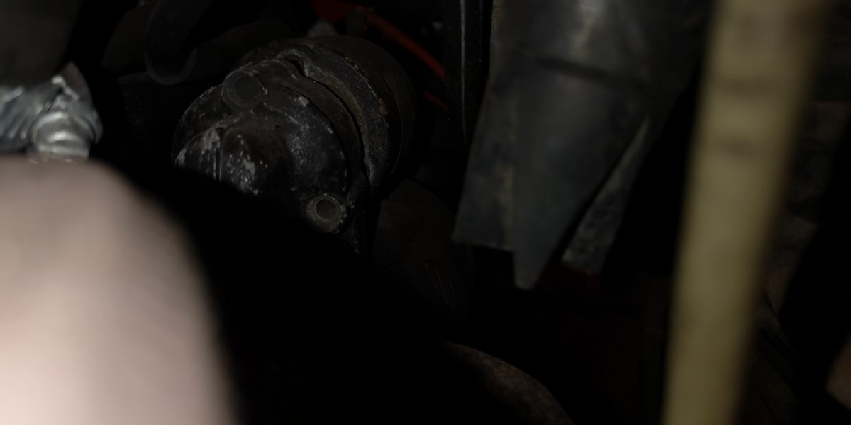

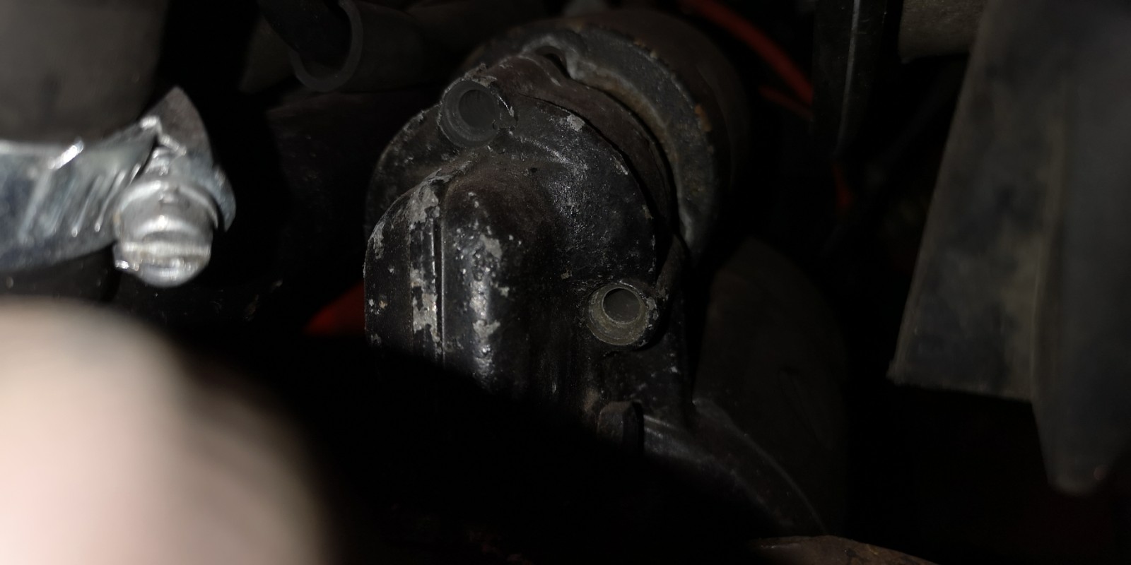

My apologies, Must be 13 right enough, I'll go get a pic...
Bit of a nightmare to get a pic of.😅
Any ideas where I can buy them new? Google came up with two UK websites but they are both out of stock!
