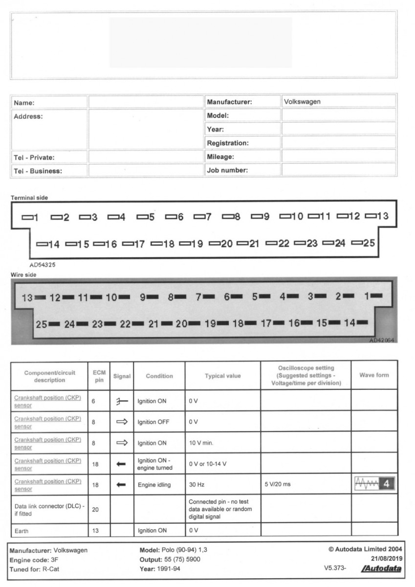

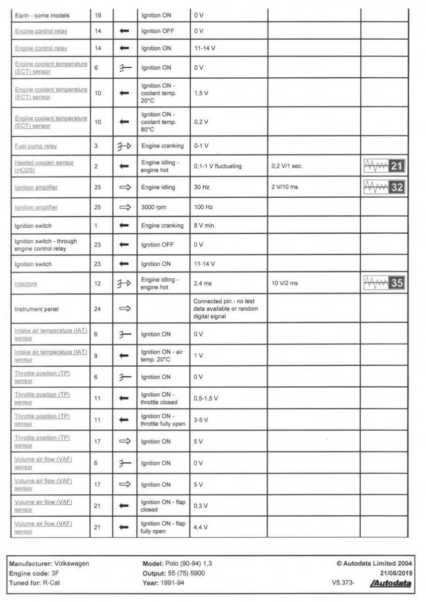

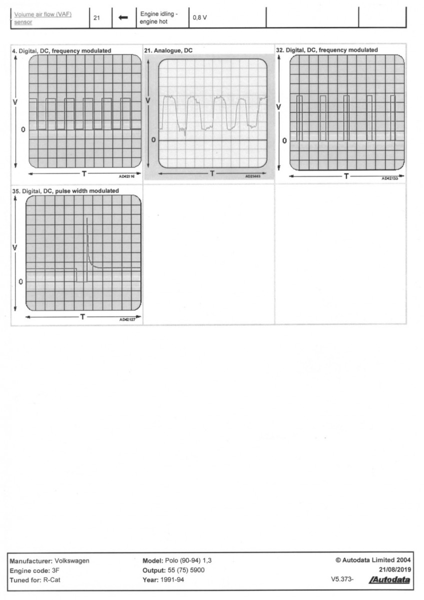

  • Have look at this https://www.clubpolo.co.uk/topic/357601-engine-idles-down-and-cuts-out/?tab=comments#comment-2728598I I've attached the printout from Autodata on what values you should have at the v

Tested the AFM, TPS and coolant temp sensors against the autodata that Nige has posted, great help thankyou!
I used a bit of wire and hooked the threads between the relevant pin of each sensor and the plug, rather than backprobing, far more reliable and easier to do!
All the values that came back were very close or the same except the AFM intake air temp at 20C and the coolant temp sensor at 20C, both read slightly off the values on the autodata. Especially as they got colder, I monitored engine temp  using a handheld laser temperature gauge. I can give more specifics if people want to know. So given the symptoms of the problem when it is cold started and overfuelling, I swapped out the AFM for a spare and replaced the temp sensor.
