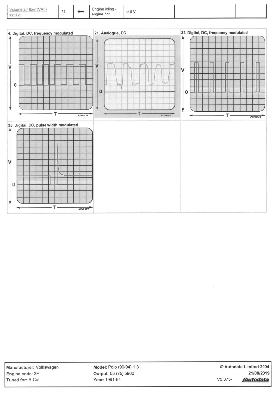

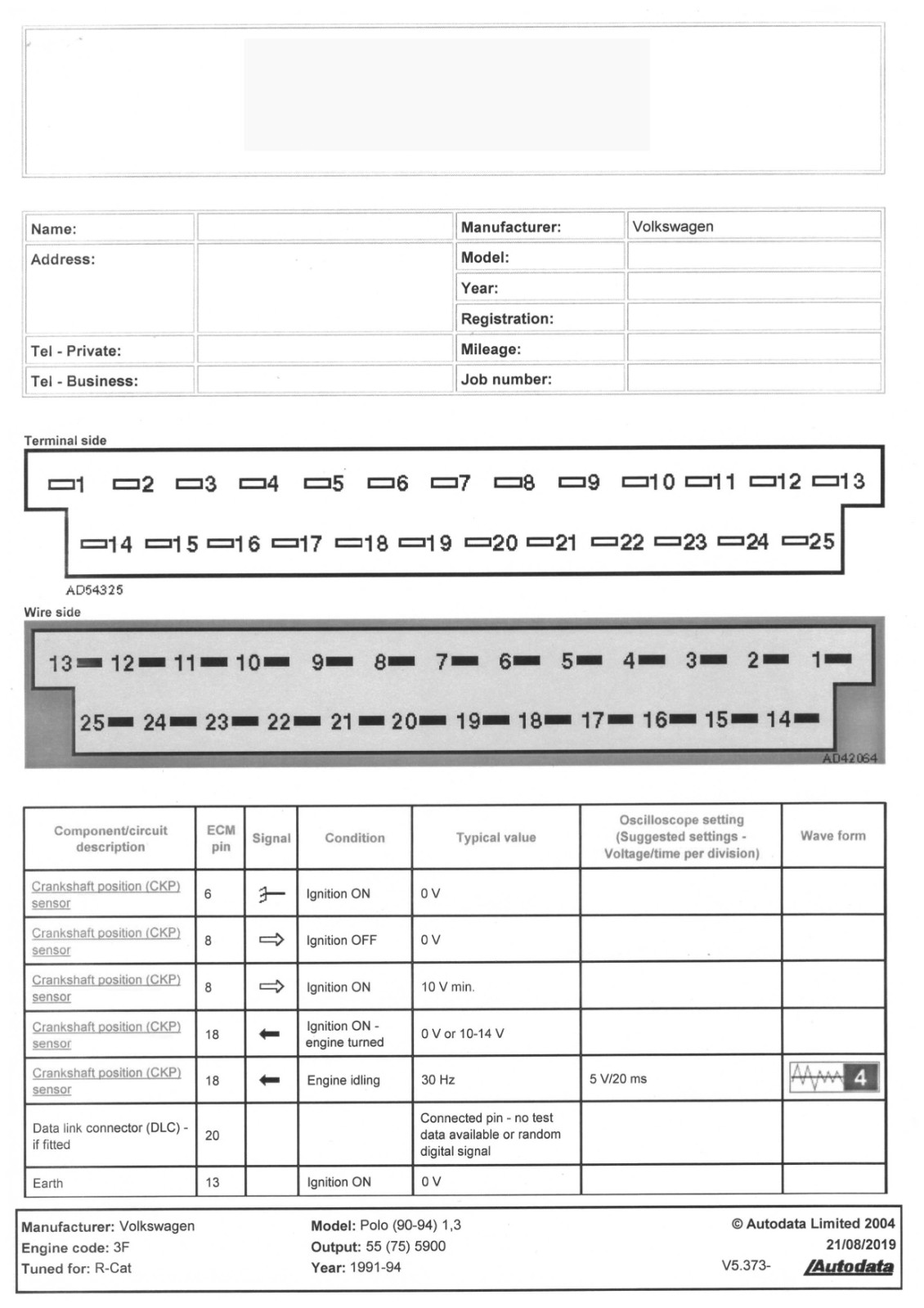

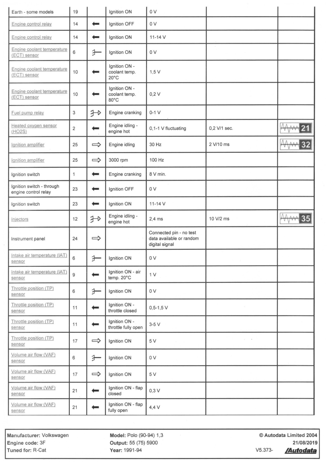

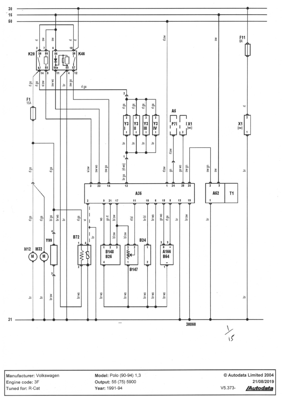

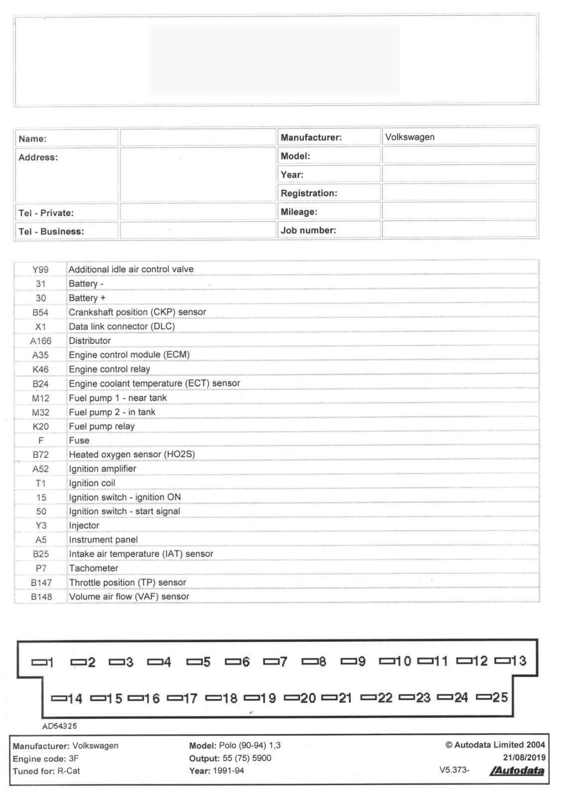

  • Have look at this https://www.clubpolo.co.uk/topic/357601-engine-idles-down-and-cuts-out/?tab=comments#comment-2728598I I've attached the printout from Autodata on what values you should have at the v

  • They represent whether the signal is an inbound signal from a sensor/power supply etc or an outbound signal to a unit/actuator etc

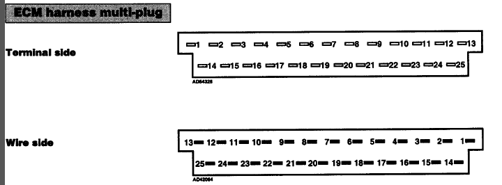

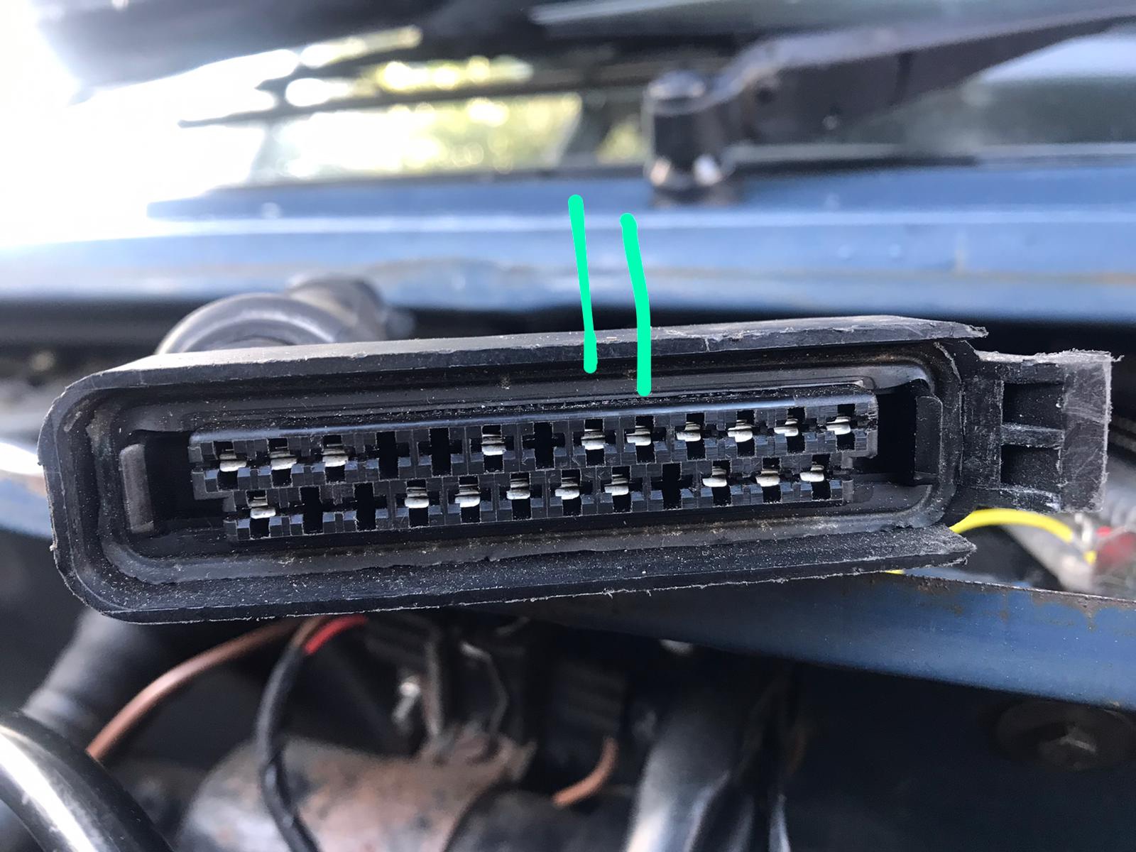

I’ll post a pic of my ECU plug and hopefully you can tell me the right connections to test! 🙂
does 8 and 9 on my plug correspond right to the pin out diagram?

With engine cold I have the MM on 20k Ohm setting. It’s reading 4.1 at the plug.  At the ecu harness, according to terminal side diagram connections 6 and 10 are the temp wiring, and they read 4.1 too.

I'm guessing that (if correct) 6 is the shared earth (brown/white wire) and 10 is the signal wire straight to the sensor then. Sounds unlikely that you've got a duff connection then which is good.

Have look at this https://www.clubpolo.co.uk/topic/357601-engine-idles-down-and-cuts-out/?tab=comments#comment-2728598I I've attached the printout from Autodata on what values you should have at the various pins
Yeh spot on thanks. Dumb question - how can I check connections on the wire side of the ecu harness when it’s plugged into the ecu?
