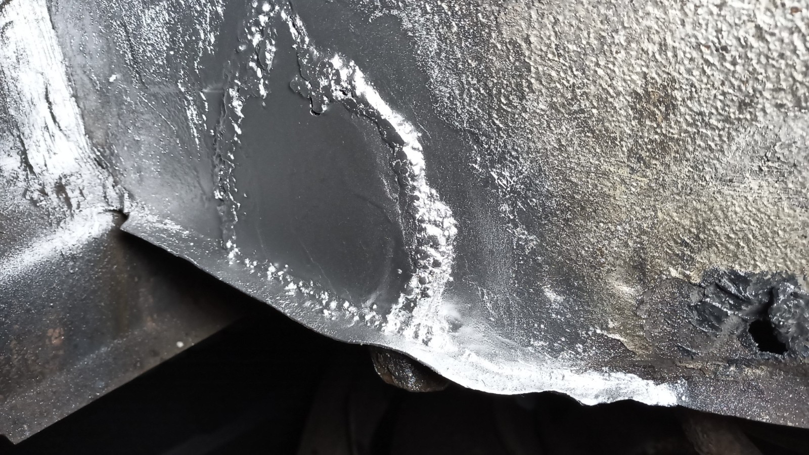

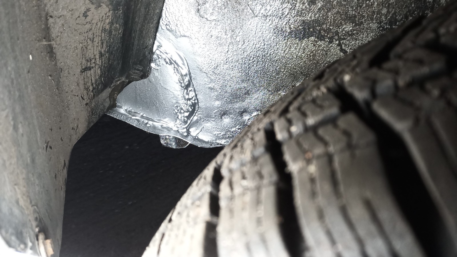

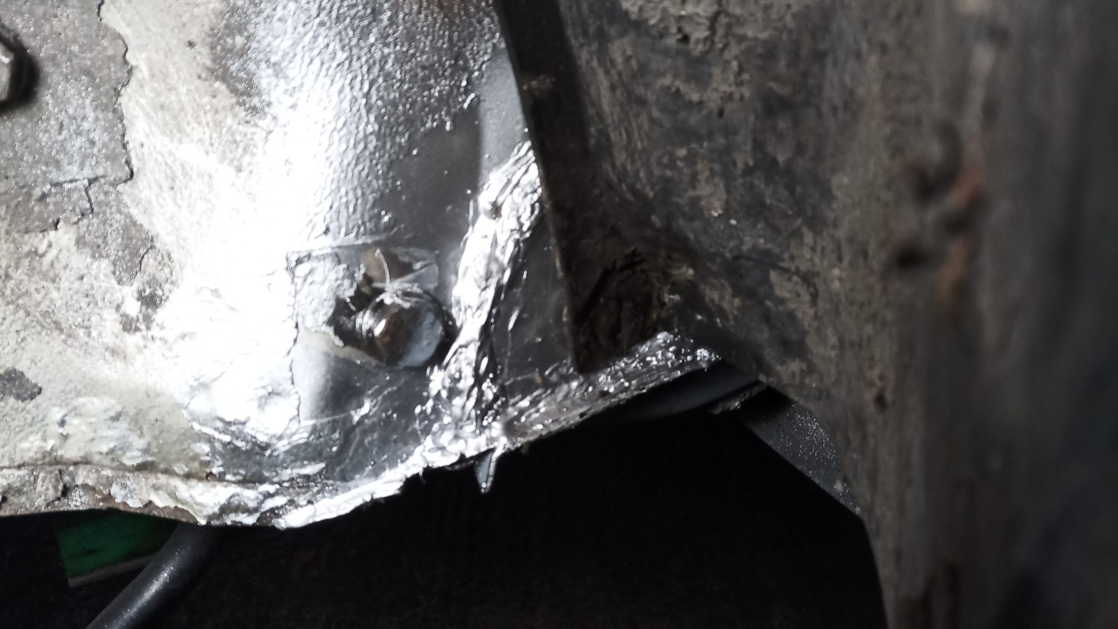

Grinded smooth-ish. A few tiny holes revealed on the other patch I did first on offside of the car, which was not as neat (no picture).
Reason  - my welding rods had got damp in storage so were stocking not sparkling. Dried them in an oven at 150C for 20 mins.
Still feels very solid. Might go over those holes with the spotwelder rod.
 Primed the ground surface in Zinc-182.

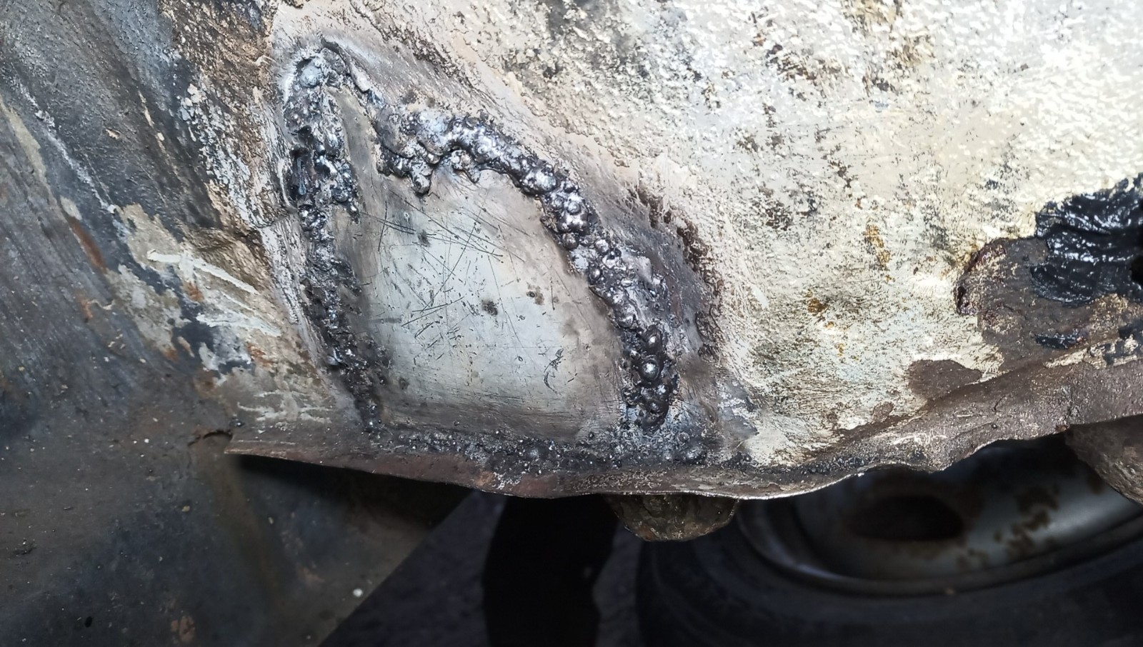

Some more grinding and welding rod touches later.IMG-20201206-WA0006.thumb.jpeg.d8eeca5f646aa7072c960a915a9a8f31.jpeg
I used some rattle can paint, because it was too cold for the PU seam sealer which needs +5C.

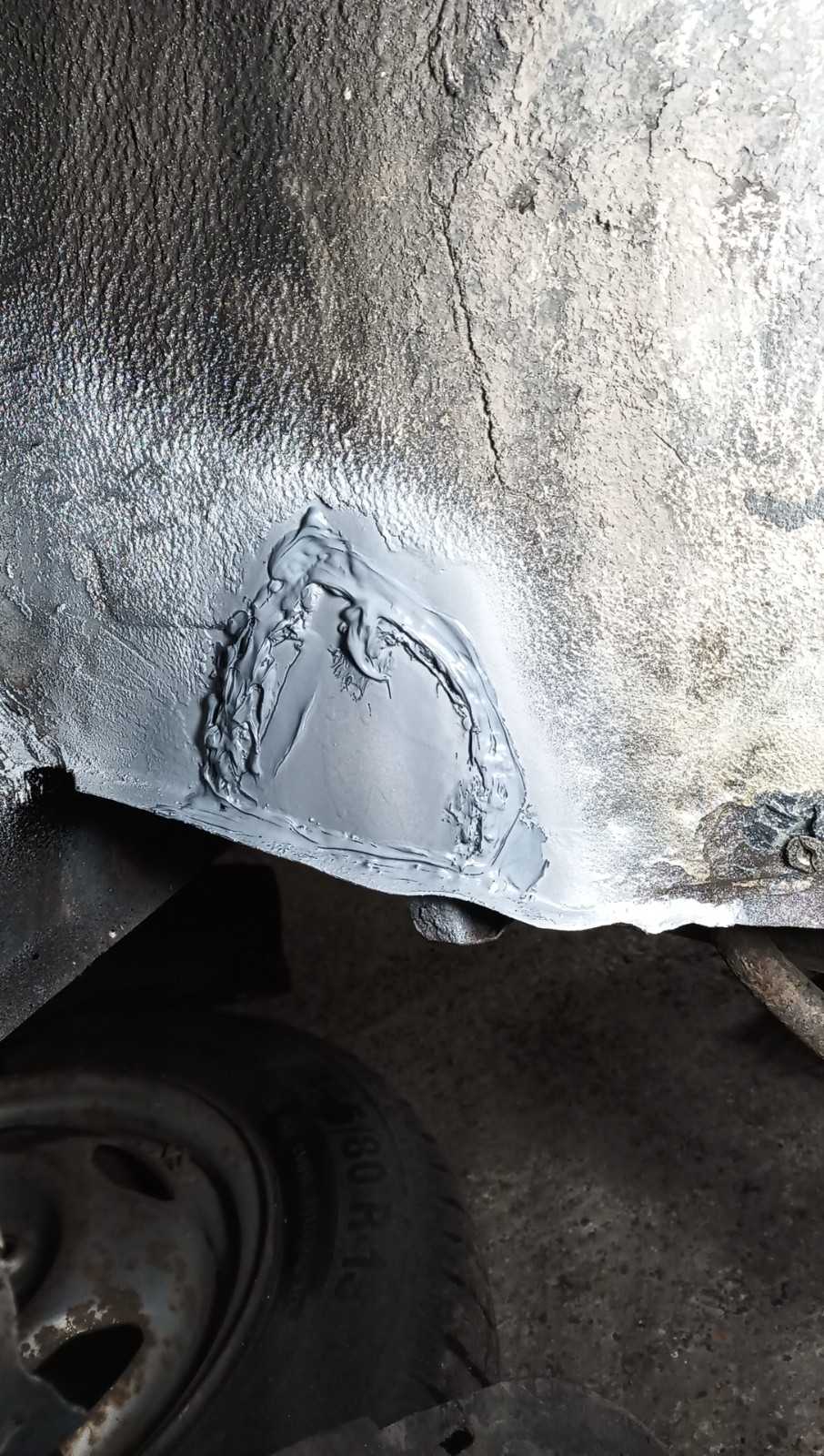

Ordered some grey epoxy 1K primer, not here yet.
Got the seam sealer applied in milder weather and covered again with zinc182.
 It's flipping sticky stuff. Put some on other awkward side (and got some in my hair in the process 🤪. Undersealed that hidden side.
This side I'll paint one more time.

dvderlm

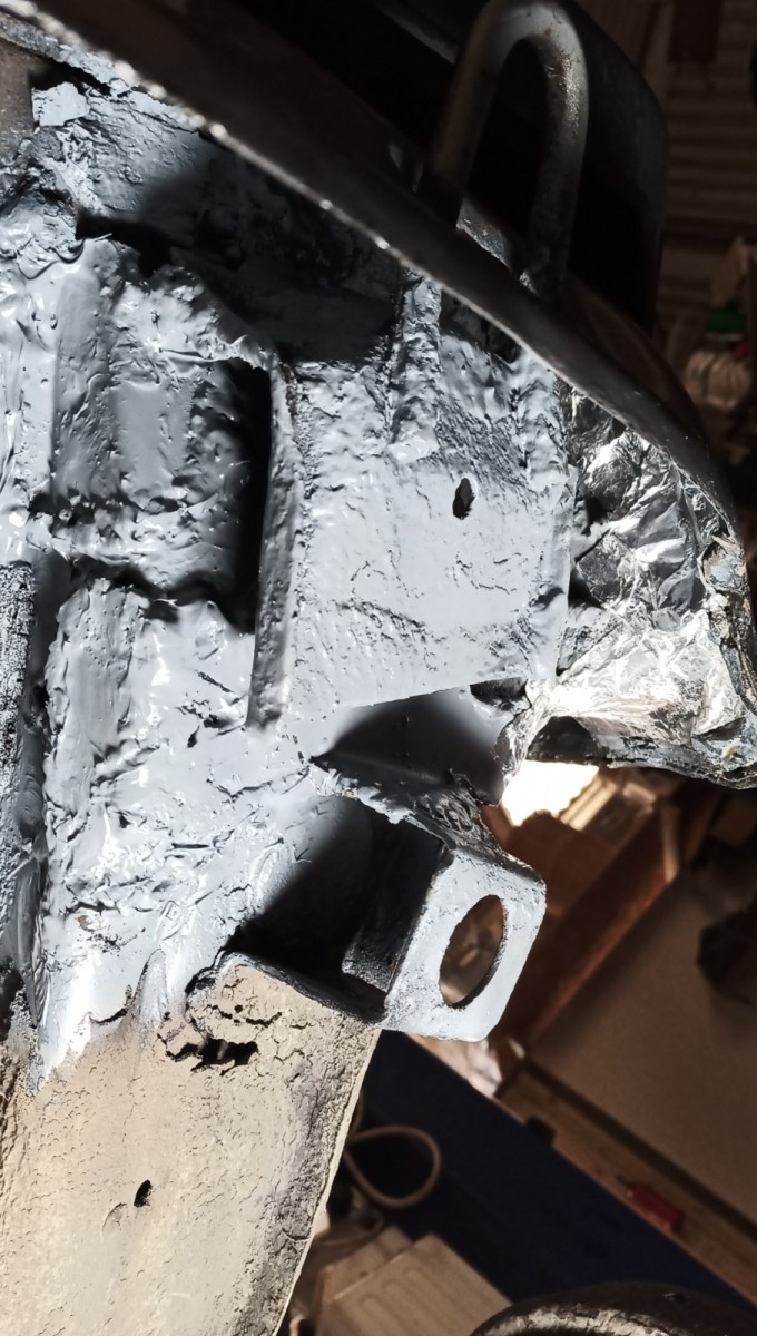

Painted again. Inner arch cover refitted. Wheel back on.
And the uglier side

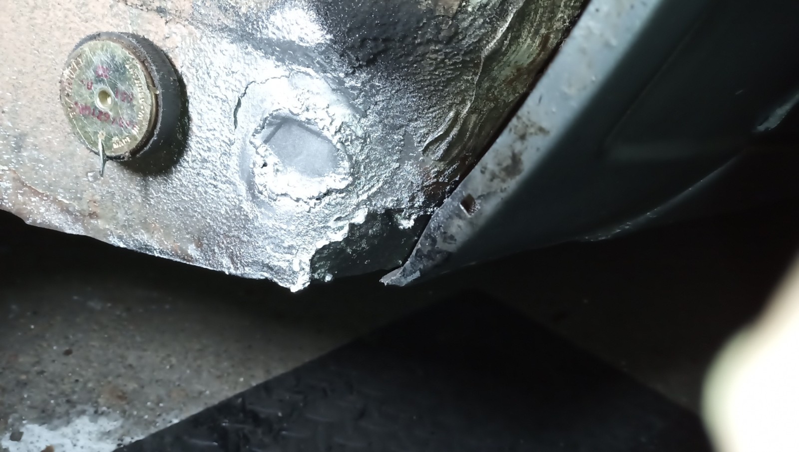

The inner arch cover is sticking out a bit. I might trim off the corner so it sits more flush and maybe a bead of sealant. There was a captive screw here once upon a time. I imagine two different metals of screw and panel helped the corrosion process along.

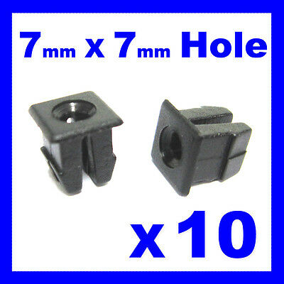

dvderlm
There's threaded square plastic insert things with gaps that will hold onto salty road spray, but the screw and heads are not rusted to bits.
A bit like this
I might switch to expanding rubber well nuts or nylon clips.
Link to post
Share on other sites
steveo3002
yeah i just replaced it with another plasticclip  like your pic , not great most of them have caused rust to start , but i doubt its what will finish the car off..guess they were too tight fit when new and chafed some paint off
i fitted mine with a dollop of grease
  • Like 1

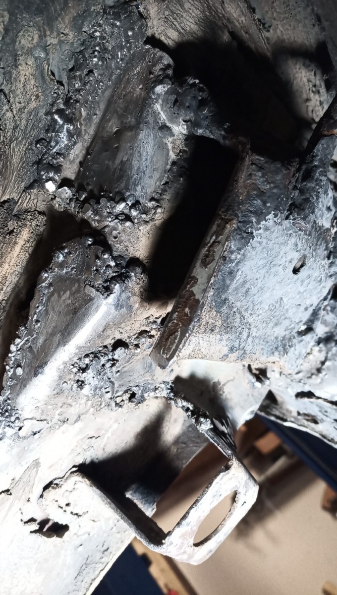

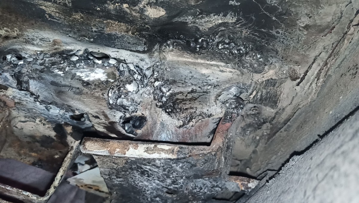

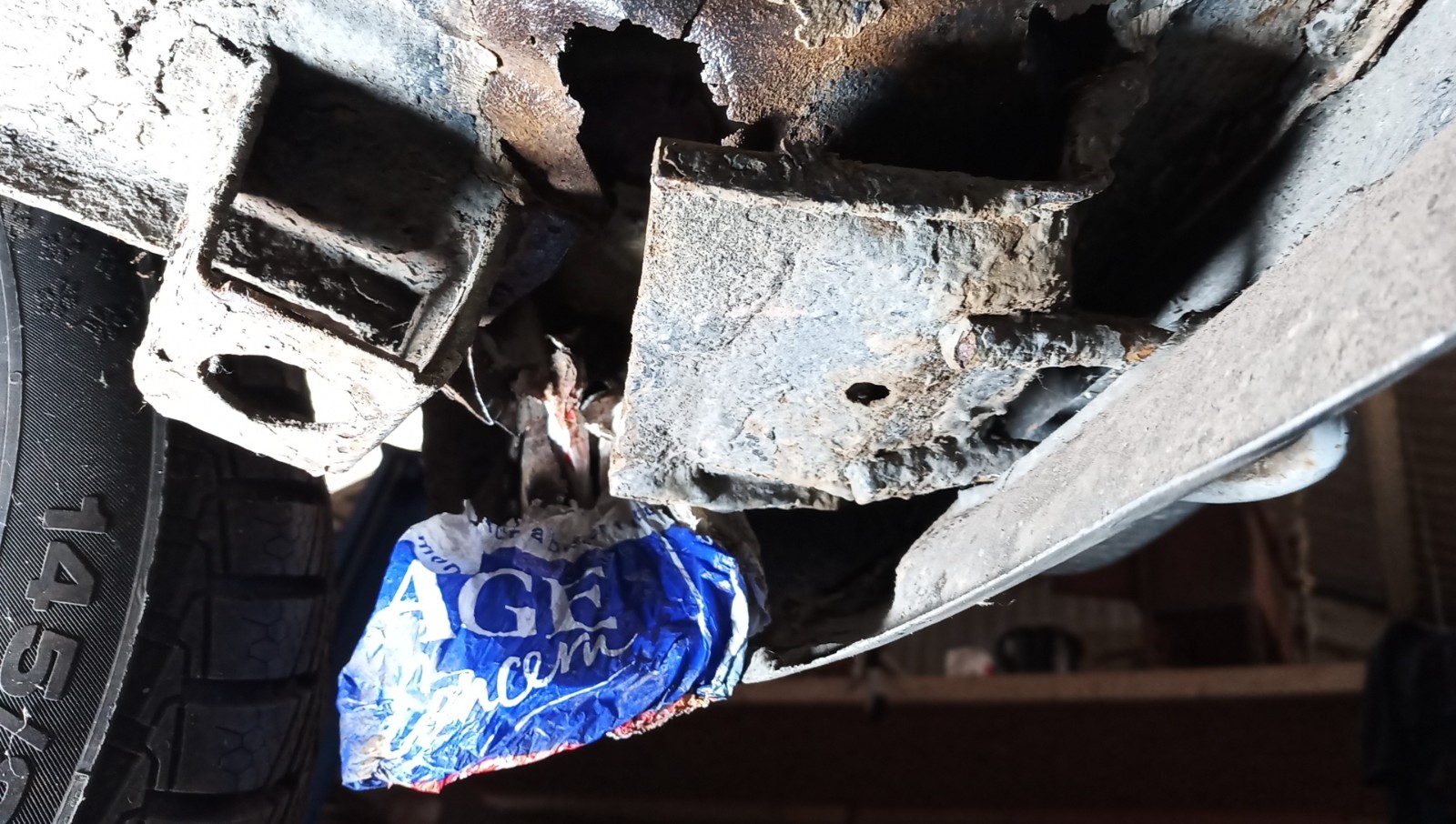

and on to next rust hole. Just an advisory. Rust offside rear.
Found it at rear tow hook. Started pulling away the underseal and filler ... and found a plastic bag in the cavity as a bung for the filler.
The garage who repaired after the rear shunt left me a message.
"Age concern" - thanks Carey!

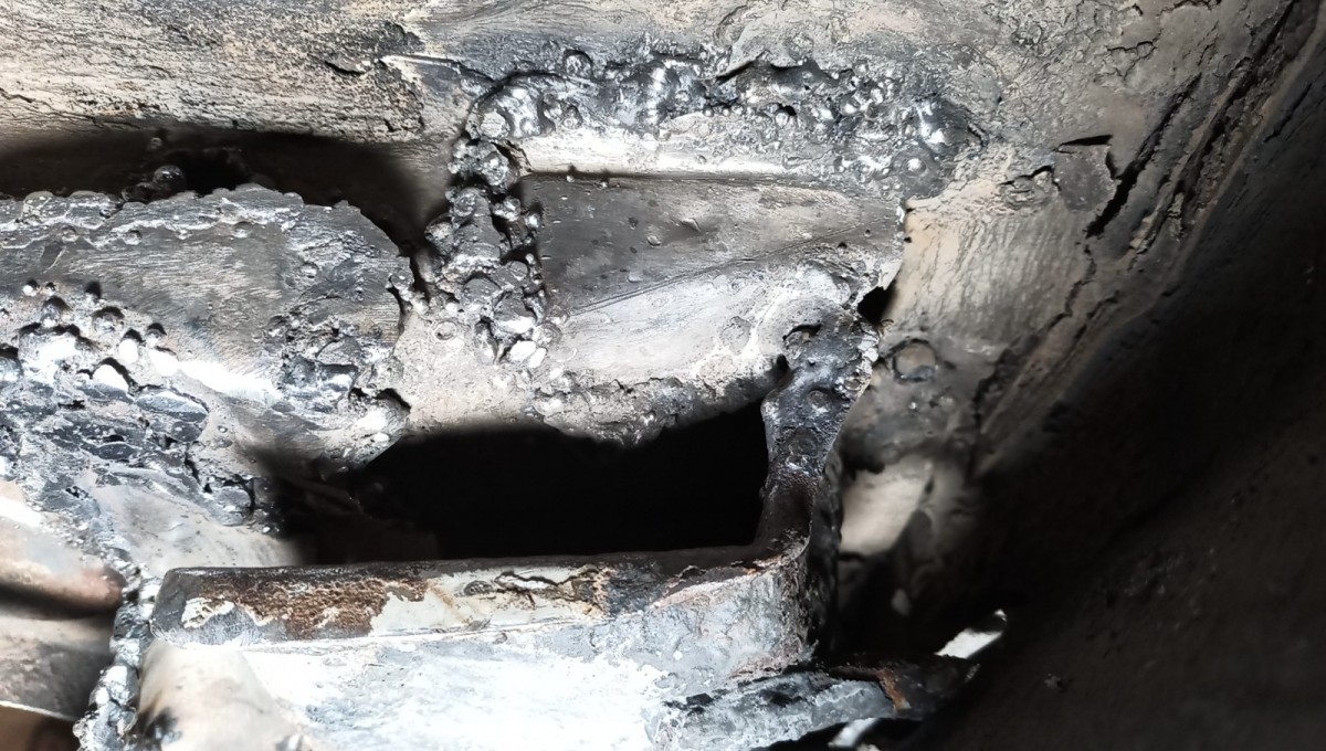

Wire wheeled and filed it as much as I could, then smothered it in Deox gel and
cling-film. The tow loop carrier is not actually very strongly attached.
This is going to be somewhat awkward to weld.

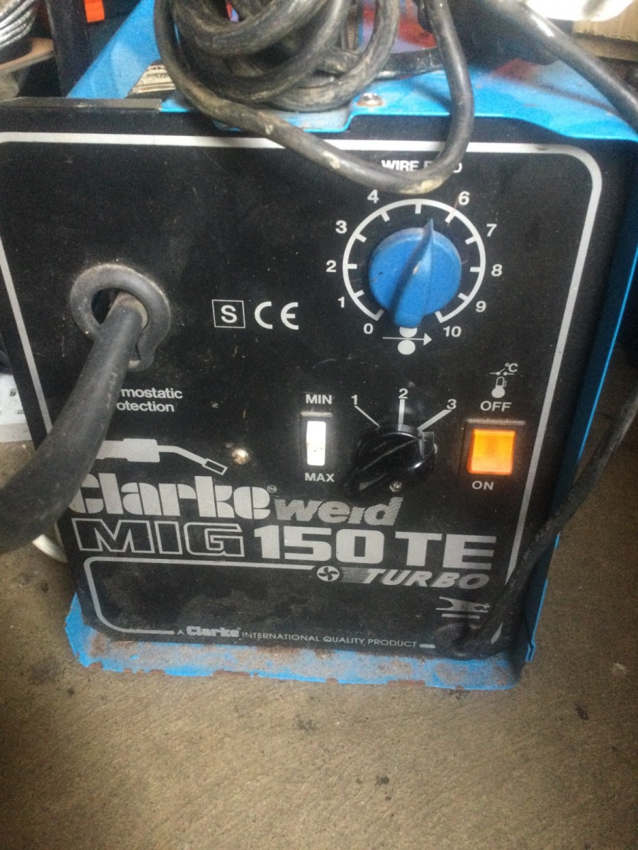

mk2tastic
I’ve a Clarke 150 TE Turbo  gas mig welder which I’ve had for many a year and does a good job, provided you keep the tips/nozzle in good condition.Parts are still easily available through Clarke and fleabay too.It’ll weld just about anything.
