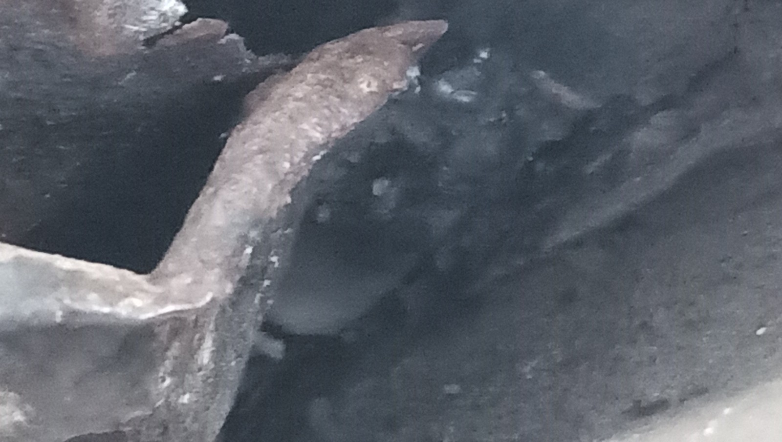

Prepped with deox gel/clingfilm washed off with water and wire brush and Dremel the edges to clean metal. Ordered a magnetic clamping finger thing.

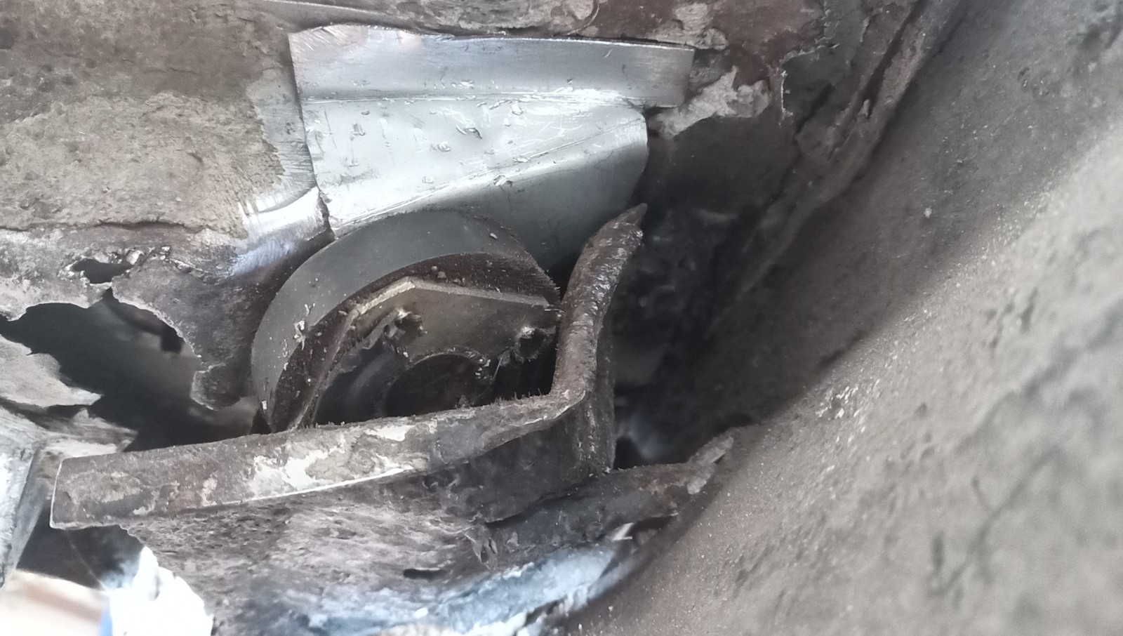

Anyway, here's today's mend with the Kelarc gun at 55Amps with 1.6mm welding rods re-attaching the rear tow loop so it doesn't wobble up and down!
Tried the spot welder but its carbon rod ain't long enough to reach.
Might spot weld from inside the boot.
This took 11 half rods, because of access.
I need a thinner helmet.
Focus not great, sorry.

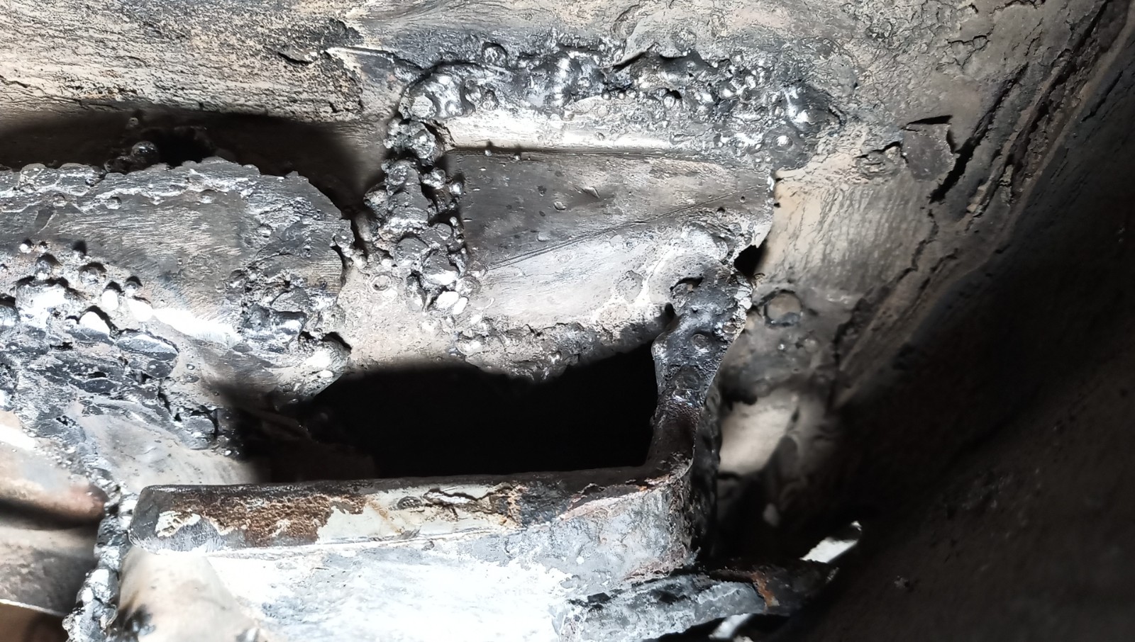

Prepped for some reinforcement.
Ready to tack
Needs some grinding.

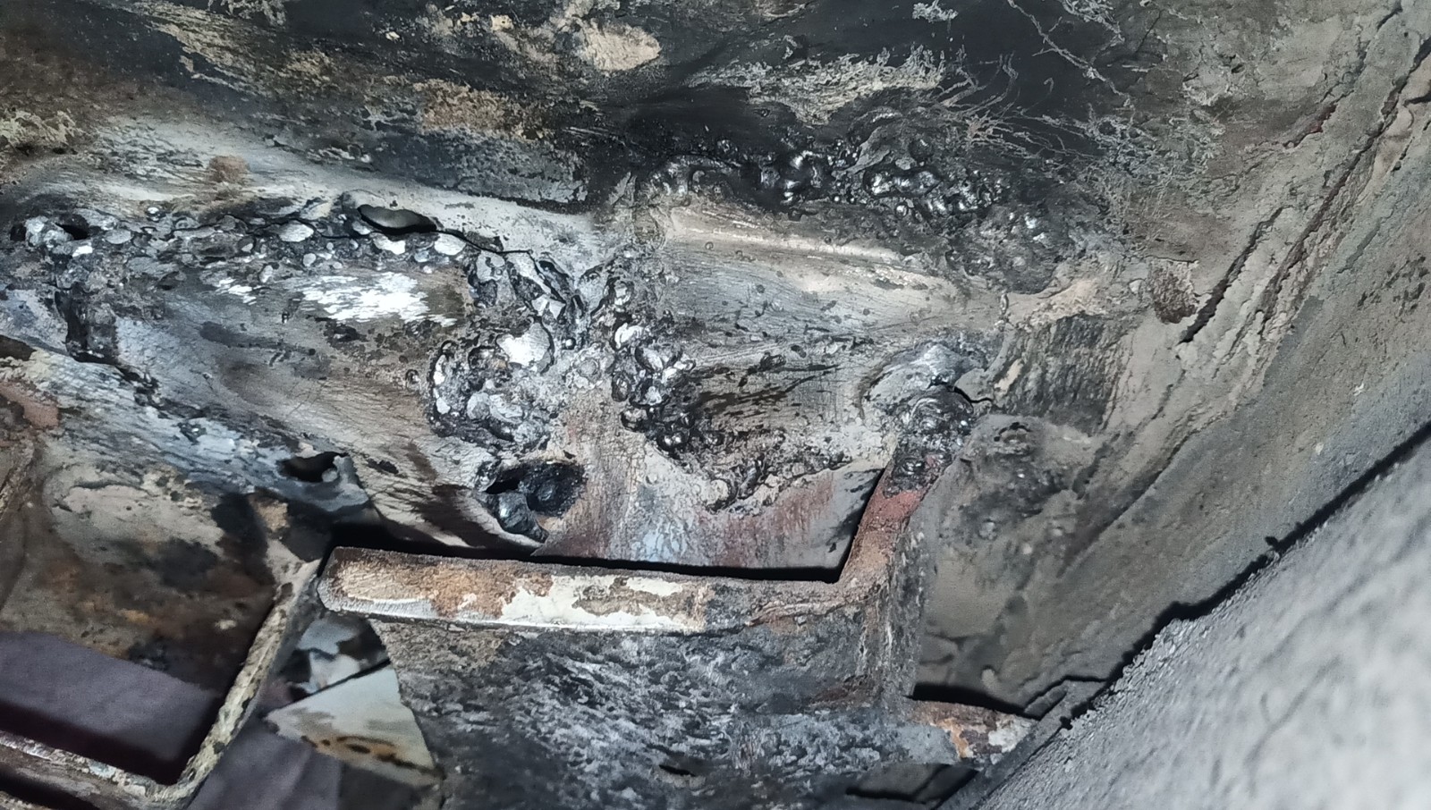

Another repair plate where there was filler and Age Concern plastic bag.
Going to fill around this.

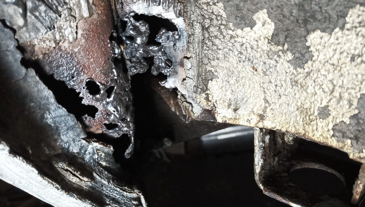

Blowing holes in the really thin rusted-the-other-side metal of the arch.
Guess that needs even lower amps...
Repairing thin sheet steel is an absolute mare with a Mig, especially when it’s old and rusty, getting it clean is the worse thing.
I’m also forever twiddling with power and feed settings to prevent blowing holes in it.
I can't go below 50amps on my arc welder, but at least I never have to fiddle with wire speed using the Kel-arc pistol and rods.
I had cleaned metal for the earth clamp right near to the back where I was working.
Maybe I'll connect the earth clamp to front of the car next time for a bit more resistance.

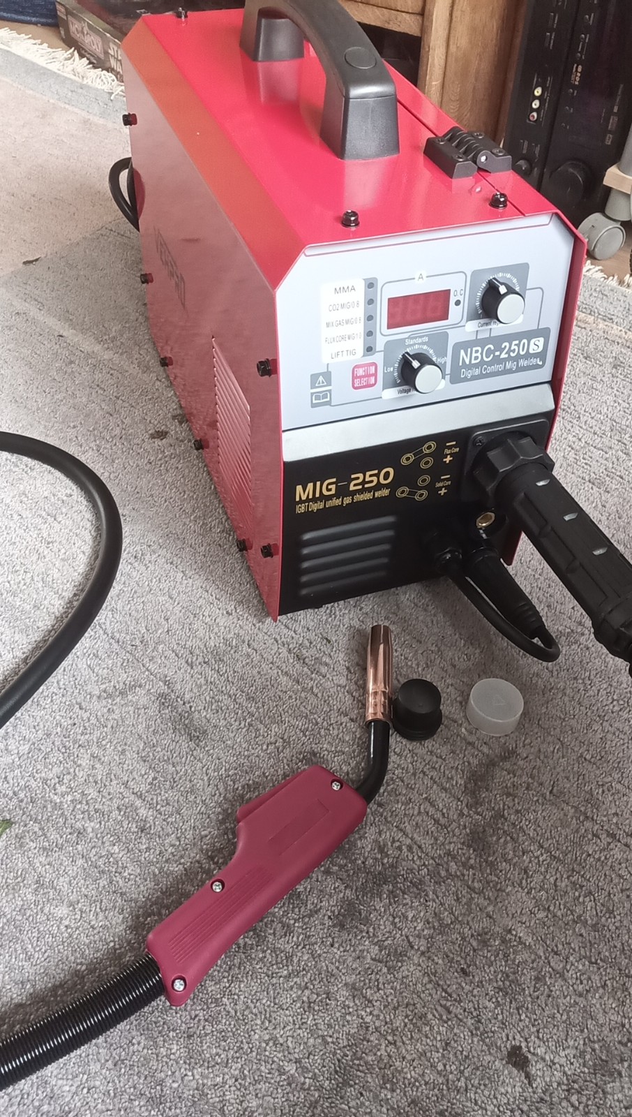

But anyway I relented and bought an invertor MIG that can do Gas, Gasless (fluxcored) with a Euro pistol,  or MMA with sticks  - or Lift TIG with a different gun.
Still waiting for gas and regulator and 0.6mm wire to have a go with gas.
Some 0.8mm flux-cored wire on the way too.
Think I need some 0.6mm tips?
The current can be set low for MMA (so I can try with the Kelarc until those arrive) and the volts and current is adjustable for MIG. Wire speed is automatic according to power. It even has different setting for CO2 or CO2/Argon mix.
Tried some stick welding with this new machine. 38amps will still arc with just a stick, but is happier with 70ish. There's a nice non-sticking to workpiece feature but it interferes with the Kelarc gun a bit.

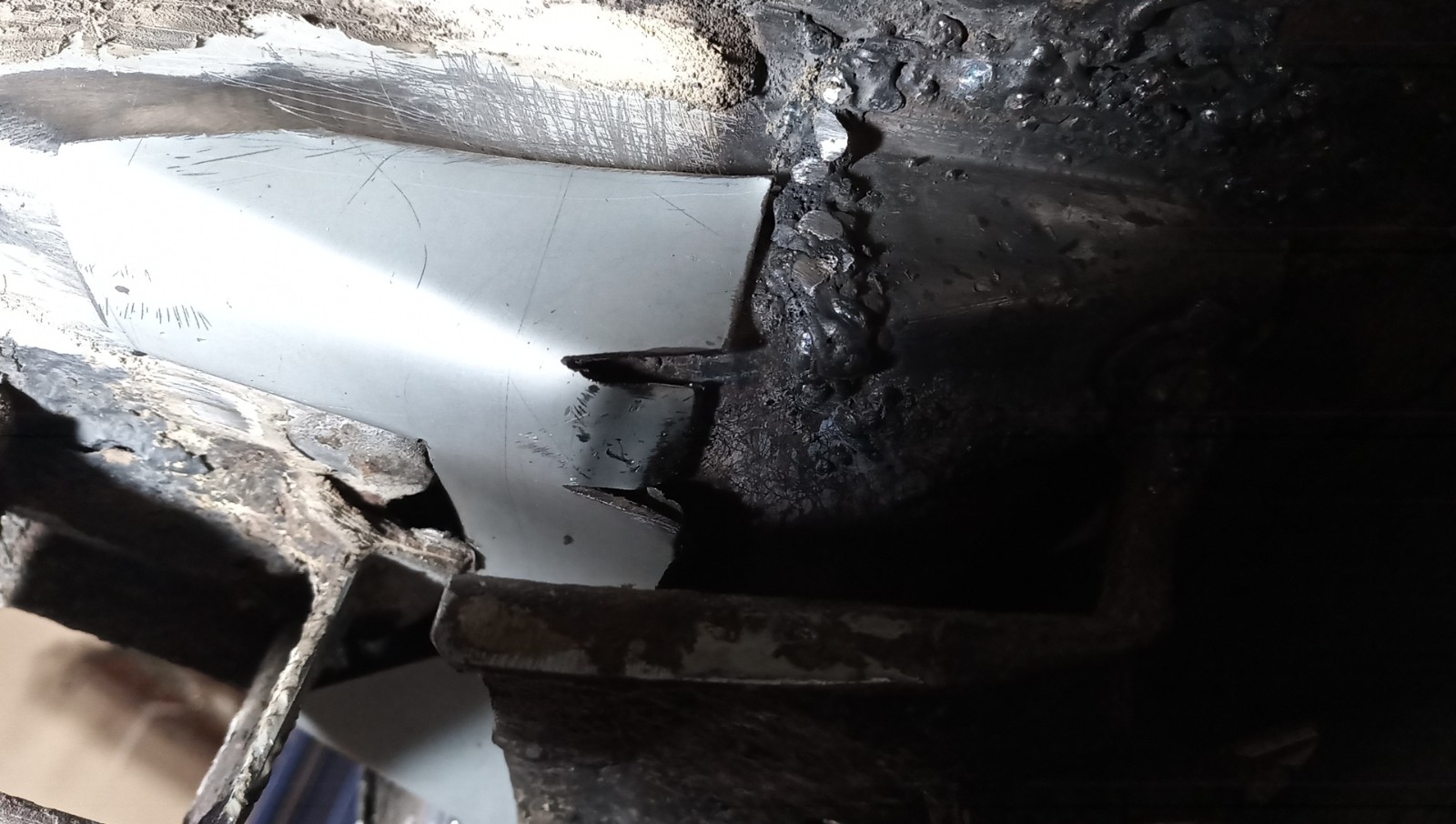

Stick welded and grinded a bit.

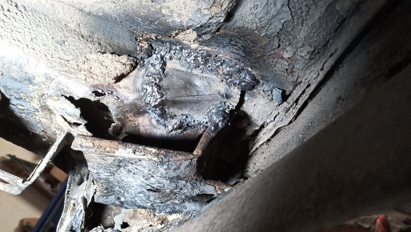

Tacked repair plate number 4 in place with rods and Kelarc.
Didn't think to buy a 0.6mm knurled wheel. Not included either. It's 0.8 or 1.0mm so tried with some 0.8mm flux cored Super6 welding wire.
Nicely vacuum packed reel. Tear off the paper roll. Pull tip of the wire out of the side of the reel. Oh no, welding wire spaghetti bowl as it un-spools itself like some mad robot Italian chef. Why does nobody warn about that?
Eventually just unwound 3 meters and wound that onto a bobbin avoiding kinks and knots. Shoved the reel in plastic box. Fitted bobbin to machine and fed the wire through the feed unit towards gun by pushing manually and activating the gun trigger. Feed mech would operate, clamping wheel would straighten, but not very good feeding.
A-ha moment!
If it says 0.8mm on the visible side of knurled thing, that means the 1.0mm groove is below the wire! Turned it over to be 1.0mm sign showing and that puts the 0.8mm groove in the right place. Super smooth wire feed.
Test weld could join 1.5mm steel sheet really nicely.
Mig gun could arc in controlled manner down to 28amps with no holes, but a bit too slow on the wire feed once doing the awkward angles of the car. Had to feed about 5cm out first and move gun closer while it sparkled.
When the wire would not feed anymore as past the knurled feed mechanism I pulled some more out with mole grips to use about a meter (gun is on 3m lead).
Finally packed up and noticed I'd set Welder for 1mm fluxcore welding not 0.8mm fluxcore.
Welder's much easier to control on 0.8mm wire setting with 0.8mm wire.
Managed to fit the whole 1kg reel without getting a garage full of steel birds nest.

I hadn't ordered a 0.6/0.8mm knurled wheel, because the advert says that is what the welder comes with. But in fact it has a 0.8/1.0mm wheel fitted.
So still not attempted any Argon gas welds.

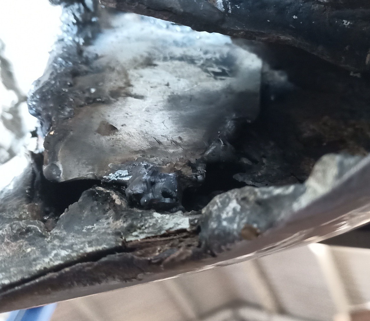

and seam sealed and primed and foil-taped ready for filler
Help me out whats the foil tape for ?
There are holes in the metal that's a bit too thin to weld and nearly impossible to reach behind the tow hook mount.
So as a base for the filler, foil tape can be pressed on and sticks in place. Without it you just push loads of filler through a hole.
The garage who last dealt with this corner used a plastic bag in the cavity.
I've used aluminium mesh before to bridge bigger holes, but it nearly always moves or shows through when you sand.
Once I coated the tape in filler (edges first), sanded it and and painted with epoxy primer I filled the cavity with Waxoyl through one tiny hole at the top. I'll plug that with PU sealant.
