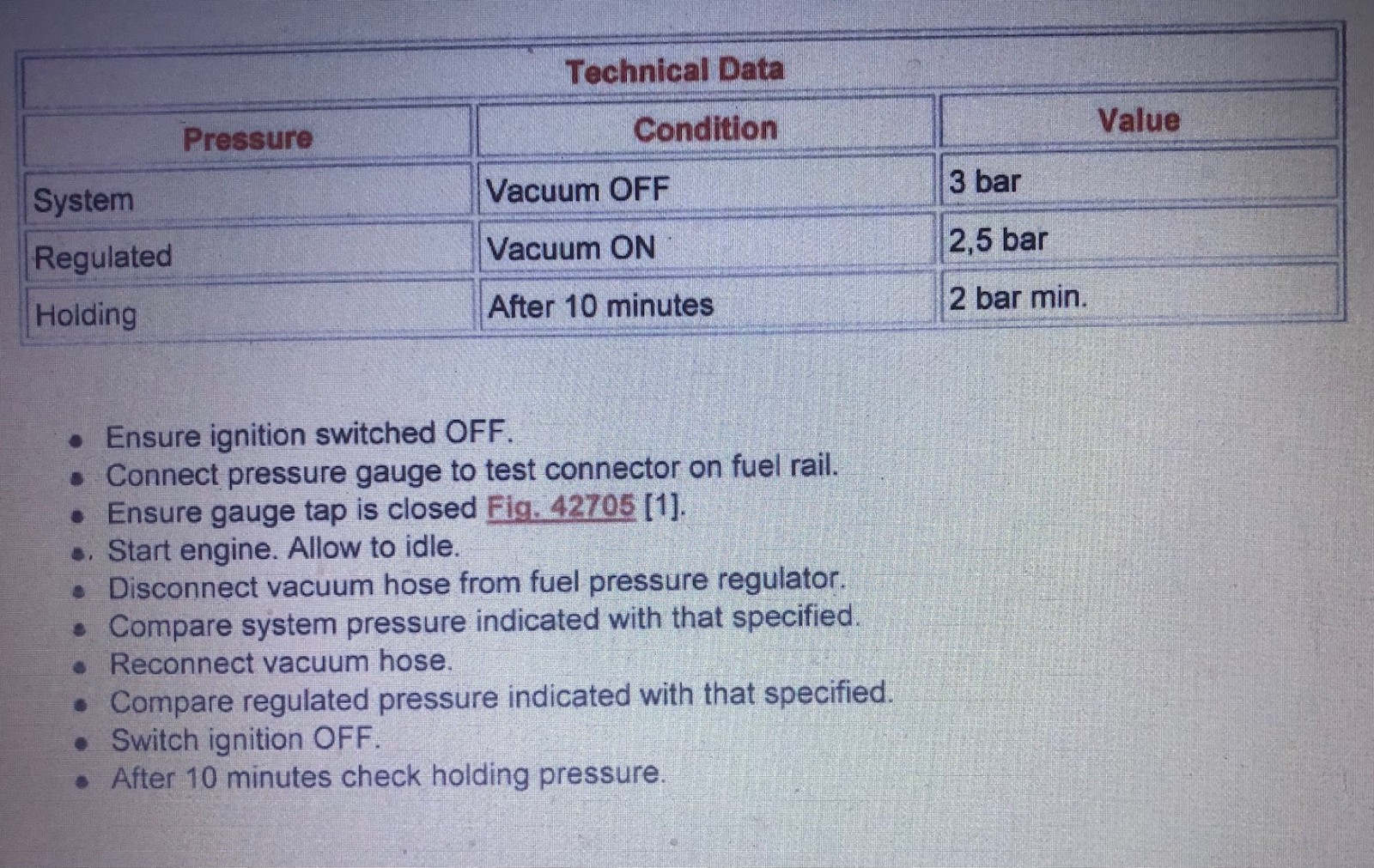

GT 3f fuel pump primes and car runs fine once started. Just when cold and been sat longer than a day it doesn’t start after the first prime, normally 3 primes makes it start first time.
I've tested fuel pressure during the cold start, at idle and with vac off the FPR and it’s getting plenty pressure. It’s like it’s getting insufficient fuel after one prime. But then after second attempt it catches and runs fine. Fuel filter is 2 years old.
I have a spare FPR but before I start looking at fuel pumps and rates etc does anyone have any good ideas?

i suggested the lift pump but the gauge flys around to 3 bar on 1 prime /try
yes they have a lift pump , main pump and a replaceable filter
Yes pressure checks out fine. Might just replace filter and FPR to see. But I’m guessing really. Something to do with lack of fuel, air in the line and not enough fuel going through during first start?
Is the pressure regulating valve holding the pressure on the injectors ? if it's not that could explain the poor starting
Thanks Nige, yes pressure test I did reads well against these values.
