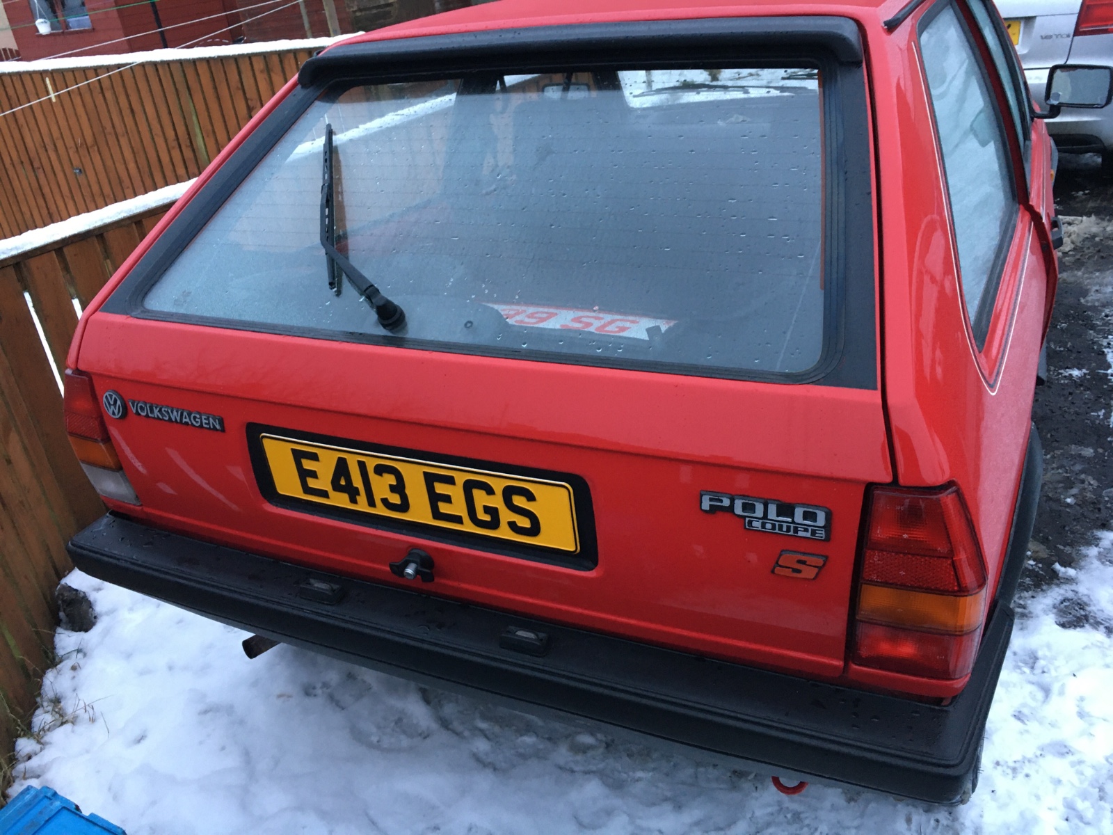

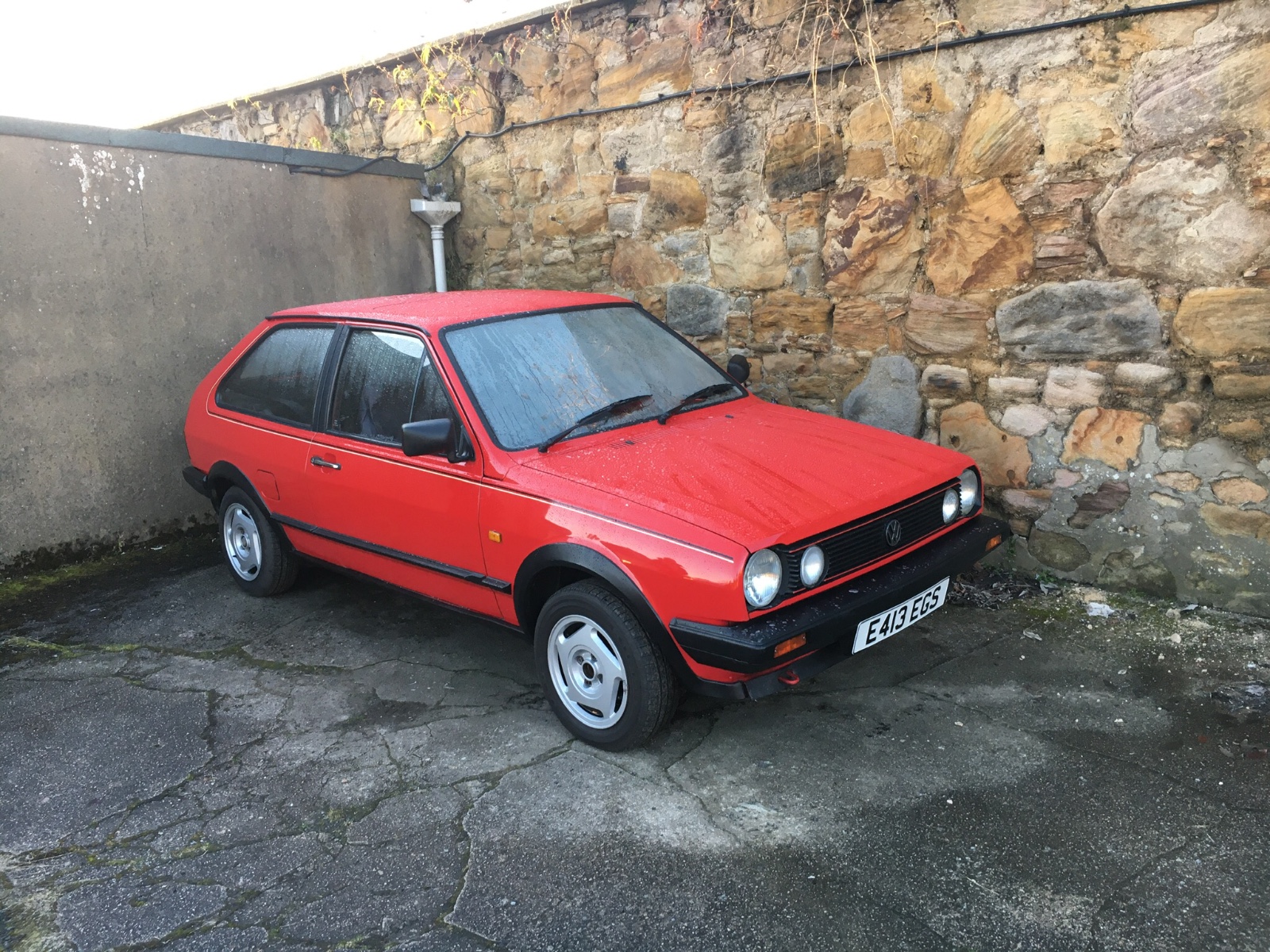

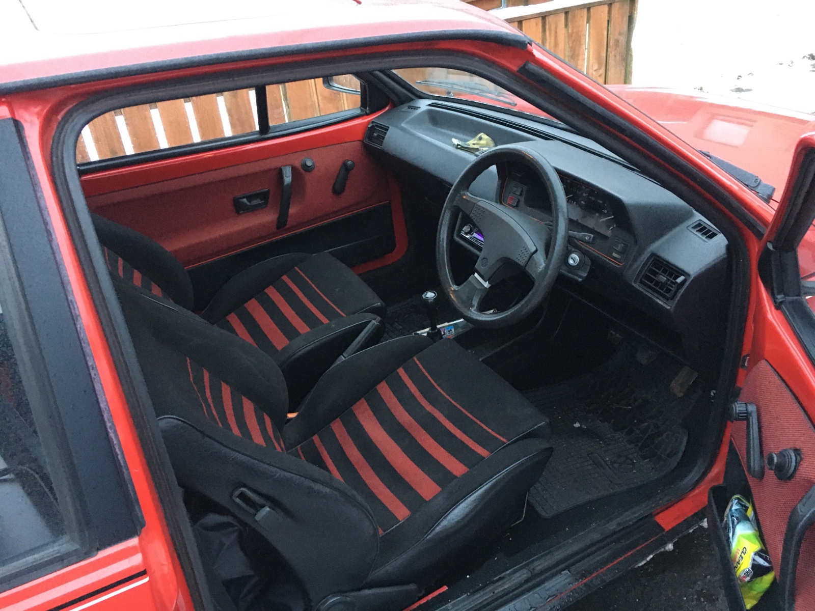

After looking for another polo for quite a while I managed to find this little gem.
The last owner of this had a white coupe up for sale as a project that I was going to look and, however he had a red coupe s in his drive along with a blue gt. As soon as my eyes landed on this I knew straight away I had to get it.
Picked it up fairly locally and off I went.
Here is how she looks just now...

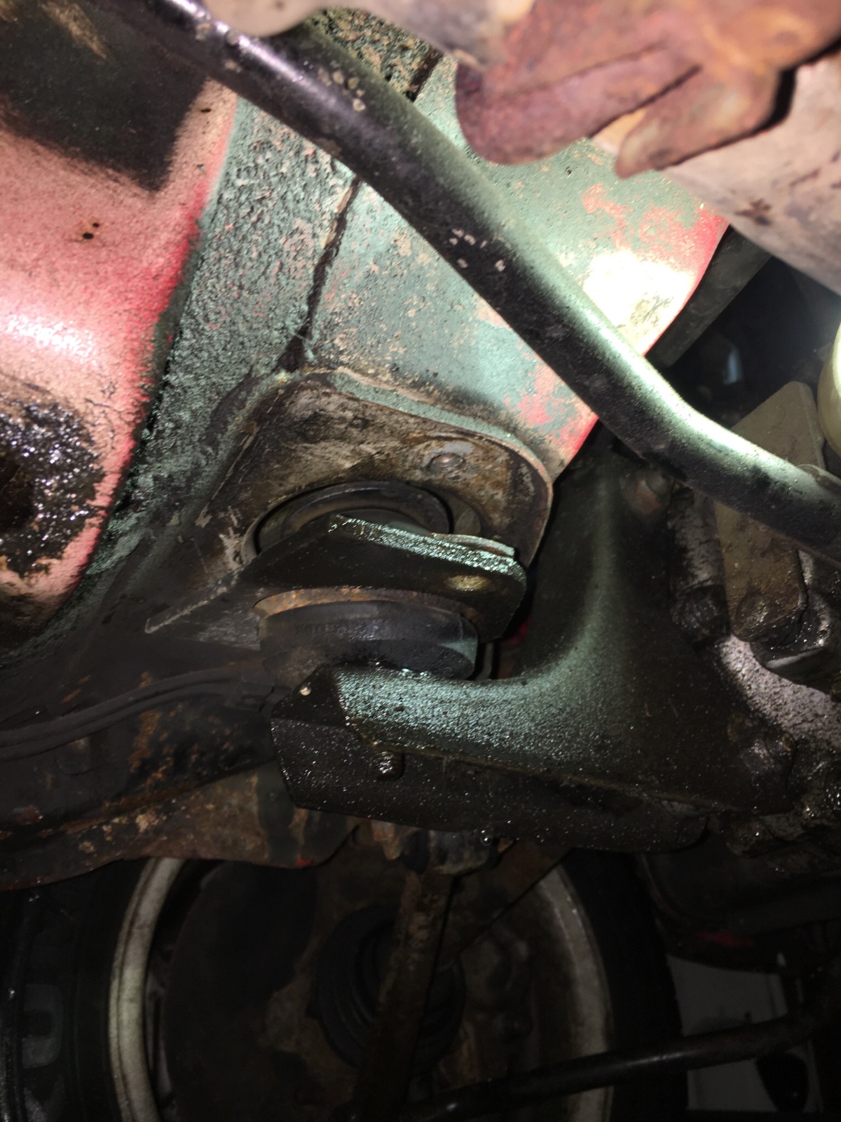

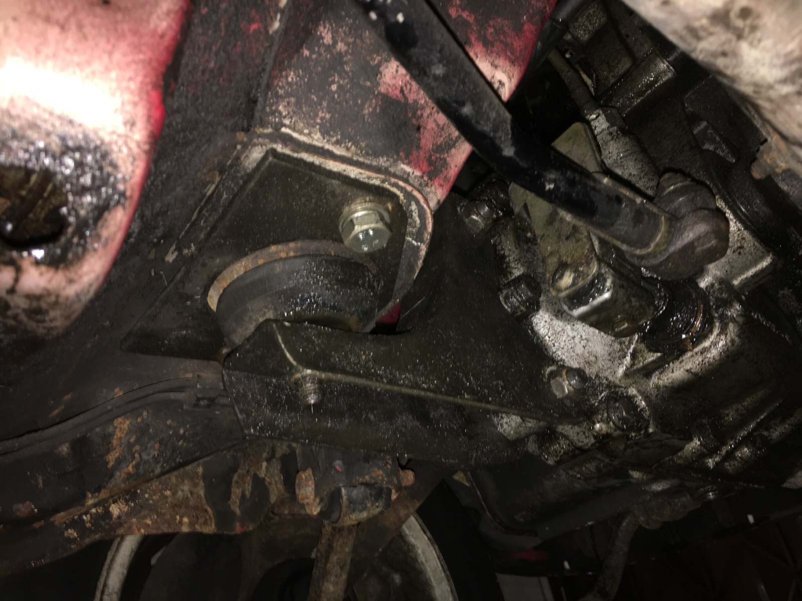

I put the car on the ramp after my work to make sure everything was good, It was not unfortunately I did notice a knocking noise thought gearbox mount was away and found this ...
bolt had ripped though the threads, I tapped it out to an m10 and fitted a new bolt good as new !

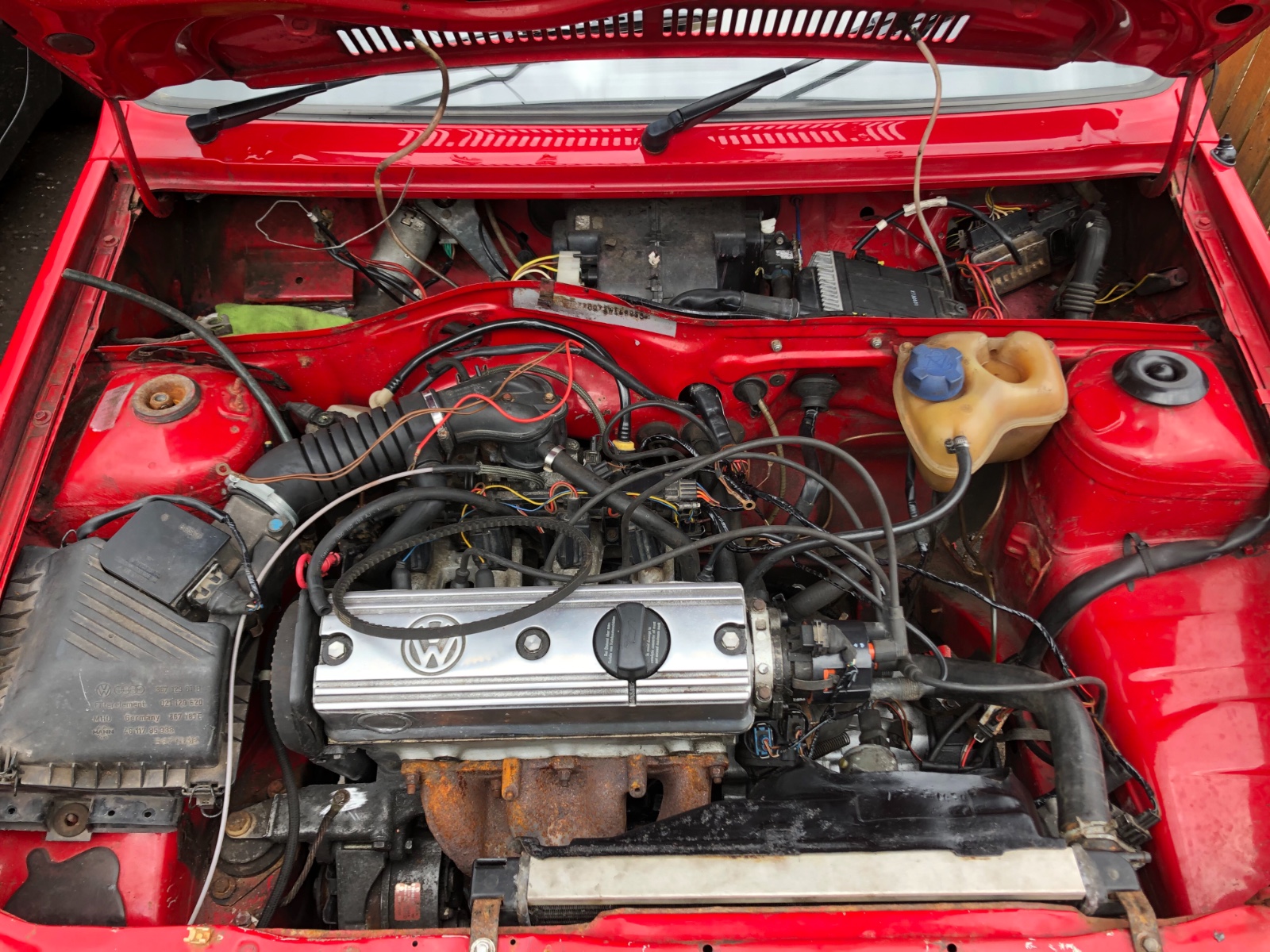

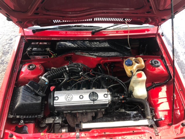

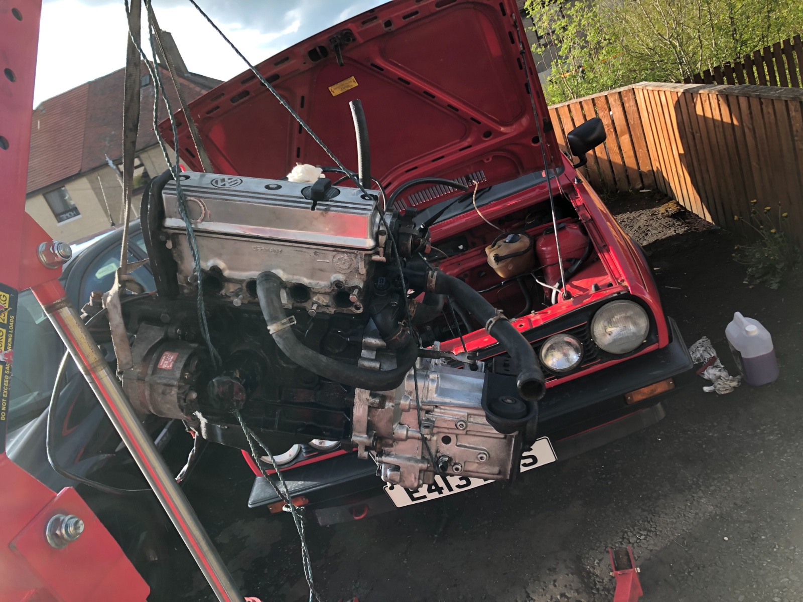

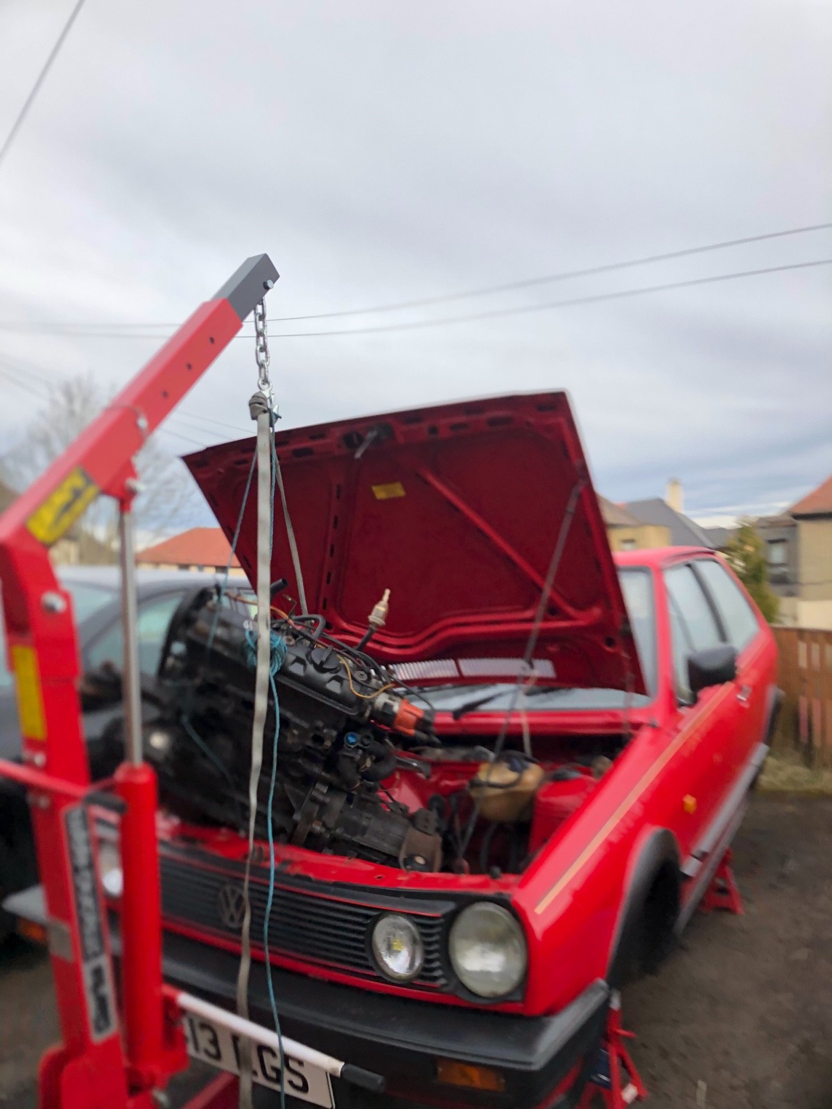

Decided to begin with the engine swap,
Stripped everything off the car and lifted out the engine.
Replaced all brake pipes while engine was out.
Drove down to Manchester to pick up the abd/gt engine and managed to find myself a gt gearbox !

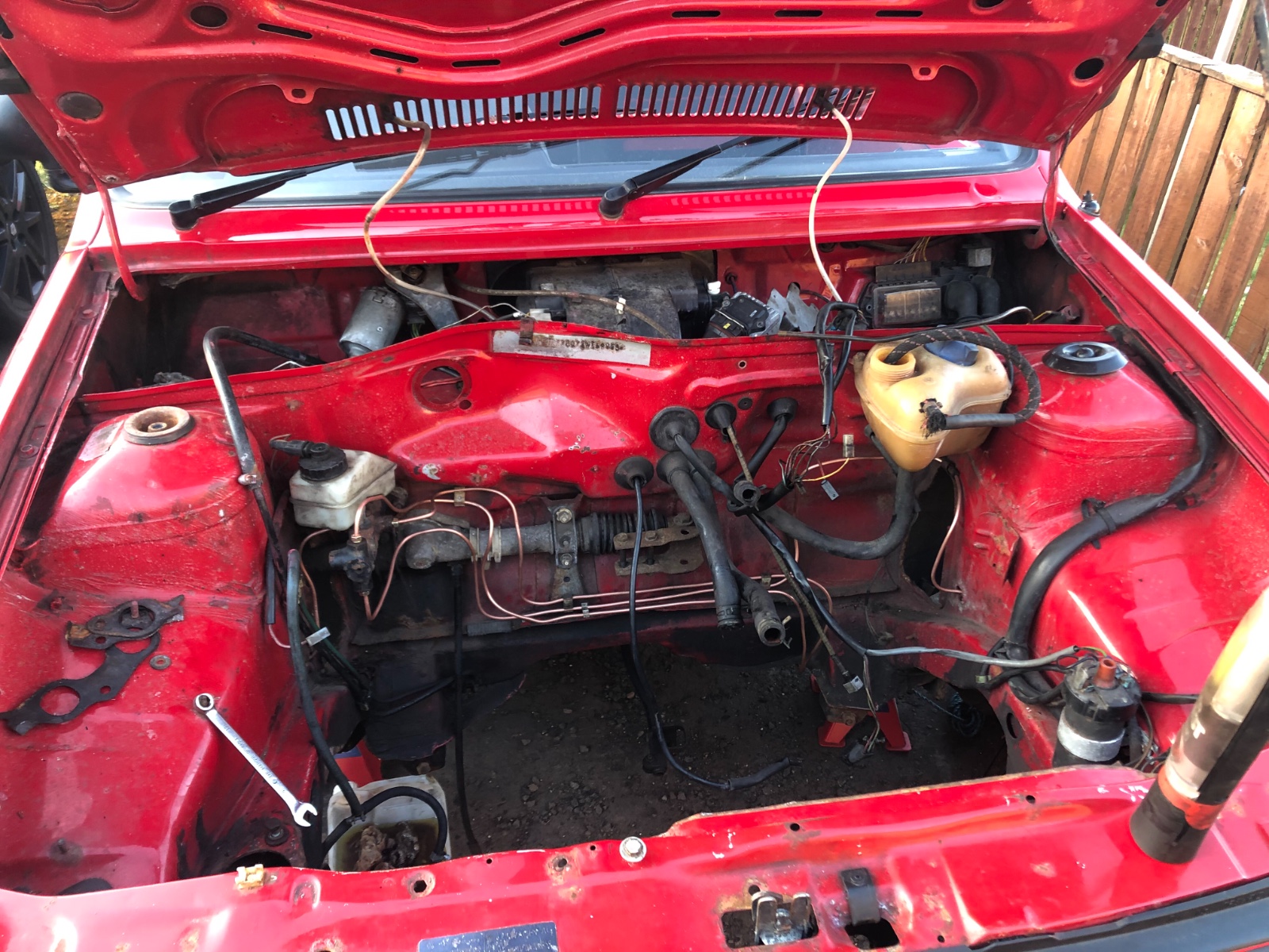

cleaned up engine and box and gave a quick lick of paint and then dropped it into the bay. 5A3BC0E1-D6C1-41D4-A27F-1619033D218C.thumb.jpeg.5bf7c729261962971dd82ab3571d9315.jpeg
Need to tidy up the messy wiring but the main bit is done !

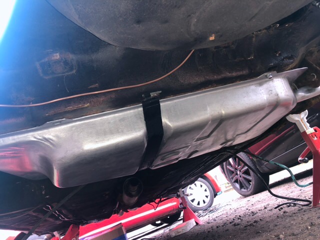

Fitted the mk3 injection fuel tank and then
I took the live wire from fuel pump relay and ran a cable to the intank pump and then to the high pressure pump to power them up.

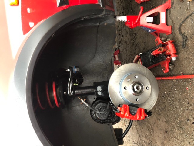

I sent my struts away to get powered coated and then once they got back fitted new bearings, hubs, bilstein shocks and super sport lowing springs.
