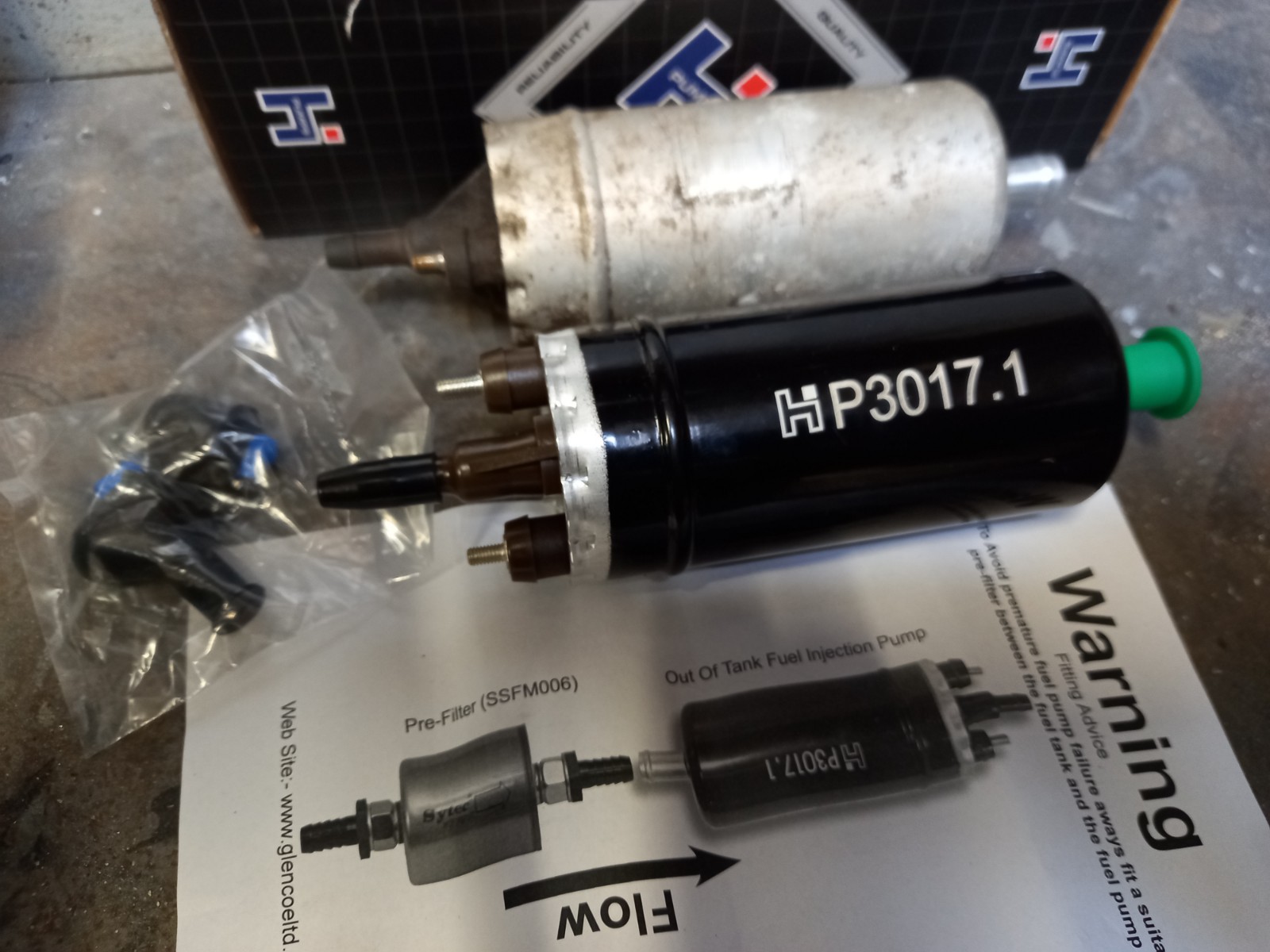

My new 3 bar  pump came today from demon tweeks £55 delivered . The £25 silver one I removed as it failed after 3 years noisy service.
As you can see the new one looks similar apart from the black paint  etc.
New one came with diagram saying a pre filter must be used ?? But no need as one is on the pump in the tank ??
