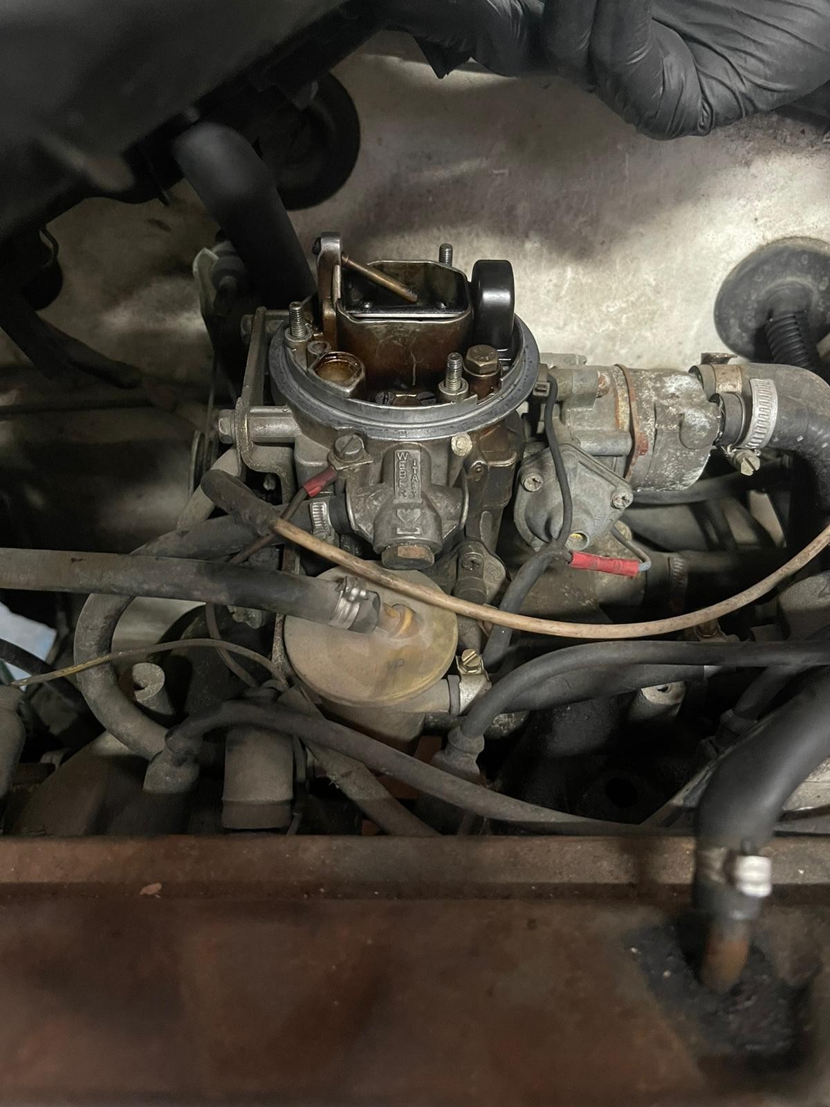

Or...take the air cleaner lid off and post a photo on this forum of the carburettor.  That will help identify the carb you have fitted(and likely the engine).

I'm actually in France as is the car. :) The car's at the garage. I'll go take some pictures and post them.

Here is a photo of the carb. Are you able to identify it? It's a Pierburg/Weber I take it?

Have a close look at your photo, especially where Weber Italy is written on it, and perhaps conclude that it probably isn't a Pierburg.
haha ok I thought Weber and Pierburg were the same thing as I've seen them quoted together. Which insulator block do I need then?
Link 1  Link 2  Link 3  Link 4
That’s a Weber 32TLA so you need the equivalent of VAG part 030129765C.
link 4.
Edited by mk2tastic
OK that's lucky the Weber and Pierburg use the same insulator block it seems!
Edited by chatlourd
