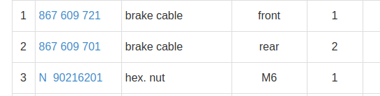

mk2f front hand brake cable advice - 867609721
I need to replace the front hand brake cable (as opposed to the rear left / right)
How do I do it?
Any top tips?
And could someone confirm this is the right part no: 867609721
Much appreciated

If you're ordering parts off the reg number, make sure you get the parts for a 1986-onwards car.

I recently purchased  a QH brand one for my 89 MK2 from eBay for £5, part no BC2236

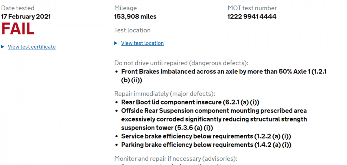

Neverthless it failed it's MOT...
Garage said it's all a symptom of rears not working well (like 30kg of force) - they were completely rebuilt 25k ago (5years) albeit car has stood for 6months.

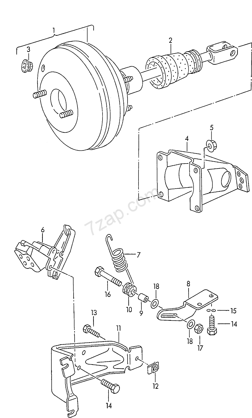

Should there be lots of play for the spring around item 10?
I can’t help you with the compensator i’m afraid, as my 89 Breadvan has neither the Servo or compensator fitted. However, I would have thought the spring should be under some tension, otherwise it’s pointless it being there.

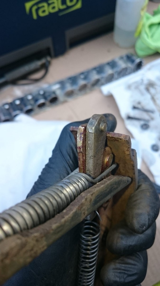

Would it be a sensible idea to paint the adjuster wedge?
This may stop it corroding and sticking in future.
I'm thinking using some really tough epoxy paint.
no dont paint it ...it relies on the small serrations on the edge to work properly
Thanks!
Just use a wire brush, or similar.As mentioned the operation of the adjuster relies on the serrations, so don’t do anything that might smooth them down.
They shouldn’t need any lubrication either, it just collects dust, as well as likely ending up on the brake shoe friction material.

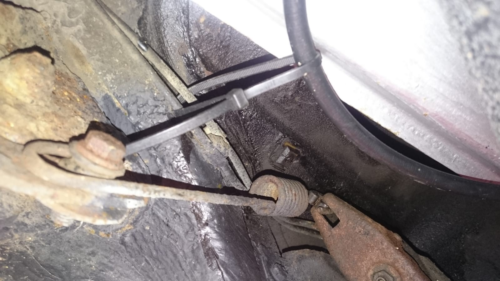

254844488_WhatsAppImage2021-02-26at12_03_44.thumb.jpeg.cbffc9caf1f7bae07c3fdf9cb254198a.jpeg
This spring seems to just slide up and down without any tension?
Which way do I adjust that bottom bolt to get more tension?
Note car is on axle stands with rear lifted on the axle - no dangling wheels.
