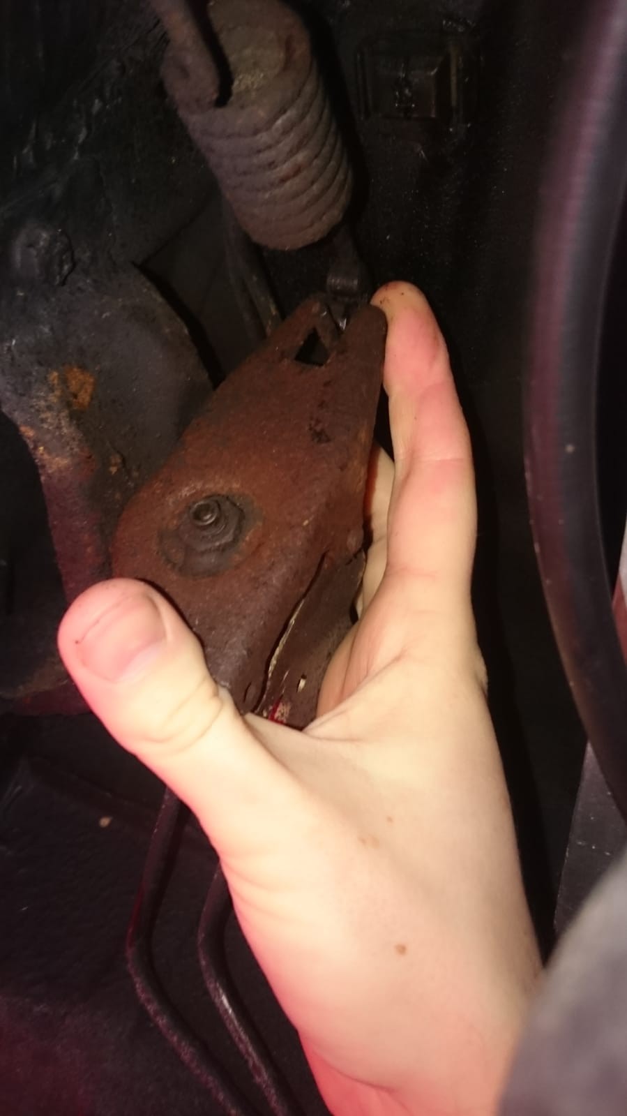

Seems to rotate back and forth ok, not sure which way is open and which way is closed.

  • ^ you can use a long screwdriver as a prybar to move the lever on the brake shoe enough to hook the cable in , no shoe removal needed , did mine last week

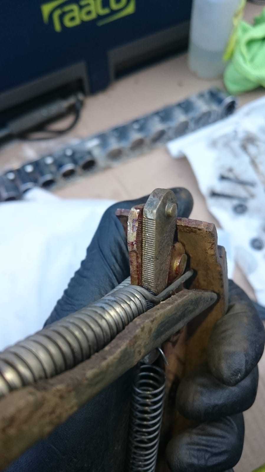

  • no dont paint it ...it relies on the small serrations on the edge to work properly

    Nice photo of cleaned adjuster wedge - showing all important micro serrations.

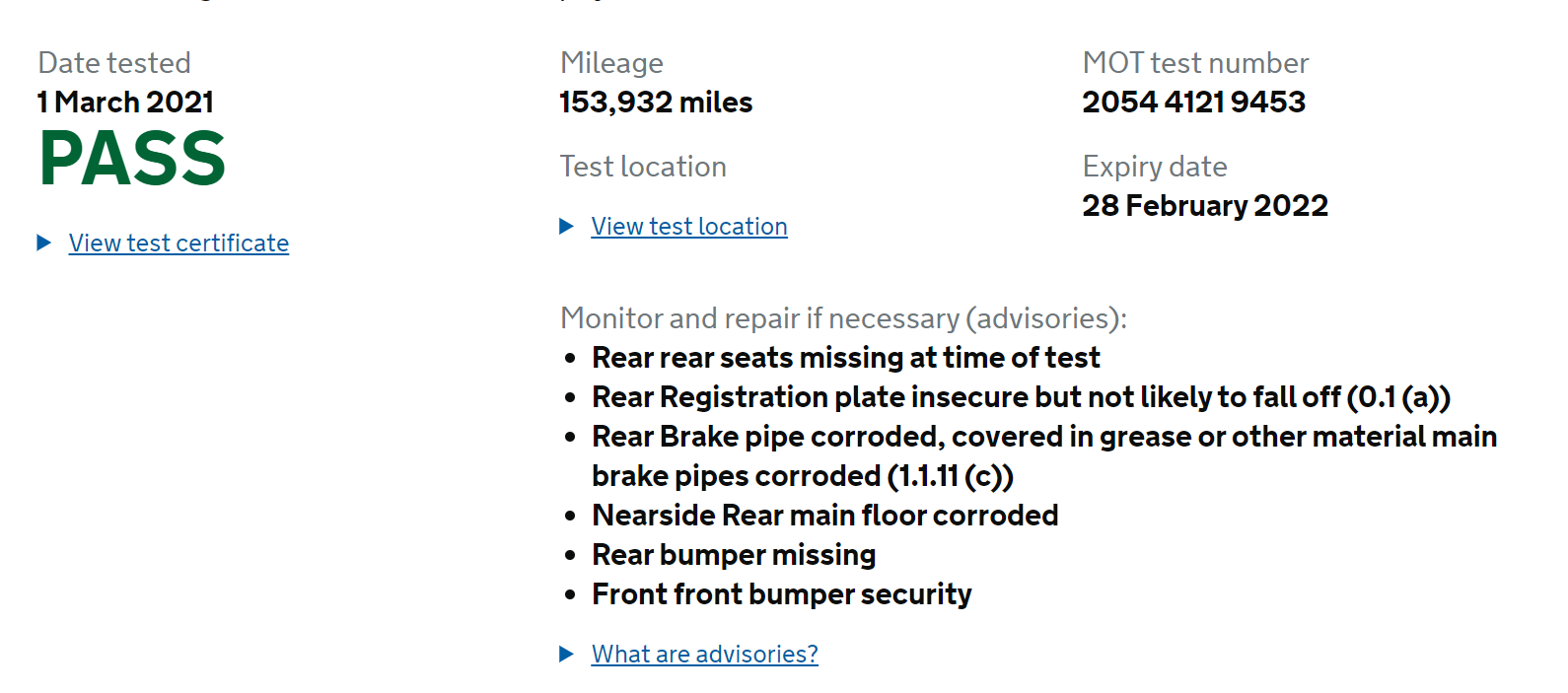

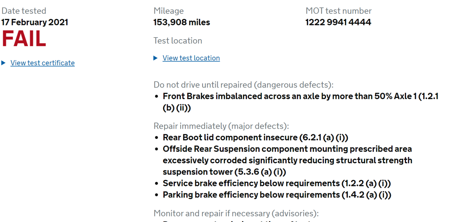

FAIL.thumb.PNG.7519ddcfad96760e1f84539eedd46443.PNGJust wanted to say thanks all - car passed mot.
In the end I did the following jobs with the help of a friend:
- Stripped and cleaned drum mechanism, in-particular ensured wedge was clean (citric acid to the rescue)
- Free'd up wheel cylinders, they were in good shape, but had gone a little sticky, rolled rubber back and cleaned up.
- Free'd up hand brake pivot - this was almost seized solid in the off position, lots of gt85 and wiggling required.
- Fitted new rear wheel bearings
- Fitted new discs (as one disc was distorted)
- Deglazed pads, shoes and drum
- Bleed brakes (they didn't really need it though)
The stats improved a lot - went from 60kg combined rear braking force to almost treble that of 170kg - all from mechanical skill and cleaning!
Which is approx. 17% braking so just above the 16% threshold needed to pass mot!
I imagine that figure will improve as the brakes bed in more and more.
