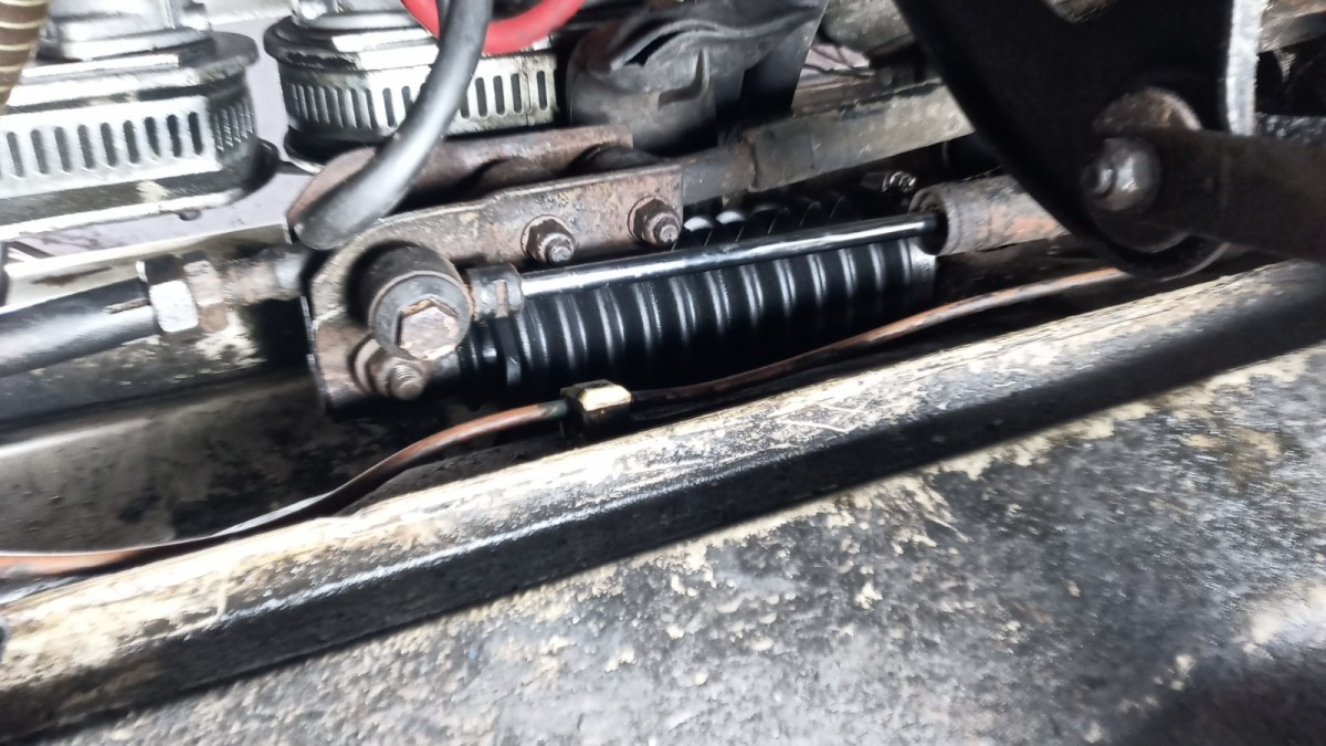

Steering rack rubber bellows Mk2 in-situ replacement
A few sites say the steering bellows on the rack is a 861 419 831 B.
Duly ordered a Febi 03319. Already had some CV joint grease and some jubilee clips.
I've got limited access from above (twin carb air filters), but with steering in the right position the bolt of the stirrup is accessible.
Disconnected battery earth as near starter motor terminal with a spanner.
The nut can be accessed and a spanner wedged so you can loosen from above.
Access from below is also awkward with the Stab-o-shock steering stabiliser on my GK.
With car on axle stands and you position from below by pushing a front wheel to point in or out. Removing old split bellows was easy.
Could I make the wide end fit over the rack?
Tried wire, cable ties, improvised plastic tube, 2 chopsticks.
Left the bellows stretched over my largest socket for a week.
Dunked it in boiling water, dried with kitchen towel (because it's gonna be filled with CV grease once on) and still could not get it and a jubilee clip (or even a cable tie)
to fit.
Changed from the Febi 03319 to a Febi 08498.
It's got a wider large end and a sleeve at narrow end.
There are clips with it but both seemed too large or needed special tools to fit with dire warnings of damage to rubber.

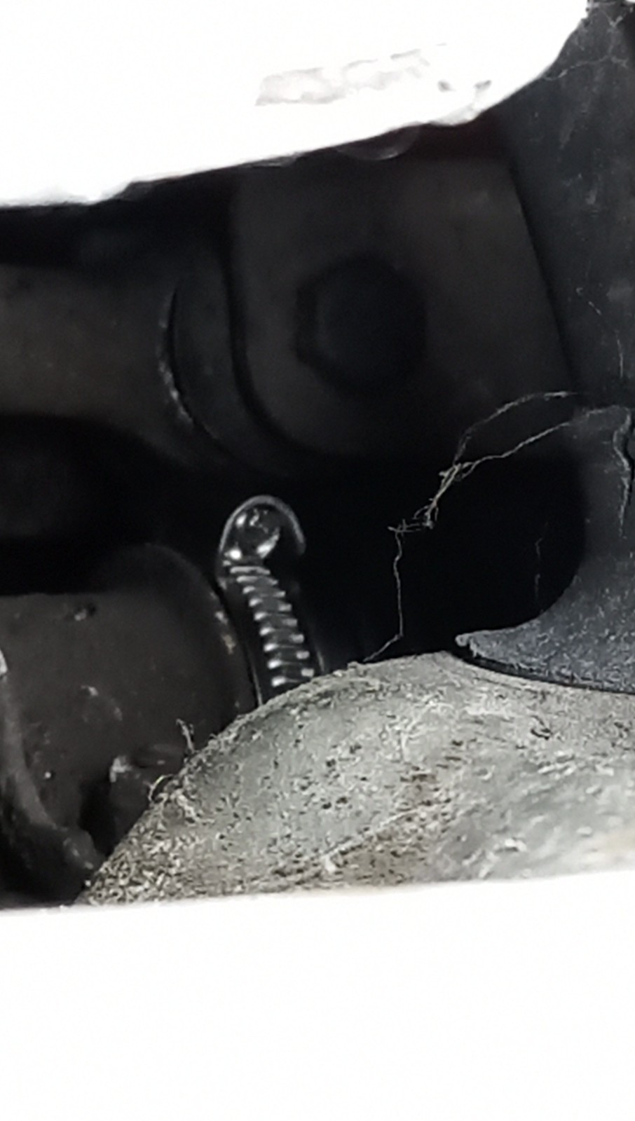

Bit of jubilee clip sizing so the fat end of the tube pokes through, steering rack to fully retracted and it pushed on in 15 seconds.
Tighten clip from below.
Use a chopstick, or old screwdriver to smear CV joint grease inside the bellows
(sometimes this is in the kit).
Turn rack to halfway out using steering wheel as control arms not connected.
Clean the pack where it emerges. Push the other end on over the groove, tighten cable tie into the groove.
Squeeze the bellows to move grease onto the rack and look that none comes out.
Rack back to part retracted. Remount stirrup, lifting and twisting until the bolt with a washer will slide through.
Should use a new locking nut. I didn't have one the right size.
Did up old one really tight. There's enough thread to put another nut against it with some thread-lock.
I need to check I can get full lock both ways. That jubilee clip adjuster might be in the way of full travel.
But anyway a 03319 was no good for me
I suggest using an 08498.

I can turn full lock left and right. The Jubilee clip adjuster is close, but not in the way.
