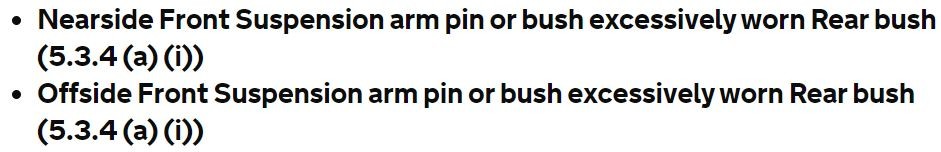

Hi all,
I wanted to see if I could get some advice on my 9n polo Front Suspension Rear bush replacement. I'm looking to carry out the repairs myself but wanted to ask if I would need to take the car in for a wheel alignment once the repairs are complete? And if anyone has done a Front Suspension Rear bush replacement before and had any tips or things to avoid that they'd be willing to share?

It's the wishbone bush that needs replacing and this is the OEM: 1K0407183E. I planned to remove and replace the front lower ball joint nuts and the bolt holding in the control arm, I would be removing the control arm so I could remove and replace the bush whilst its still on the car, so I guess I will need an alignment after all.
I don't know if they've been done before unfortunately. The mileage on the car is 76k, its my first car and I only just got it in September, but it seems to be plagued with problems and its a real shame as I've grown to like the car in the short time I've had it so far.
