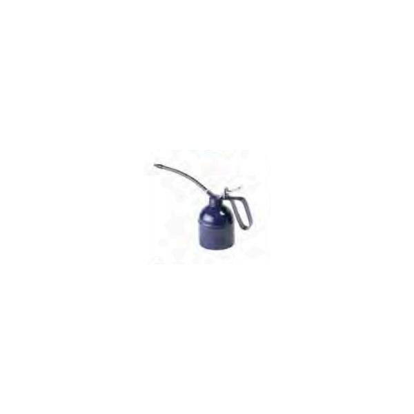

A squirt as in from an oil can, which is what I use.
It’ll only be few ML, so yes I suppose a small amount using the cap of your oil bottle to measure would suffice, anymore and it’ll smoke like you’ve put diesel in it, once you restart the engine🙂
Flexible tube on a small can ( or tube on end of a tiny funnel) or it's too easy to miss the sparkplug hole when pouring.
