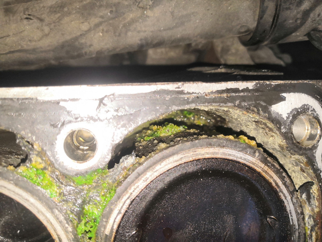

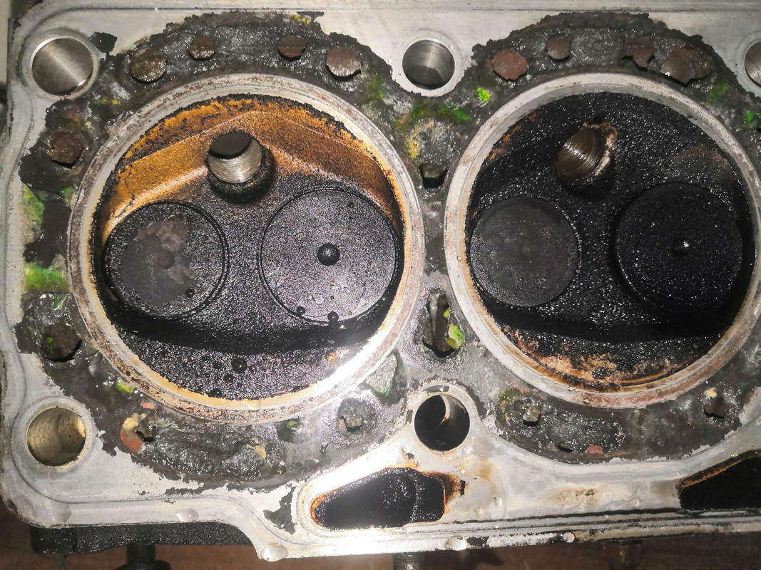

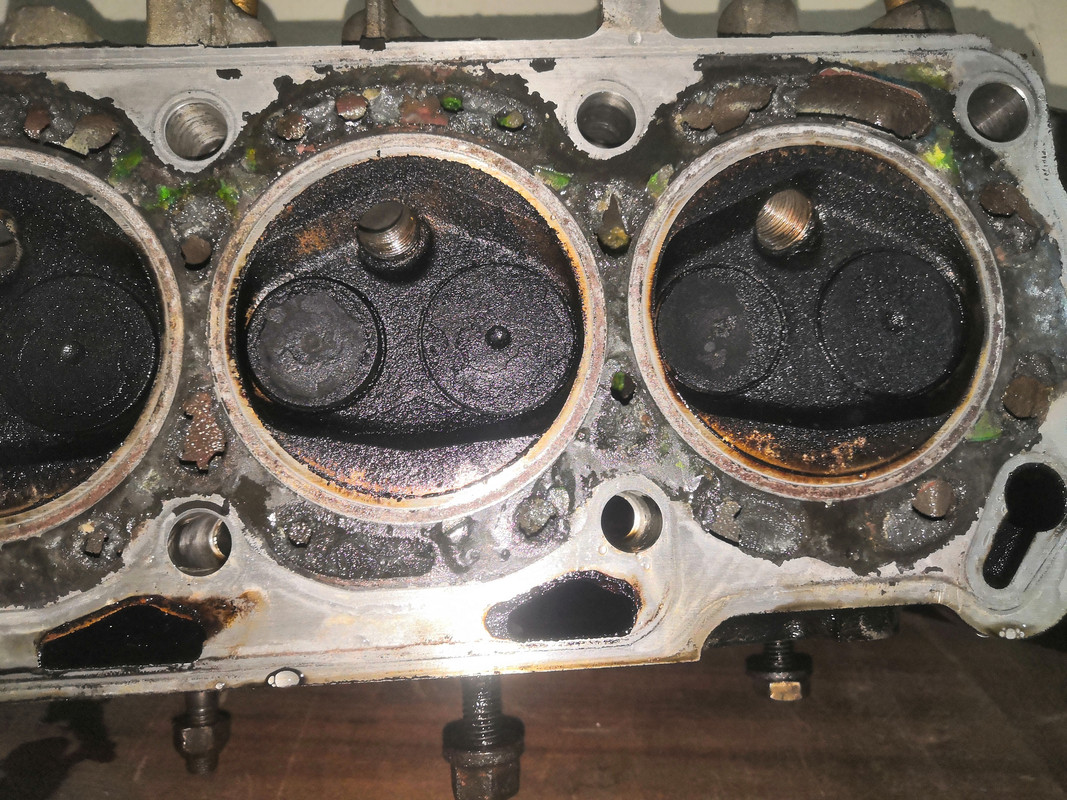

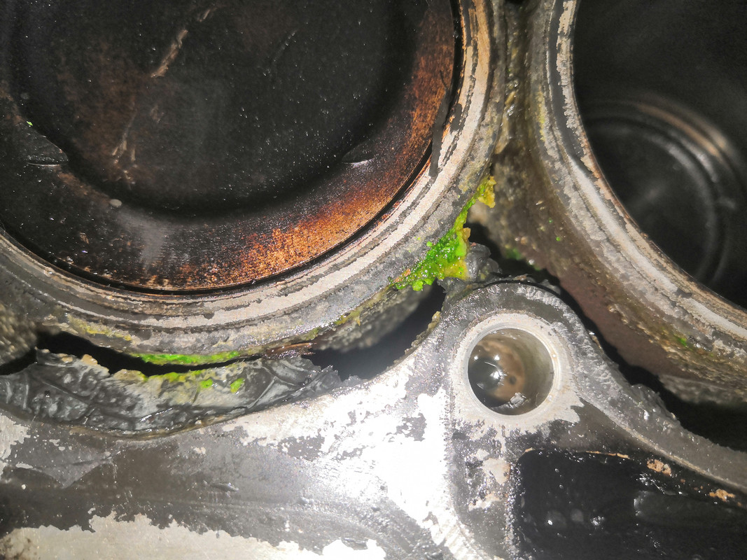

so no luck finding an engine localy with warranty so in the meantime i just pulled the head off to see whats inside.
i dont know if the black silicone is part of the head gasket or not but its 2 layer metal gasket with about 0.6mm thickness.
Gasket is 0.6mm now. Probably started life as 0.9mm.
Is that orange rust on the piston crown?
That surely means water has entered the combustion chamber.
Maybe stored in damp with no sparkplug?
Or coolant had some crappy miracle additive added to reduce / stop leak and it blocked the thermostat too (guess).
Scrape the old gasket off the head and check whether it is warped ( a steel ruler edge and a torch?)
(or engineers' blue ink and plate glass)
If not warped you could get it skimmed. Are valve faces and seats in good condition?
tomorrow im gonna clean it. i was looking at the photos and just realized that it looks to be valve marks in the pistons or are they like that?
dont know if it rust or not but doesent come off scrubing with fingers but the head in that piston also has different color from the others.
looking at the block im pretty sure i know what coolant the previous owner used as i used one that had the same color and was very corrosive on ruber and alluminium.
removing the thermostat is kinda of a common practice in Portugal because most people dont want to spend 5 or 10 € on a new one just because the car still runs "fine" without one
at one time some coolant were unable to mix with others , it turned to gel , never seen it myself but maybe suggests that happened , radiator and heater matrix probably ruined too

Yes, that looks like piston/valve contact, not valve cutouts.
One or more valves may be bent. Are they seated well in their holes if you remove camshaft?
Get a valve spring compressor tool, squash the spring around a valve, release the collet (two halves of a cone) and take a valve out. Put it in a drill chuck and spin it. You'll see if it is bent.
Replace collet halves using grease or small magnet when reassemble.
