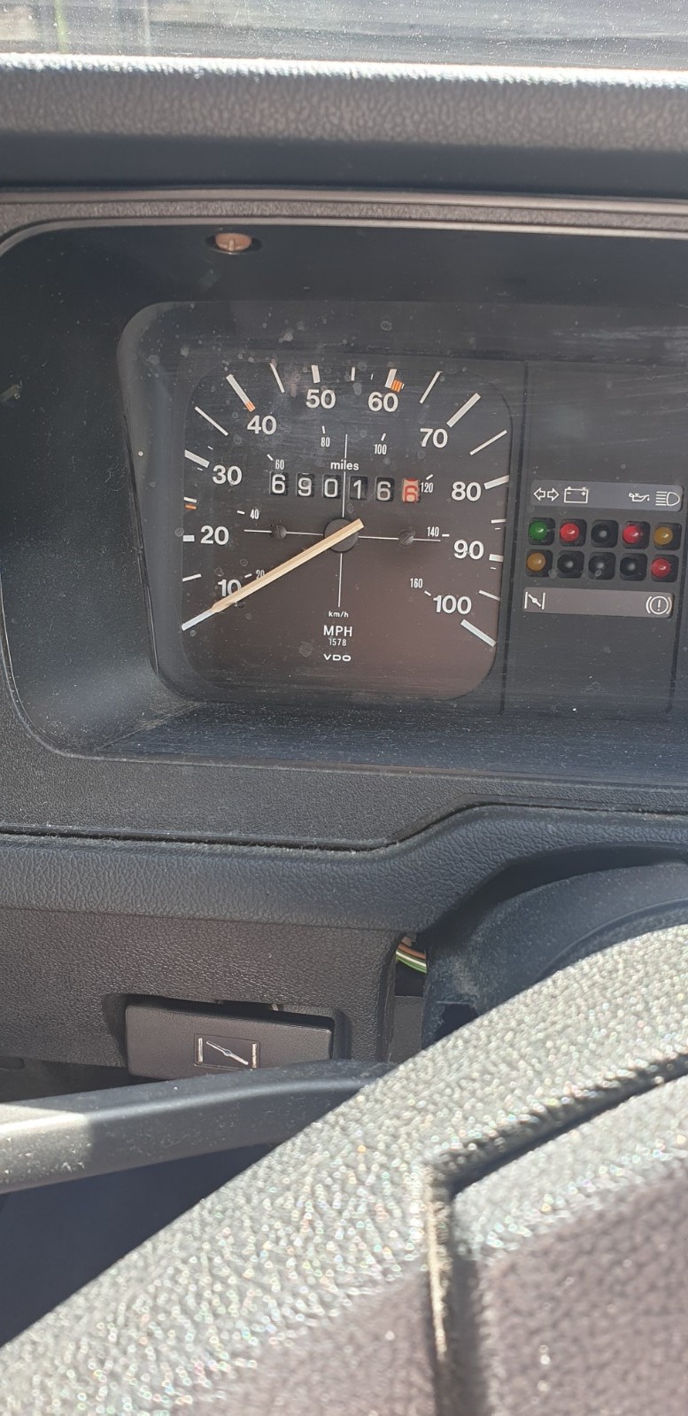

This is what is on the clock. That doesn't seem like very much considering it was registered in 1983!

VW clearly did not expect the car to do more than 99999.9 miles. :grin:
Or it saved VDO a few pennies to have one less digit per speedo.
I wonder how many times it has gone round.
Most cars do about 8000 per year so could be 269,016?
You'll have to find any receipts with miles on to spot the rock around the clock events.

I'd forgotten those I II III markings on the speedo for gear maximums when there's no rev counter.

I have a fair few mot certificates so may be able to work out when it ticked over.
