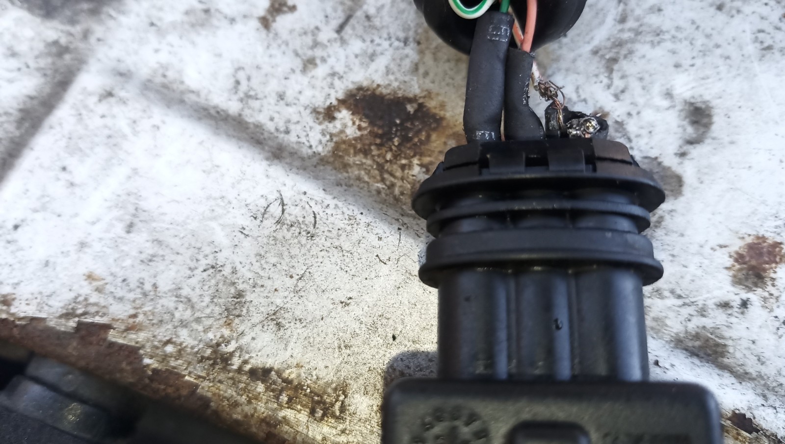

Found the cause.
About 1.5 miles from home.
The Hall sender connector.
Heatshrink sleeve is damaged and crimp solder connection is really poor.
you can get  new crimps for those
Vehicle Wiring Products part 192175 female terminal.
cable seal 0.5 to 1mm 192177
