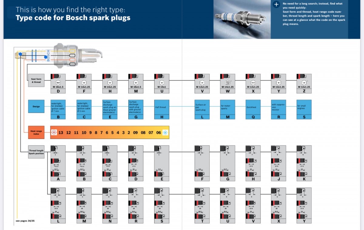

I use Bosch Super-4 (4 ground electrode) plugs in my 89 HZ, and have done for many years. I found them to give better responsiveness and smoother running.
Bosch Ref is WR78 and I’ve just put a new set in last week as part of a service. The old ones had covered 20k miles without problem.
W= M14x1.25 thread size
R= With Suppression Resistor
78= 7 to 8 Heat range, which is the just to the warmer side of mid range.
