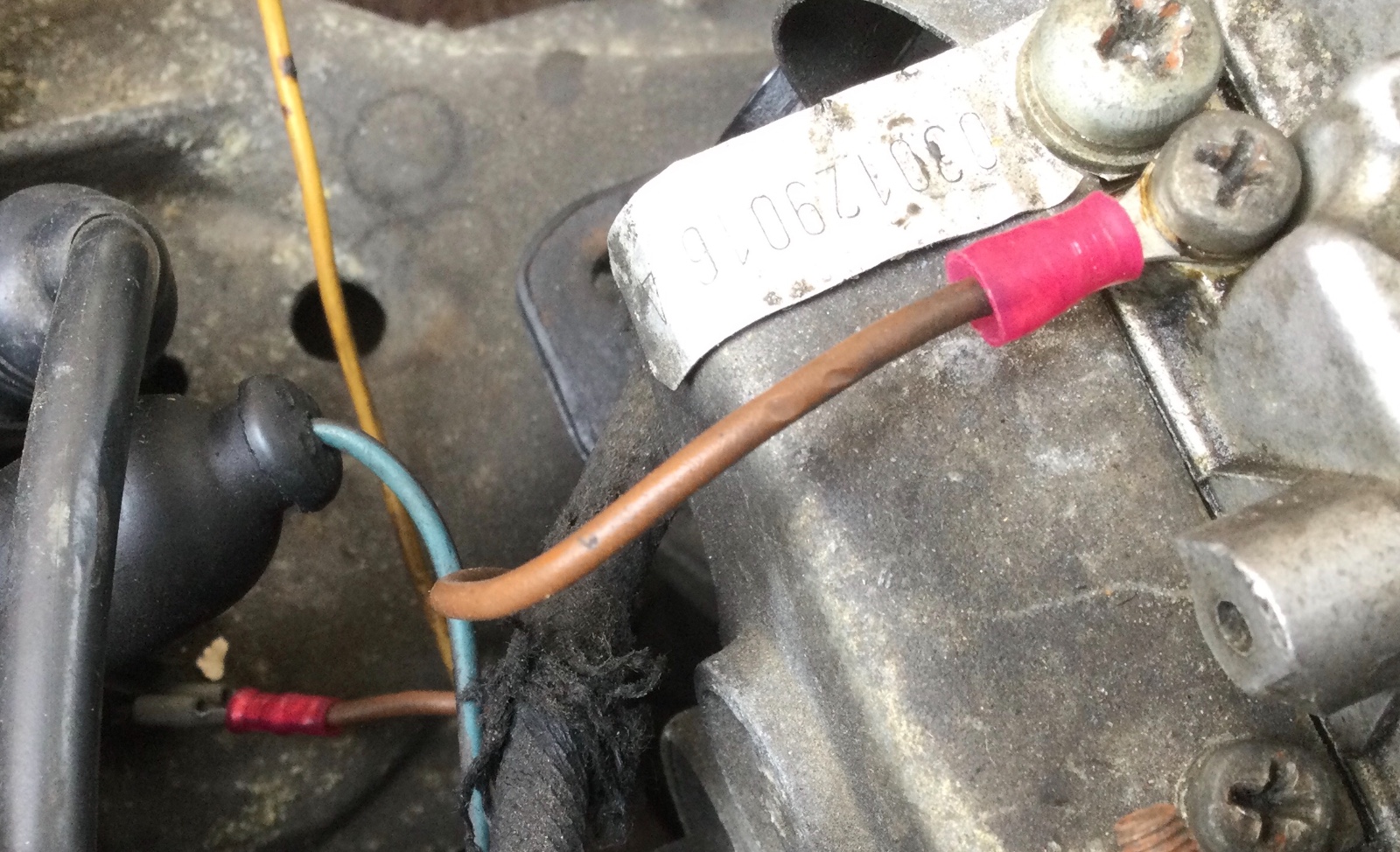

Well after my failure yesterday with no idle and rough running, it turned out not to be the Carb flange after all!
The brown wire that runs from the carb to the engine block for the carb earth had come adrift, so my idle cut off valve wasn’t operating!
 I ended up re-crimping the ends as the wire was about to break anyway, plus it was slack on the block end connector.
Still think I’ve got a very slight leak from the flange, but I’m hanging on as long as possible before replacing the genuine one with a potentially poor quality replacement..

If a Pierburg 1B3, the throttle body heater would also not have been heating the part channel for better fuel vapourisation.

The number of times a running condition has been down to a shoddy or missing earth. Sometimes I feel like Polo engines are just a collection of earth straps, the internal combustion is a secondary extravagance
