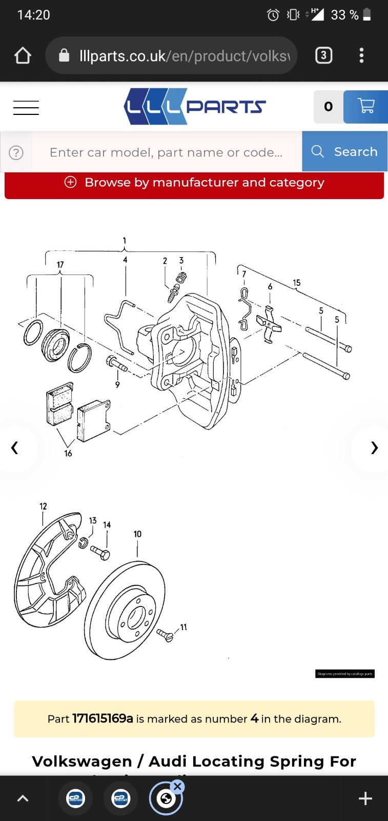

I am so frustrated, why can't I find an identical spring on the internet! Is this part that rare?
The calipers are basically a superseded part. I might have a pair in a drawer somewhere, will see what I can do....
What about this one
Hi thanks for help i solved it!
