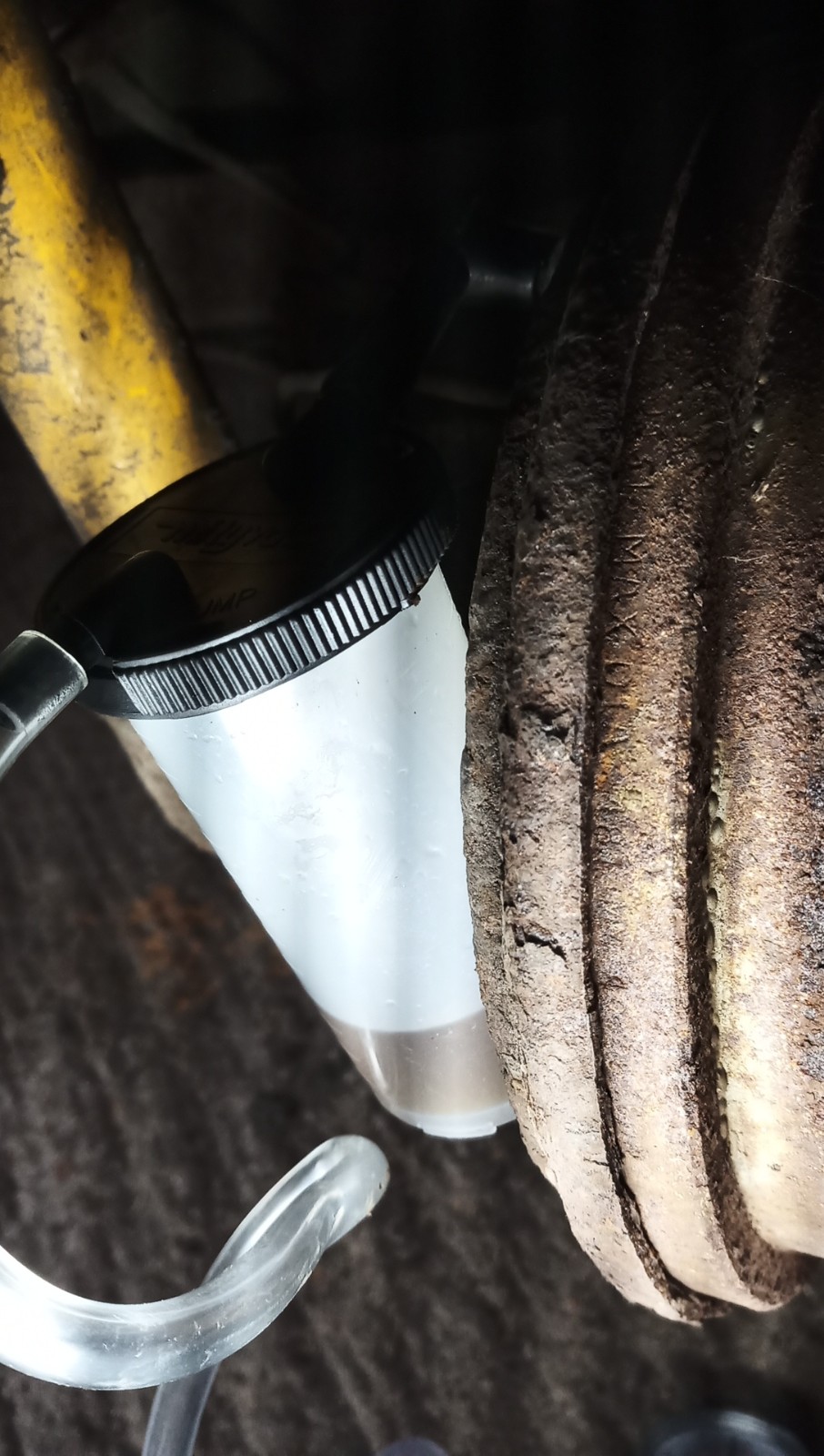

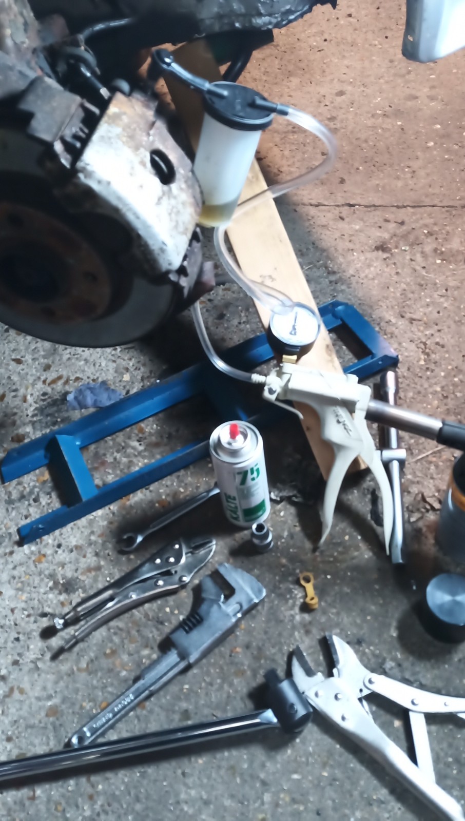

Got front loose with heat, cold spray, T-bar and 9mm socket hammered on, then 24inch breaker and mole grips with a 2.5mm drill bit in the hole.
And the Mityvac bleeded it.
...and managed the rears.  After a week of soaking in tissue impregnated PlusGas beneath clingfilm, were a doddle with a 7mm closed spanner (12 pointed, because that's what I had).
