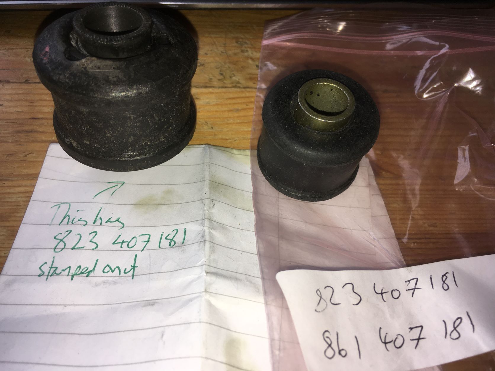

Parts arrive, and the supposed 861- part, the genuine VW one, looks exactly as per the picture from the supplier but on the rubber bush itself is stamped the 823- number.
The supposed 823- part is smaller in both length and diameter, has no markings on it, and came in a bag that had BOTH part numbers on it.
Now clearly, these two parts are not interchangeable, and I'm confused.  I think there's no way the smaller one could fit, but I can't tell for sure without taking the control arm off and removing (destroying) the old bushes = bad idea.  The smaller one also looks less domed than it's online advert pic, so I'm not sure if it's been picked, or advertised, correctly.  In addition, one of the big bushes has a chunk of its metal knurling missing, the casting or machining is defective enough to "tilt" the bush a few degrees which sounds like a bad idea for suspension components.  So I'm probably going to have to return at least some of the parts.

i would do whole arms ..often theyre q affordable and you get a new ball joint
trouble ive found is if the arms arent genuine then the cast hole for the bush doesnt match up the dimensions so you might not fit correct bushes into a aftermarket arm
Early (chrome bumper) MK1 had a different arm with a smaller bush in. As above, just change the whole arm .
Thanks guys.  New arms it is then; only a little more money than the bushes and a lot less effort.
