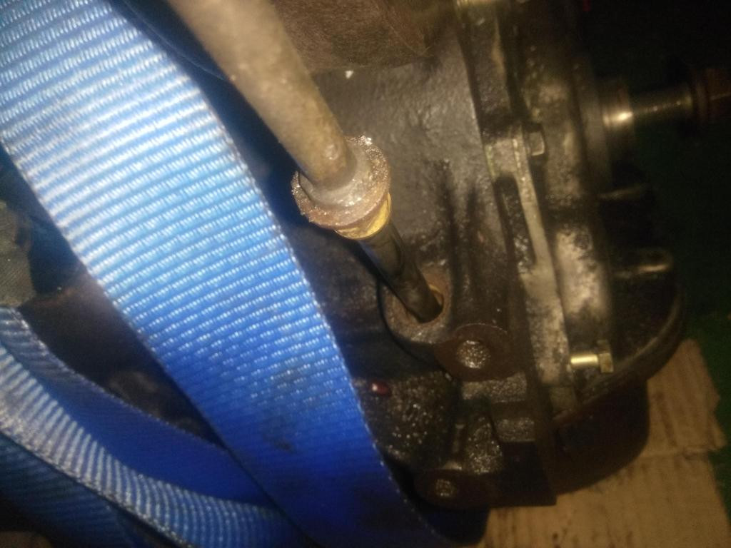

I want to remove the oil dipstick tube on 1.3 55hp engine (carb). It seems quite tight but I don't know if I should just pull it or turn it anti-clockwise before pulling or else. I don't want to break the tube since it's not easy to find.

I think Steve's words were autocorrected away from 'tight push-fit' to something less meaningful, by his phone, probably.
So pull hard; but a bit of twisting in any direction will probably help, as might a bit of penetrating fluid.

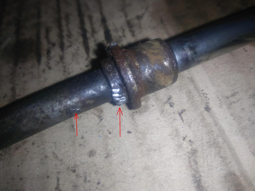

I tried as you said and successfully removed the oil dipstick tube. It was a bit stucked so I had to twist by turning it just a bit left/right several times so it could freely move. Then I pulled hard but very slowly and get it off.
I've asked the same on another forum but didn't get any answers. So I've already damaged the tube a bit using a plier because I thought it was screwed from inside or something like. That was before I decided to ask here. Hopefully I think I didn't broke the whole thing and I believe it is still in good condition.
I was a bit surprised that the dipstick doesn't exceed the bottom end of the tube (meaning the dipstick length is shorter or equal to the tube). I was expecting a small length of the dipstick to exceed a little on the tube bottom end. I don't know if this how it should be on this engine or not. I hope my English doesn't sound too bad to understand...
The damage is not a problem, but I have no idea if the relative lengths of dipstick and tube are normal. Could well be. Is there a part number anywhere on the dipstick?
