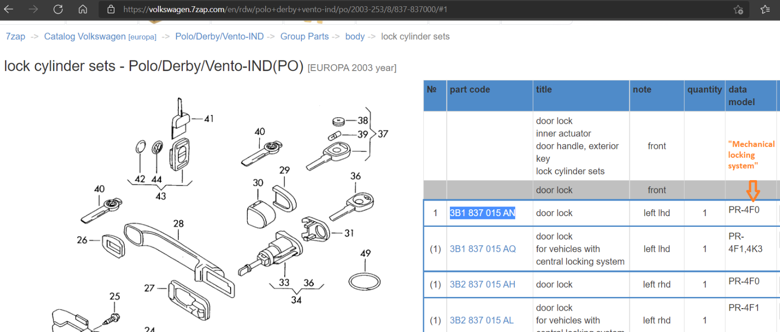

This car may never have been had central locking at all.  If you look in the parts catalogue, there is a version of door lock that is described by the PR code 4F0, which translates as "mechanical locking system".
If this is the case, you may find that build code listed on the sticker in the boot near the spare wheel.
If you don't see that code or the sticker is missing, another way of checking is by looking at the part of the door loom that goes through the inner metal panel towards the lock.  If it only has two wires rather than about 5 or 6, then it must be this type of un-motorised lock. The only electrical part of such locks is the microswitch that senses door open/closed.
I'm absolutely gutted. It's a basic spec car for sure, but that's it's this basic...
