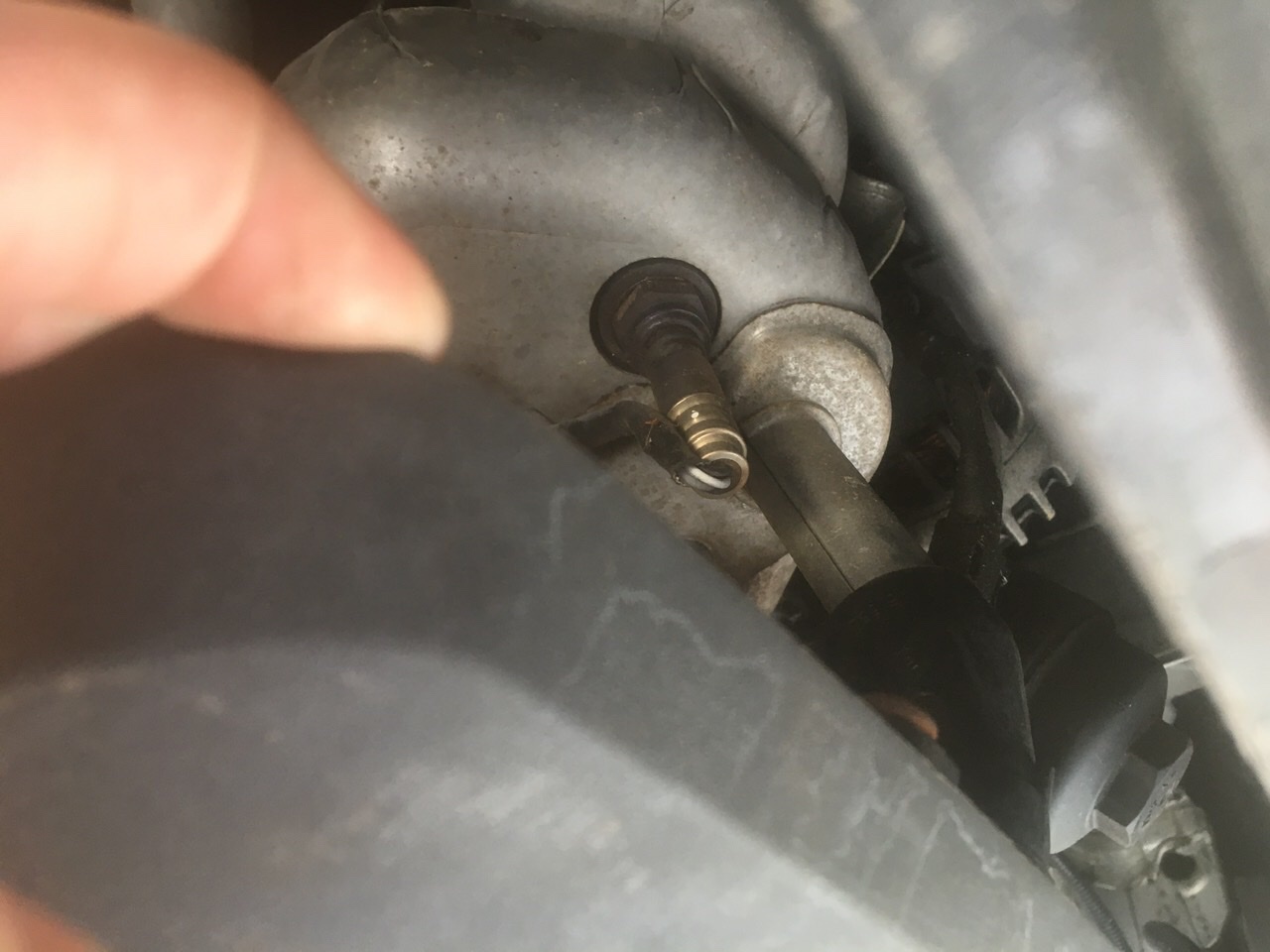

Pete mate I have a orange oil light keep showing up after I start the car. My uncle pulled the cover off the engine when he was looking for the servo hose. And the oil light was showing because he had not replaced it properly. I was just wondering should I have a rubber bit on the front metal pipe because there is none and if this is what probably causing it as the dipstick looks fine.

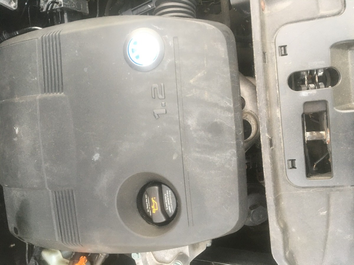

Yes mate orange light flashing for five seconds after it starts but when he had not put that on properly it was showing as red but now when I straighten that cover and put it down tight it is not flashing at all then after I have drive it’s showing up again hence me thinking there is a rubber missing because it does not sit tight in that front pipe
The engine cover looks to have just been slightly misaligned when refitted. There's a plastic tube coming vertically downwards at the front of the cover that's meant to slide over the outside of the metal tube coming up off the exhaust manifold shroud. Take it off again and refit with that correctly aligned, it's probably rattling as it is?

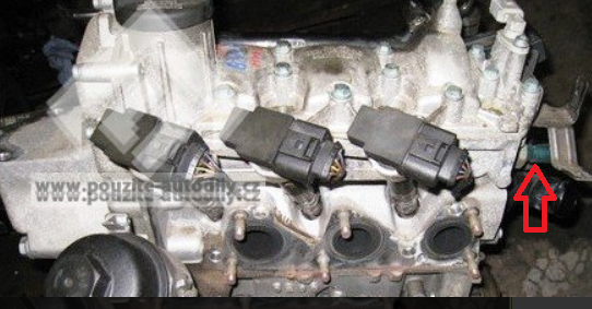

This is your oil pressure switch:

It’s not doing it when I straighten this cover and when I have drove I’m guessing the engine rattling is moving this cover so when I restart it it’s showing orange light flashing for a few seconds is there not suppose to be a rubber on the front metal pipe so it sits tightly.
Just saw a video of one removed and no rubber there so maybe I just top the oil up haha any ideas which best 5 30 or 5 40 mate
Make sure it fits so that slides over, and make sure the bit that fits over the throttle body further back is slipping down over that correctly.

Actually, maybe it isn't misaligned in your pic, there's a bit of a kink in the end of the black plastic tube, right?
Edited by Pete1
I don’t know what u mean mate the black plastic tube ? And I just not long bought it like a month ago with 12 month mot havent changed no oil. And I just topped it u with half a litre of 5 30 and the light was not showing then sure enough when I drove it home tried to start it it came on again got out banged the cover down straightened it and then it’s not showing
