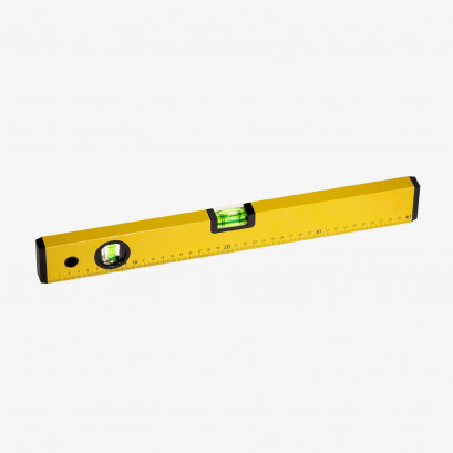

I haven't checked for flatness yet but I will. Unfortunately I don't have very precise tools like steel rule for such purpose so I will try to check the best I can with what I have. A feeler gauge and something like below (don't know the English word for it).

i think at least a good quality rule ...hold it against the head and shine a torch behind it ...if you see light its warped
if you never overheated it chances are its okay
Pro Art Stainless Steel Ruler 18 in. -- CreateForLess
