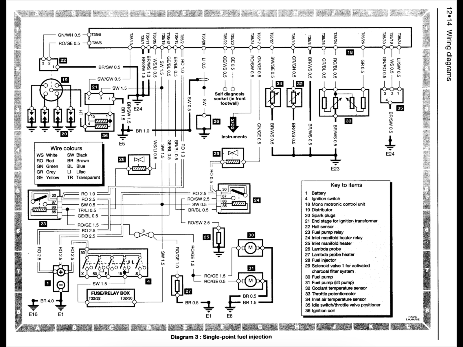

I concur with dvderlm that pulling a plug lead off is the best place to start. If you haven’t got a spare spark plug stick a round screwdriver into the plug lead and hold it close to a metal part of the engine, but not touching it. . Get someone to crank the engine, you should see a nice juicy spark jumping between the gap. If you do then chances are your ignition system is working.
If you don’t then that’s when it gets tricky. Hall senders in the distributor are prone to failing, so that’s one to be aware of. For proper diagnosis of the ignition system you’ll probably need a meter or a test lamp.
Other things to check are the king lead to the distributor. You can disconnect this and do the same trick as the plug lead to see if you get a spark before the distributor and from the coil. Check inside the distributor cap too, it has been known for the centre carbon electrode to disintegrate leading to loss of ignition.
It’s worth checking all wires are connected and not broken, which although rare can happen over time.
If you have a Haynes Manual that will be useful, if not here’s a diagram of the ignition system and fuel injection
