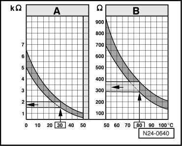

So now temps are a little less Baltic I've had the car out a bit more and done some testing.
Thermostat (OEM) removed and checked in saucepan with thermometer: no gaps visible when closed, opens at 84*C right on the money.  A slight lag on fully closing (80*C), but I'm happy with this.
Black sender removed and tested by measuring resistance when dipping the sensor head only into water.
T/*C     Ohms
20         1280
50          406
66          252
74          200
81          177
86          130
Couldn't test higher temps as the saucepan steam hurt my fingers holding the meter probes but you get the idea.  A spare sensor from a scrappy was tested too and was within 10%, which gives me some confidence.  Google has a few charts but its hard to pin down specific VW models to get a manufacturer spec.
I was able to remove the black sender's connector and test resistance after a drive, I got 170 Ohm but the gauge was showing around 65*C, which disagrees with my measurements.  Also I had the gauge stuck on 70*C but the thermostat had opened as the bottom hose was warm.  Fan comes on at about 90 on the gauge.
So I think its the gauge or maybe a bad connection somewhere else, instrument panel earth or voltage regulator fault.  The earth for the black sender's plug is good, I bleeped it out on the block.
I could bridge the sender's connector to check the gauge goes full swing, but am loathe to do this as I have previously blown a gauge with this method - it went all the way up then failed within about a second.
I could take the instrument panel out and check connections are clean, also the same for the gauge within the panel.
Where is the instrument panel earthing point, is it on the firewall inside the cabin under the dash?
Any way to test the voltage reg inside the panel?
Anything that can be tested within the gauge itself?
Any other suggestions?
Cheers
That's from the 6N manual so your figures are not that far away
