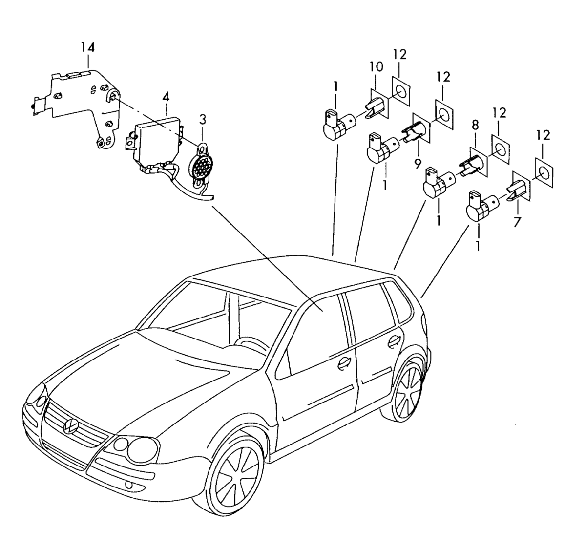

I haven’t found much on parking sensors, let alone OEM ones. I would like to do an OEM parking sensor refit.
From my search of google, I have found wiring diagrams and a couple of photo’s of what I believe to be OEM parking sensors.

Hello JASHAW30, I to have looked into this from what I have gathered so far kufatec do two harnesses that you can buy. These are oem and they I believe connect to a parking module you can buy from ebay or a breakers. 9n3 rear bumpers come prepped from the factory for parking sensors. So when you remove the rear bumpers there should already be markings for the sensors. Sensors themselves you can buy from somewhere like autodoc. I imagine the module would need to be vcds to the car so that the ecu recognises it. Apologies if this is stuff you already knew. Good luck 👍
